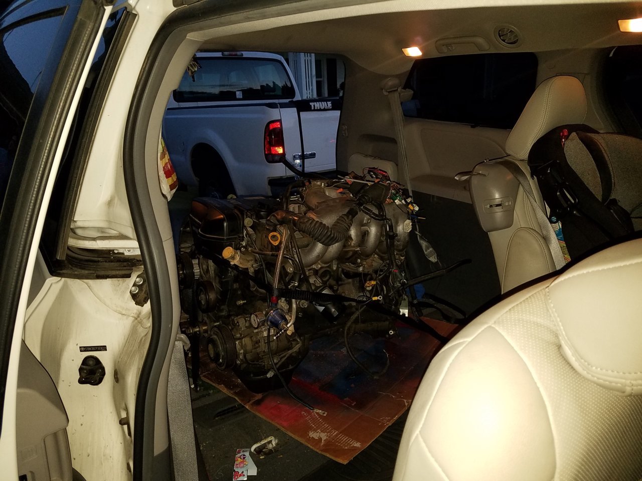

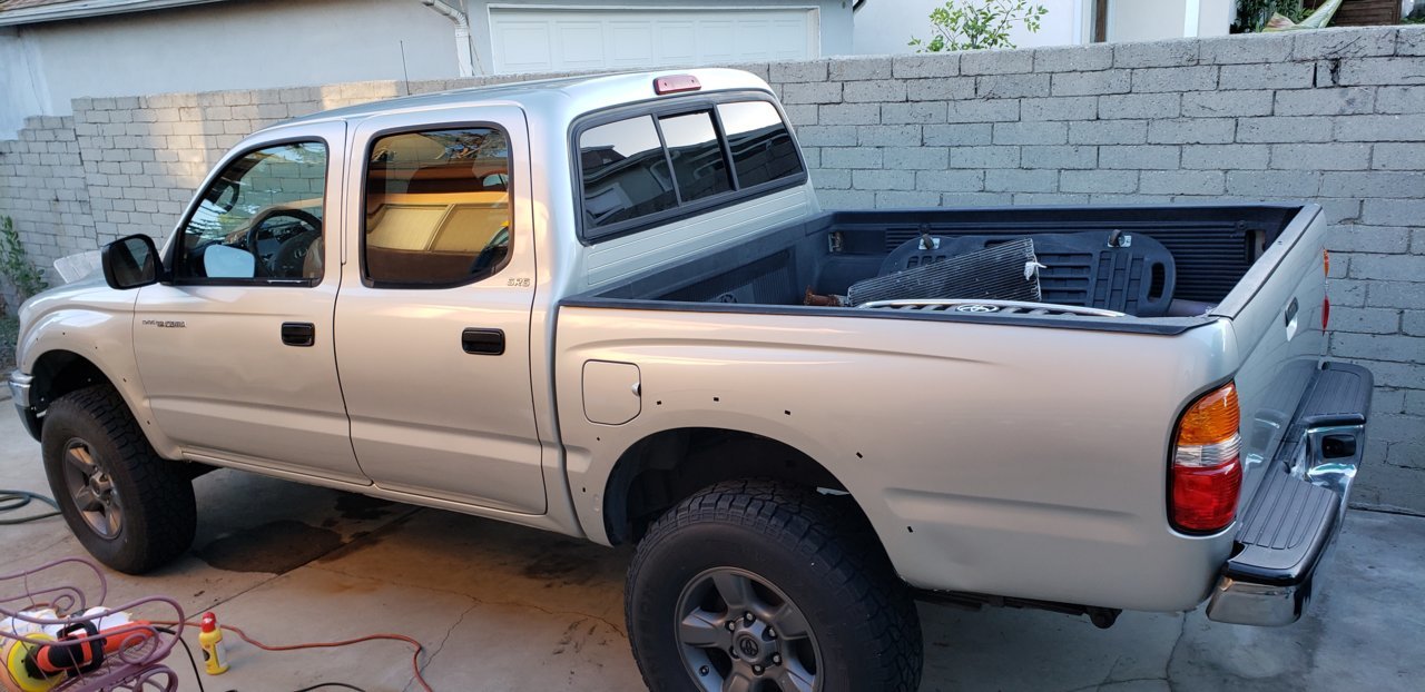

    I did a thing today.... 2jz Toyota Mini Van!
    Guy picked up the JDM 2jz that I had sitting forever. One of the coolest dudes I've met. He's going to be putting it in a super clean Toyota Cressida. We'll probably be in touch pretty close on the build because I am going to show him a bit of the wiring side of things, which sounds like the only thing he's a bit uncertain about.
    Going to be so cool to see his swap unravel!

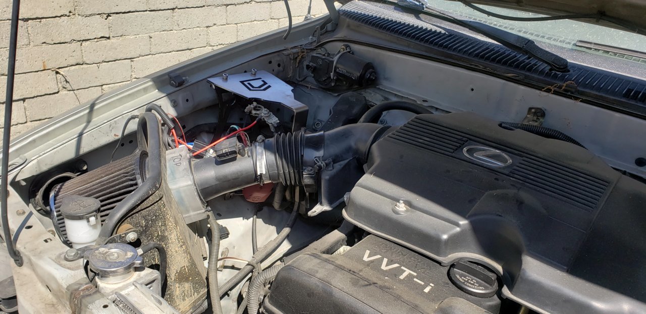

    Really got me excited taking a look at the 2jz Tacoma that's been sitting for a while now as I am nearly done building my regular cab. I'm so thrilled to have the regular cab more off road oriented and eventually have the 2jz Tacoma as a daily. I could technically take it right now to get BAR'd (I'm sure it's at least going to be a couple trips...), but I really really want to finish all the fine little details on it first and get her all wrapped up soon.

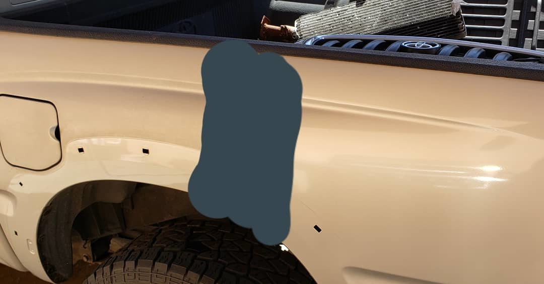

    Working on fixing up the paint today. Paint was never all that great on this truck. Cut and polished the bed and will do the rest of the cab tomorrow. Don't want to go wild as my buffing pad is picking a lot of junk up from the paint. Will save the serious detail for another day. But what a wold of difference!

    What kind of buffing wheel and compound are you using here? I have a buffer but don't really know what products I should use with it.
    I would love to try it out on my worn out paint. Planning a paint job towards the end of this summer so its not the end of the world if I accidentally cut through the clear anywhere. Just wanting to learn the ropes.

    I don't recall what I am using actually, I can check tomorrow if you really want. However, all the big name brands work just fine in my limited experience.
    From what I've gathered and experienced there are a few main things to know about. There is also a really good detailing thread somewhere, most likely stickied.
    Good wash first and foremost.
    • Clay bar to pull all the bugs and junk still stuck in your paint so it doesn't get buffed in and scratch more.
    • Compound is similar to using baking soda on the teeth...it is a very fine grit for cutting and smoothing the paint. Works amazing on oxidized paint that looks like it had been finished off with 1,000 grit sandpaper just from the sun eating it away.
    • Polish is more of a chemical step than anything else to finish it off.
    • Wax. I use synthetic (because of my other truck). It holds up to dirt and many washes substantially better than canuba wax in my experience.
    • Rotary/Orbital buffer made life waaaay easier. Could not have done this by hand.
    At the end of the day, a good wax is like good sunscreen for us whiteboys. Once the wax wears off the sun begins to cause the paint to become porous and is like a bad sunburn. Go many years too long and your paint will be burnt essentially.

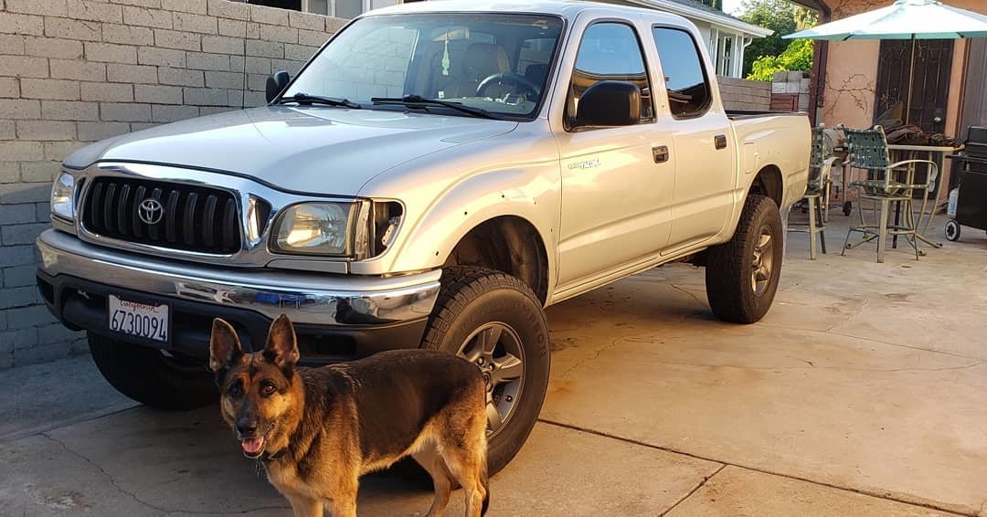

    Well guys...
    I have so much fun with my regular cab and between all the other projects I have going on, I am thinking about letting the 2jz truck go just because it is not practical to me. Looking for a better daily driver for my 80 mile daily commute to work.
    I am not expecting a bunch for it because it hasn't been officially made street legal yet. There are lots of little details that need to be done still, but it technically can be driven because it is all hooked up and ready to roll. I just drove it 20 feet in my backyard the other week haha.
    Located in San Gabriel if anyone is interested in this truck...make me an offer!
