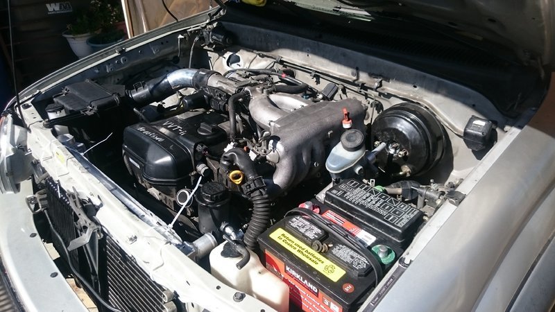

    UPDATE!! An IS300 brake booster and pedal assembly fit like it was made for it and clears the intake manifold. Test fitting the radiator and transmission cooler (hanging a bit low because of zip ties) and getting a ballpark idea of how I am going to mount them. The fans are hidden between the radiator and the A/C condenser which is kind of neat. I welded a AN-6 fitting onto the power steering high pressure output and return reservoir and used some stainless steel fittings along with high pressure black braided line and made my own power steering hoses. They look sick. Ignore the hacked up little boot on the intake. Will refine that later...

    How big is that radiator compared to the stock one?

    They're similar in size other than the aftermarket one being about half an inch thicker. What differs is that the aftermarket is of a crossflow design. The stocker is of a downflow construction (I believe...having a blank moment right now).

    Thank you! To be honest- obviously things don't just "fit" together with any kind of swap, but everything kind of meshes in together (if you will..) quite nicely. Even the factory airbox tubing almost lined up! Unfortunately not good enough to make it work though haha.

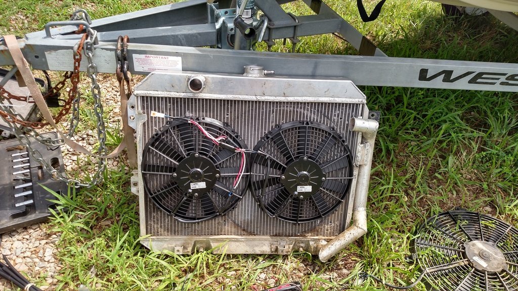

    So you are using a "custom" radiator and not one from a supra or the Lexus car that the new came from?
    I'm using a Champion Nissan 81-83 280zx radiator. Its pretty thick, but not very tall. I'd like to find one that was the same size as the original Tacoma radiator..
    Currently the 280zx radiator is working ok, unless I am trying to climb a long hill at slow speeds , or idling or slow speed with the AC on when it's really hot outside.
    Here is my set up w/ twin 11" spal slim line fans.

    Wow that is a crazy looking outlet on that radiator!!
    The thing is, the radiator I picked is only a bit thicker than stock. Dimensions HXL is about the same. I almost went with Spal but ended up going with the Summit Branded Fans. I think if I do run into heat problems that aren't overly bad then I'll most likely go with Spals and their slim line like you have.
    Do you have much space between your motor and the radiator or is it a tight squeeze as is with the current slim fan setup you have going on? One thing for me being an automatic, I went with an external transmission cooler just to get a tad bit more water volume and cooling surface on the radiator.

    There is zero room
    I have zero room between my current radiator and the pulleys. The fan pulley actually spins directly next to fan, has cut a small groove in one part if it. I really need a thinner, and taller radiator.
    The lower outlet was add to replace "frankenhose".. 3 pieces of hose, two couplers, and 6 hose clamps...
    I was running a single 13" fan, but it switched to the twin 11" fans for more fun coverage. You can see the outline of the 13" fan on the radiator.
    How long is the 2jz? The v8 sits right against the firewall. I knocked a little dent in the right side of the firewall to clear the top corner of the right head.
