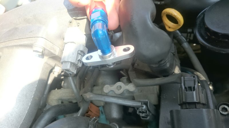

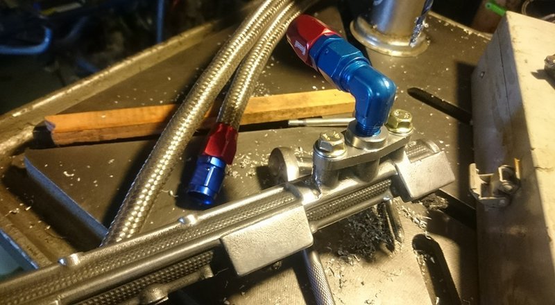

    Update to you after all this time because I now have an answer. Thought the thing on the rear side of the fuel rail was a regulator. No. It is a "fuel damper" from what I now understand. The Lexus has an in-tank fuel pressure regulator.

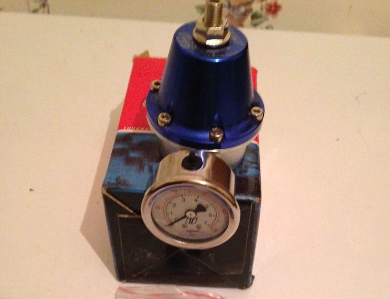

    Here in the picture I have the turbosmart fuel rail adapter. I do know there is a plug on the end of the fuel rail, but I'd prefer to do it this way. Drill a hole and tap threads to secure it. Adapts rail to 1/8 NPT to 90 degree -6 elbow. From that I will connect my turbosmart fuel pressure regulator which is still on its way in the mail (See pict I pulled from seller). Going this route because the Tacoma already is plumbed for a return system.
    One thing to take note of in California is that (as far as I know) you cannot have adjustable fuel pressure regulators. Definitely something that will be seen in the process of getting BAR'd. It'll hold me over for now though.

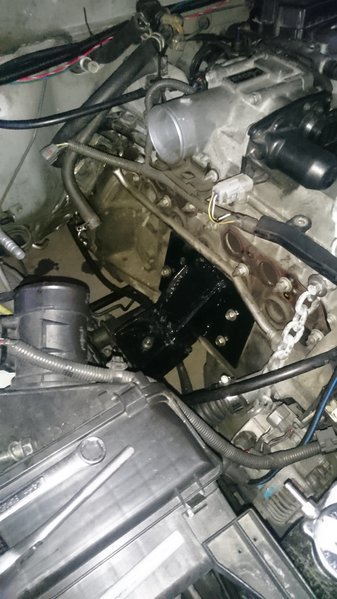

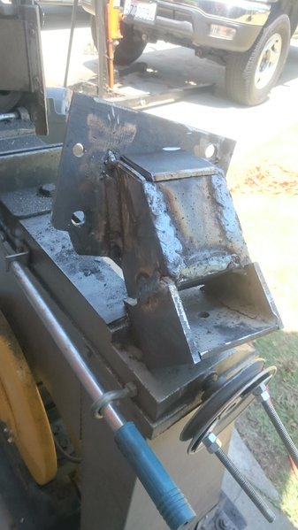

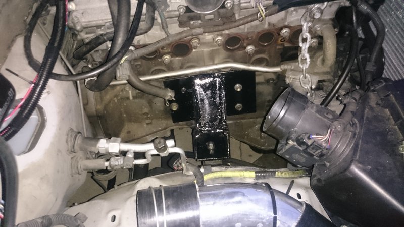

    Here are my sloppy but functional overbuilt booger-arc-welded motor brackets finished and in the works. Driver side and passenger. Still need to get a fourth bolt >.< I'll have to get a picture of the transmission one for you.

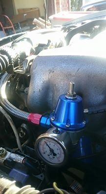

    Pictures from a couple days ago when I did this. Not entirely sure what the pressure should be at, but as of yesterday I now have it running at 45psi with no vacuum. At idle it drops down to low 30's.
    Made a huge difference. Motor was getting about 70psi prior to this.... Will let you guys know of some more stuff going on later this week. Made it from Pasadena to Temecula and back without issue this weekend.

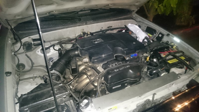

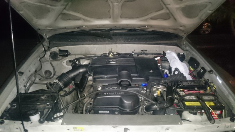

    Couple little things happened though. Tacoma box with Lexus air tube. Welded up an upper radiator "tube"... stuff like that. Nothing major. Engine cover is just sitting on top for picture purposes.
    One major thing I found is how to flash the check engine light. It is code 31, standing for air flow sensor. I had the Tacoma MAF originally, then got the Lexus one. Ran better with the Lexus mass airflow sensor, but still doing the same. Turns out I need the Japanese one. Found one online as no shops around here are willing to part with a JDM 2jz-ge maf. Think I found the right one but not sure. Unfortunately it was lost somewhere in transit to me and working on recovering it with USPS. Freaking sucks because I feel that is the one link stopping this car from running right.
    Number one goal after MAF is get A/C going again. After that is to relocate the battery to the passenger fender behind the air box. That'll allow me to put the ECU in the box it belongs in and locate it right behind the headlight where the battery currently sits.

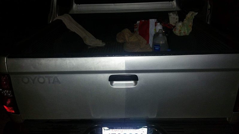

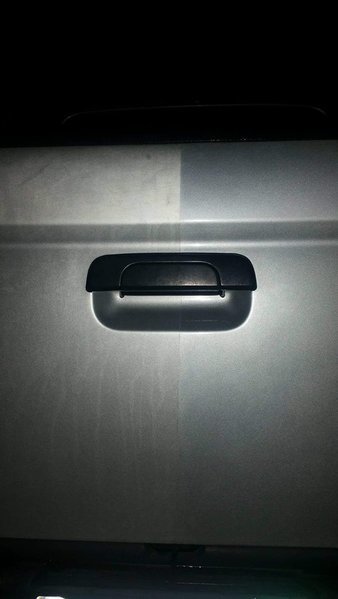

    Cosmetic update:
    Both sides are washed, but the paint looks terrible. Hit the one side a buffing compound and did a world of difference. Looks like I'll be doing the rest of the truck next weekend possibly I the time exists and throw a good coat of synthetic wax over it. I know with my white truck clear coat is mixed with the paint in one layer. On this truck, I believe you have a base coat and a top coat (forgot the technical terms for this). Her paint is pretty fugly though. Don't know how thick this clear coat is.
    She got all mad at me when I de-badged her tailgate as well. Emblem letters coming in the mail: 2JZ GE 3.0. Plan on painting them a soft metallic pink and putting them on the tailgate. Since her truck doesn't make the wooshing sounds the much more powerful turboed 2jz-gte does, I have to do this to let others know and plus it gives it like 10 more horsepower........ LOL
    I once did this to my white regular cab PreRunner because the top of it looked a bit chalky. When I walked out the next morning the truck was so white and bright that I had to shield my face walking towards it.

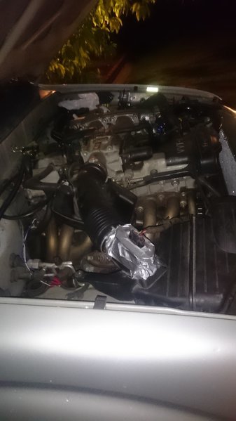

    @creech So you mean to tell me that you'd trust a guy cutting up a Lexus air box and duct taping a mass air flow sensor to it?
    Temporary setup for the past hour. Car now revves to the moon and doesn't stumble anymore! Doesn't smell like it's running super rich either. Just have to figure out what fuel pressure to "properly run" now. So stoked. Been waiting so long and finally nailed it on the head. Check engine light is off as well. This weekend will take the actual Tacoma air box, cut rectangular hole, make an adapter and properly install this correct MAF in there.

    Good but not so good update: Symptom- Rough...like almost stalling rough during idle. Everywhere else the motor runs like a fantastic.
    My theory- There is a toss up between a couple things on the air box. Some say that the air box tube diameter is 3" while other's say it is 2-3/4". I currently have the 3" tube. My theory is that I need a 2-3/4" air box because air is not flowing though the sensor with enough velocity, hence why anything above RPM runs fine until its cruising at really lower RPM where it begins to stumble a bit.
    The Lexus box I duct taped is 3" as is the Tacoma one too. I have a 2-3/4" aluminum tube that can be seen in my earlier pictures which I can cut a slot in and see what happens. Will keep you all posted with an update in a few more days.
    Super excited about this though. It was so awesome hearing the motor rev so high when I stepped on it and felt it give a good pull.
