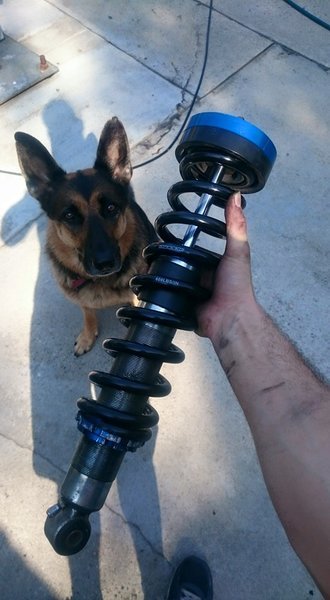

    It was the Fox shocks with the blue springs, which was BRUTAL! The springrate was something like 1,000 or 1,100 lbs from a Tundra. I got some dirt cheap 600 lb coils from iShock (over stock or something) which made it a million times better!!

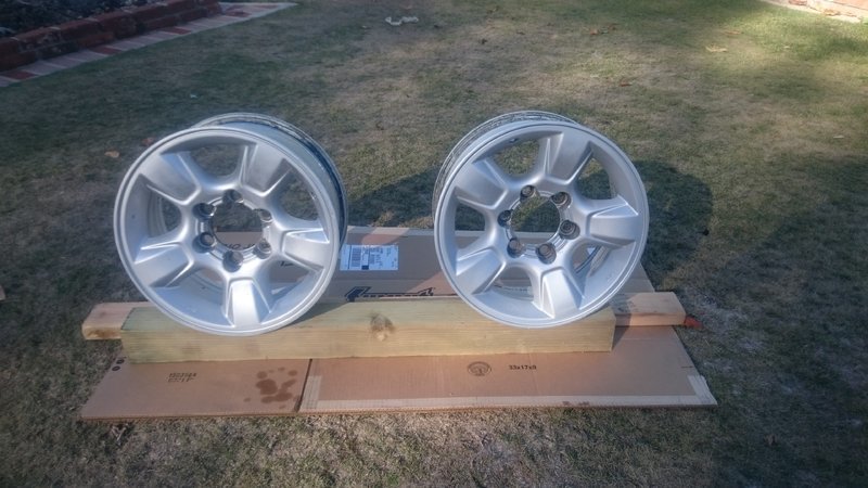

    Rims being painted today! Well....two of them. Will be finishing them off tomorrow with Satin clear coat. It's gunmetal with a hint of sparkle to it. I'll post some pictures when I am done. Just finishing up my coffee here.
    Hope everyone has enjoying the holidays and staying safe out there!

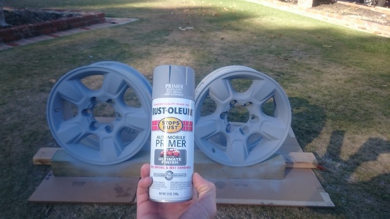

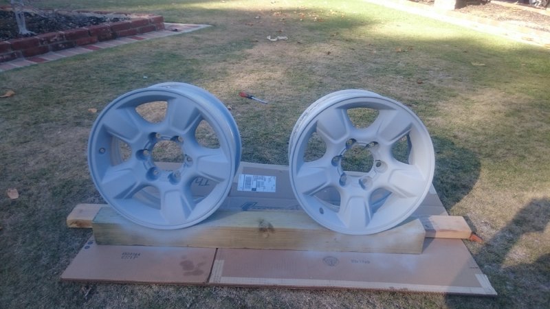

    Priming

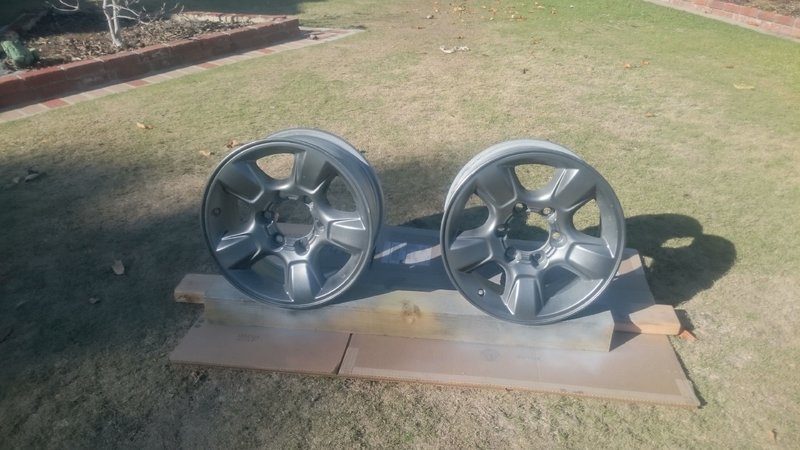

    Came out just as awesome as I was hoping they would!!! Still need clear coat but won't do that untill tomorrow. So stoked!
