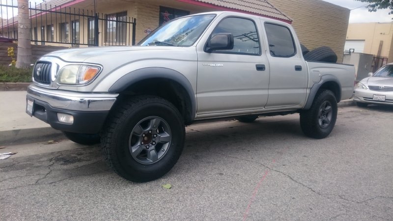

    Been super busy guys but finally got to doing this I apologize for not getting on here more often. Will get better lighting and truck clean for a better picture but here is a teaser with new rims and tires.

    Looks sweet! great work. Has it been to the referee yet?

    Thank you!
    No it has not as it is still on the JDM system. The usdm system will be happening pretty soon though. Now that I have an idea with what the heck I'm doing, when I do the usdm swap I'll be able to do it a bit nicer.
    I don't know much about the process of getting her legal here in California, so I will post up some of the processes I go through when that happens with the reff.

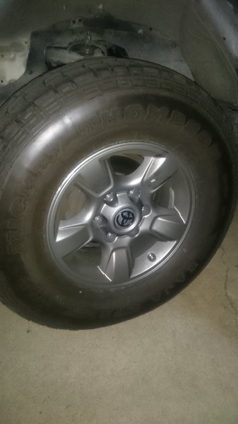

    Late night update... Got a center cap done and looks very good all put together now! 1/4 done. Of other things like switching over to USDM, which should come first, it looks like we'll be doing a Morimoto projector retrofit soon and also a Satoshi grill! Will keep you all updated.

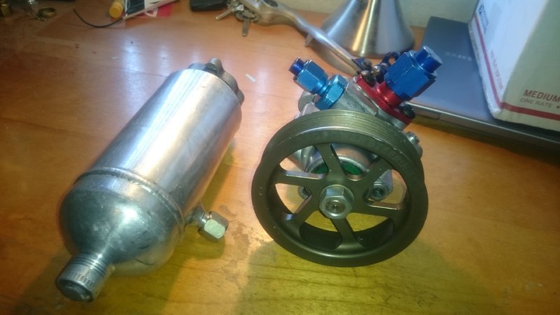

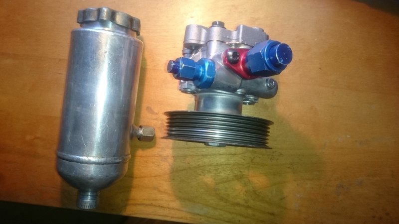

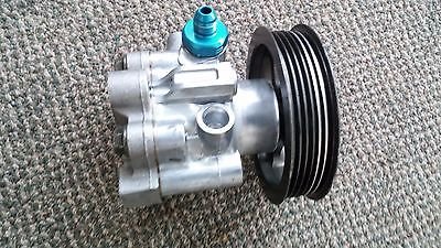

    Scored a KRC aluminum pump last night on Ebay. Will be using this with a hydroboost, remote reservoir, and added cooler setup I plan on retrofitting. Steering is fine turning super slow, but anything above that such as parking or any normal right or left turn the truck has next to no assist. Reason being from my understanding is that the pump cannot supply the volume needed for the rack, although the pressure is there. So this should solve the issue. On top of that the pump has flow control valves to easily change the feel we want in the steering.

    Pump arrived today! She's a beauty!! So I've done a bunch of math and thought of several scenarios. Will be getting Drift Motion's underdrive crank pulley which measures 5-3/8" which will spin this at just the right rpm at idle to get enough assist and will not over-spin this pump at its 9,000 rpm limit.
    Only concern I have is the stock 6" pulley has a harmonic balancer. The DM pulley does not. I don't have too much knowledge on harmonic balancers. Every factory motor I have seen has one and I'm sure it's there for a good reason. I understand all the theory behind them and stuff, but not too much real world information on running without one. Guess we'll see what happens here in the long run.
