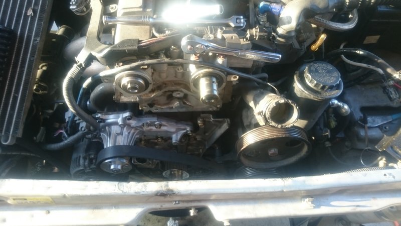

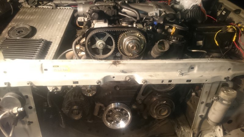

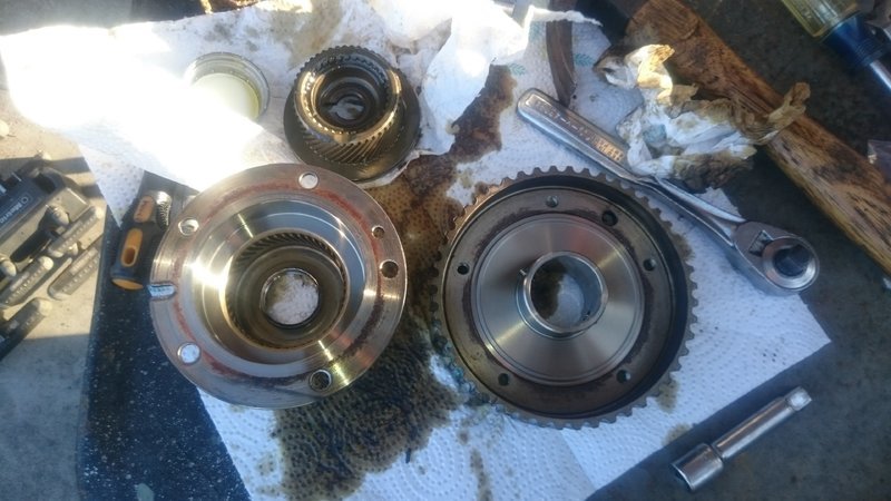

    Things that were done: spark plugs, oil change, water pump front half, camshaft seals, crank seal, vvti gear rebuild, vvti actuator cleaned, timing belt, timing belt tension pulley, hydraulic tensioner, 6" main pulley to 5-3/8" pulley for upcoming power steering pump and throttle body cleaning.
    Truck ran fine before despite how dirty the throttle body was and still runs good now. Good piece of mind now that I know where everything sits on major maintenance.
    Breaking the crank bolt loose...
    Definitely looking forward to moving battery to passenger side, Digital Dakota temperature gauge and fan controller, which will be shortly followed by new power steering system.

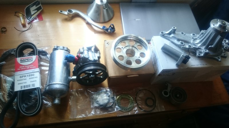

    Hey everyone. So I've been doing some thinking. Power steering pump is on top of the to do list, but I'm also going so start searching for any gs300's being parted out so I can start the process of the USDM swap and get this truck fully legal. Will keep you all posted.
