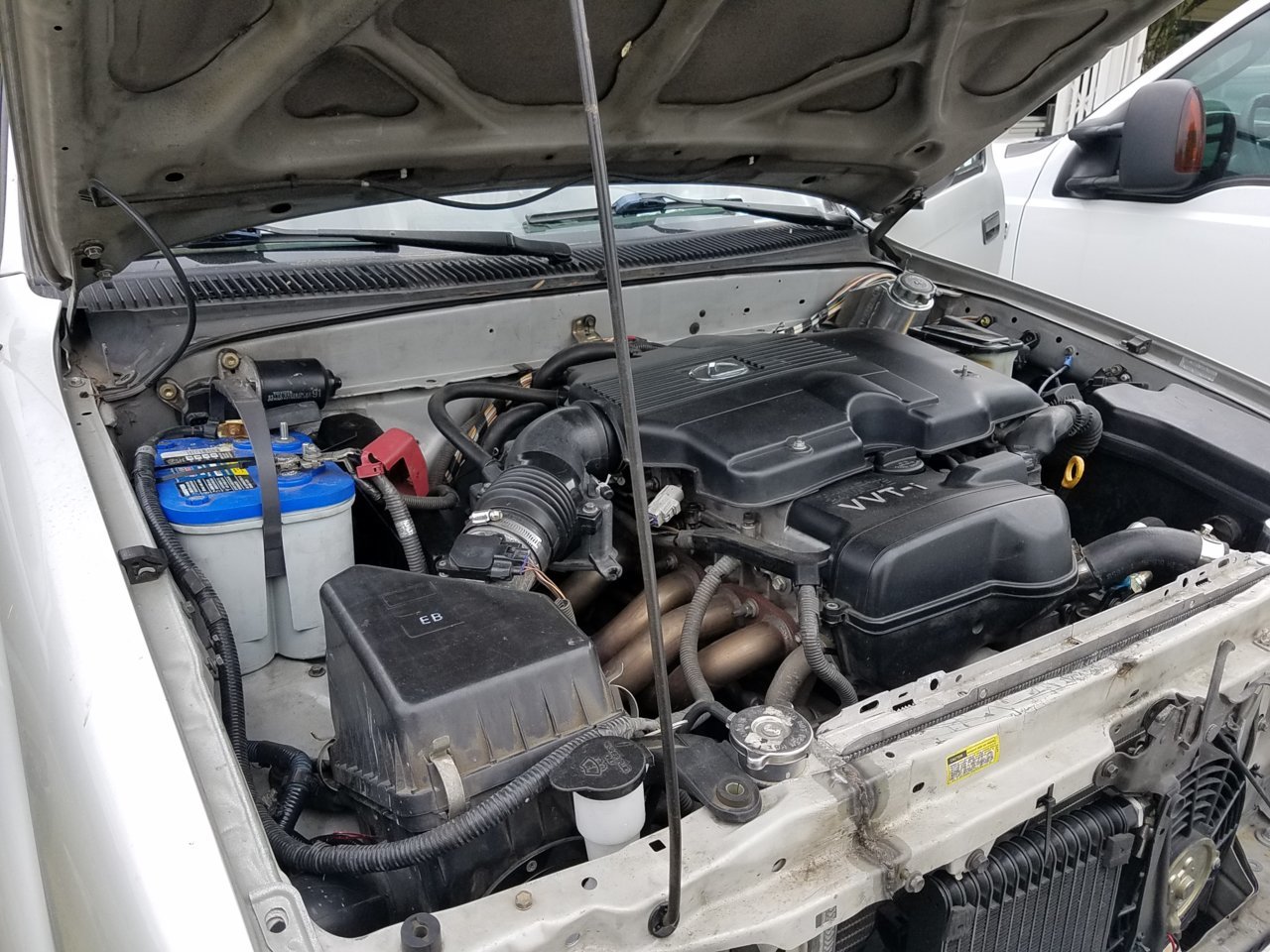

    There are two completely different 2JZ setups throughout this page. You'll probably feel a lot of frustration but see the breakthroughs as well. Enjoy the read! Truck has since been sold and is somewhere in NorCal as far as I know. I got tired of it, didn't care much for it after I broke up with my girlfriend whom I built this for, and had a lot more interest in building my regular cab. Nonetheless, learned an insane amount of knowledge from this build and really kicked off my passion for Toyotas.
    V1.0- Originally we planned for a direct 5vz swap when her motor gave out. Unfortunately due to some serious issues that came up with the two different motors we bought I ended up in frustration getting a better taken care of JDM 2jz-ge VVTI with A650 5 speed automatic transmission. The motor was out of a Toyota Aristo or better known here in the US as a Lexus GS300. You can scroll through the pages and see the frustration and evolution of making this work which had running on the road well over a year and had brought a whole lot of fun.

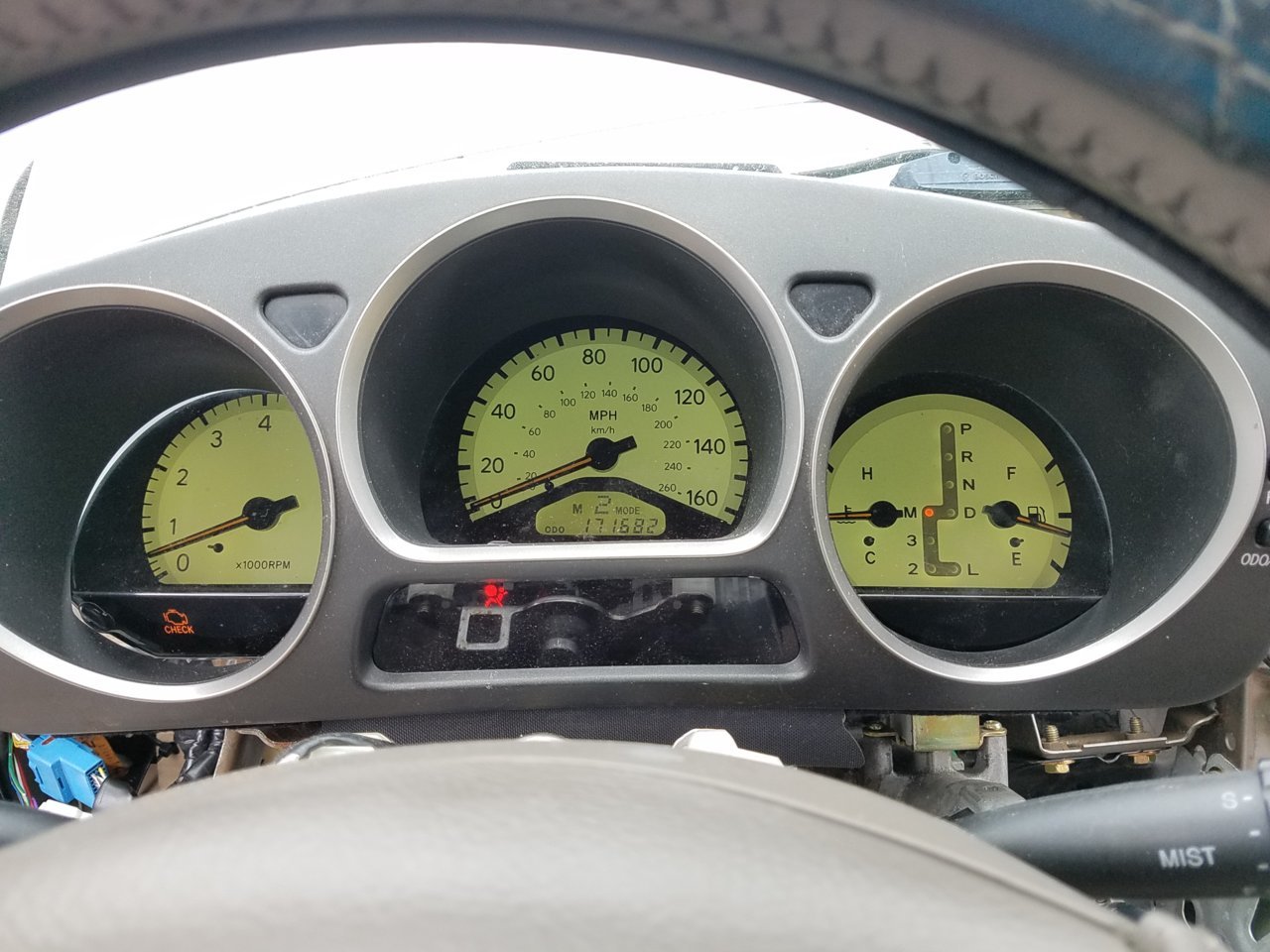

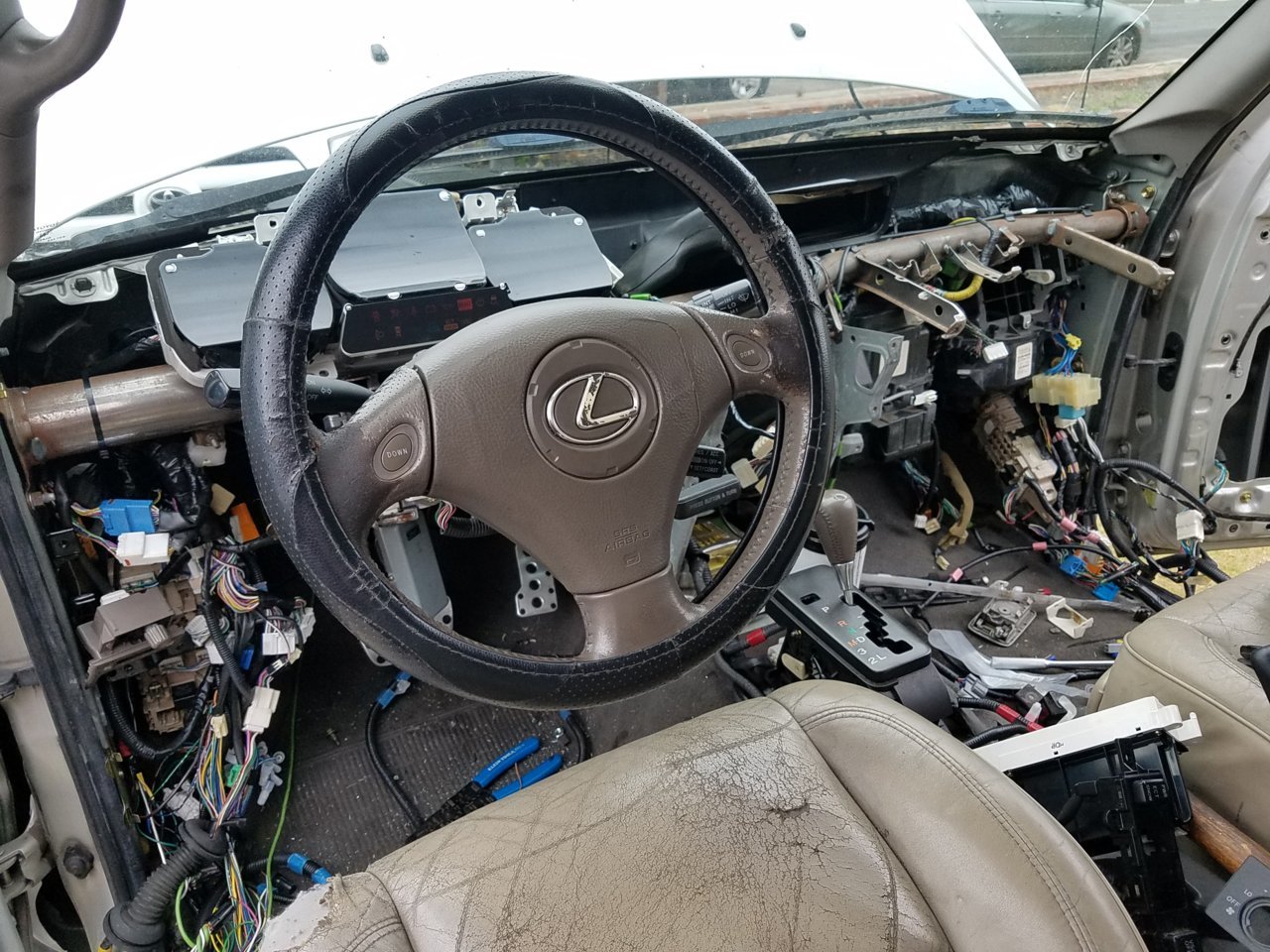

    V2.0- Fast forward to 'now' with a salvaged 2002 Lexus GS300. Literally everything from this car has gone into the truck. The massive dash harness, steering column, shifter, everything. In fact it probably would have been easier to put the Tacoma body on top of the GS300 and call it done... Here is what we end up with until I got tired and moved on from the truck.

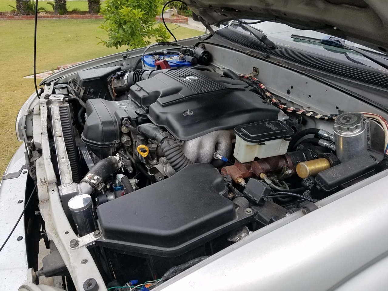

    Another update after a while... Still looking around and getting quotes on a harness.
    Truck now has functional A/C which is great. Just need to get the power steering hoses crimped. Also using the stock air box which is kind of neat. Going for a clean factory look. Not too into the steel braided hoses and stuff like that for a car like this.
    Found a perfect sized radiator for my application from Howe and will be going with some really slim electric fans from SPAL. Really hoping I can get these to fit without too much trouble and keeping my A/C condenser where it should be. Will be going with a separate transmission cooler rather than one built into the radiator for the motor.
