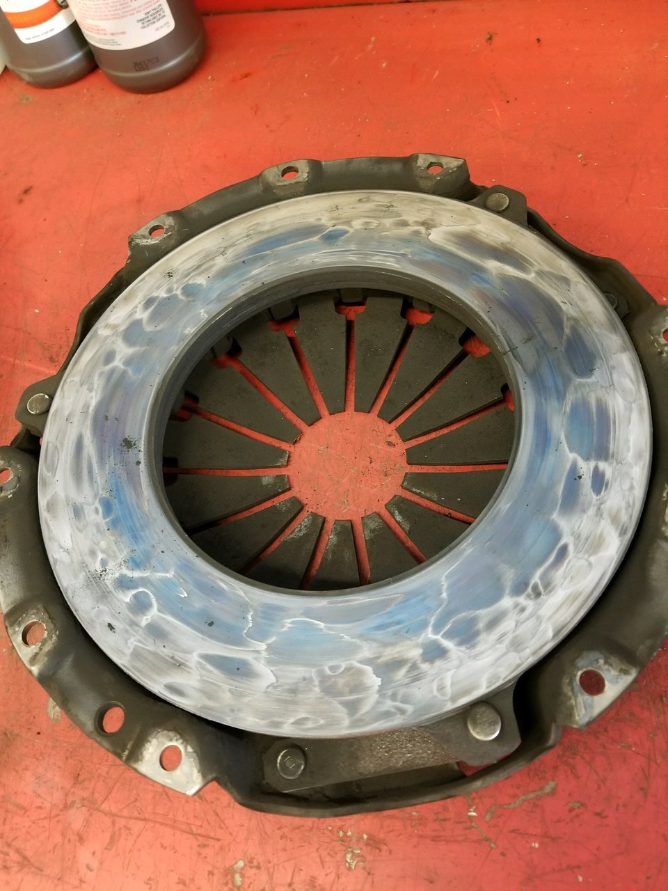

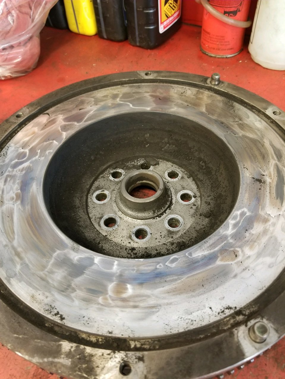

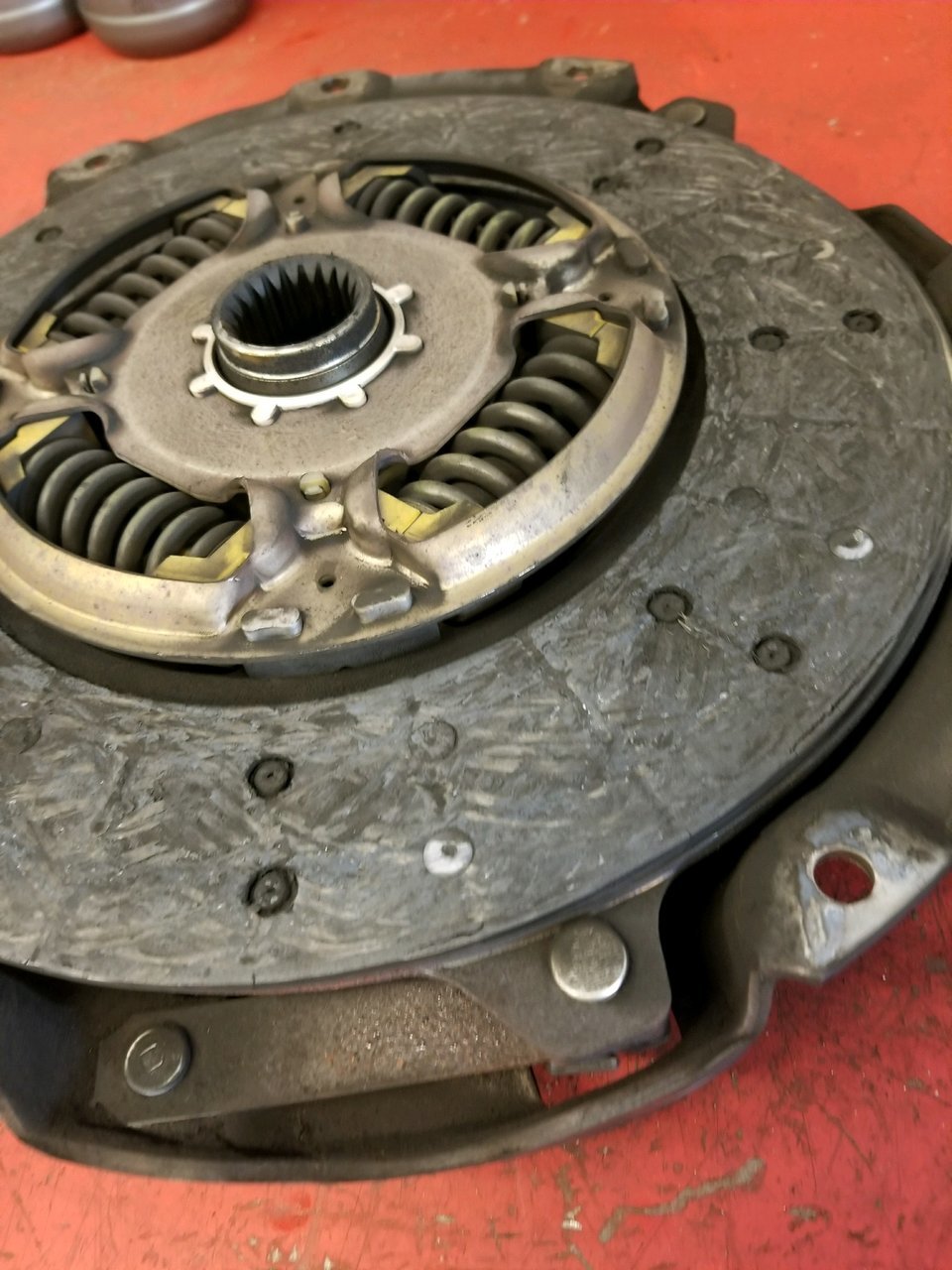

    I'm attaching the pictures they sent me of my clutch. The kid said it was the worst burned out clutch he's ever seen.
    This is the clutch from a 2014 Tacoma with 38,100 miles on it. I never once noticed any issues like this before. My 2 vehicles before the Taco were both manual transmission vehicles, both without any issues period, let alone clutch-related.
    The kid stopped just short of saying he didn't believe me when I told him there's no way my driving habits resulted in this. So basically, i'm an experienced manual transmission vehicle operator, without any prior issues involving problems wearing out a clutch, who just so happened to melt the damn thing in the last few weeks? At UNDER 40k miles?
    Is there any chance that my truck just has a defective clutch? What could the explanation be?
    Also, what happens if they just replace what they see easily, instead of looking closer into the problem? Did I just inherit a whole bunch of problems and an ongoing expense that I otherwise shouldn't have?
    Seriously, Taco family, I need your guidance on this one.

    Well, it's certainly been burned. To do that much damage I'd think you'd have to be riding the clutch or have it out of adjustment, but then I doubt it would have lasted 38k miles. My guess is something hung up to keep from fully engaging or disengaging. Whether that was something you did or not, couldn't say.
    But, yeah, clutches are considered wear items usually so unless it was something you can demonstrate was defective, something in the hydraulic system for example, then there's not much you can do. It looks like it has been worn to the rivets, so maybe it was adjusted too tight and never really fully engaged. I wonder if some people do that to keep the throw out from squeaking, dunno.

    If the pressure plate springs/fingers looked bent or mis-aligned you could (attempt to) make a case for a manufacturer error/cheap clutch kit. Try to get them to pay for at least part of it..
    But it is a wear item.. nobody is gonna cover it.
    Look at your clutch pedal. If the rubber pad is more worn than the other 2 then you need drive differently.

    To me that looks like they had the clutch disc installed backwards from factory, the hot spots are sporadic and isolated to small areas (overlaid on top of each other)
    whereas typical slip wear looks more like long blue streaks. I see one or two of those streaks but your wear looks more like scalloping on the metal surfaces. The wear on the disc is irregular too, looks more worn on the outside than the inside of the friction plates.
    You can tell it has gotten hot, but doesn't look typical to me. When I teach people to drive stick I have them slip the clutch to prevent stalling and usually end up replacing their clutch in the first year, they'll have lots of discolored spots and the disc is usually glazed but I have never seen one look that bad.
    Well we did have one lady come through about every six months for a clutch but she only ever used 3rd gear, that's another story.
    Clutches go in one way, I'd try to argue that if the tech can't prove it came out facing correctly than the disc was installed backward from factory and should be covered under warranty.

    Yeah (just took a look at the MT fan thread) the one guy said he had one installed backwards in his 1st gen tacoma and it drove fine for a while, having changed a few 1st gen clutches I'm amazed honestly there's a big difference between A side and B side, honestly I wouldn't have expected it to work at all.
    I have not changed a 2nd gen clutch but from what I have seen, they don't have as big a difference between A side and B side so the likely hood of an 'oops' from the installer is higher and the likelihood of it lasting a few years vs a few days is higher.
    Oops's happen, even on the assembly line, hung over Monday, late in the day Friday, newby on the line, old hand just gotten complacent...
    I've seen plenty of clutches do all city driving and look better than that one.
    Either something was installed wrong or failed prematurely or you really must have had no idea how to drive a stick or had been intentionally trying to burn it up to get that. And I don't believe either of those are the case, you sound competent and experienced. In the vary least you're aware.
    Even folks who do a clutch burnout (holding brakes too hard when trying to do a standing tire spin and riding the clutch) the wear on those looks completely different.
    As for proving it was installed backwards, really the only proof you have are the pictures provided and hopes that the tech has a picture of the disc with the pressure plate still on that shows which side of the hub is facing out, or hope that the tech doesn't have any pictures with the clutch installed to prove otherwise and that they rule with your reasoning, unlikely unfortunately.
