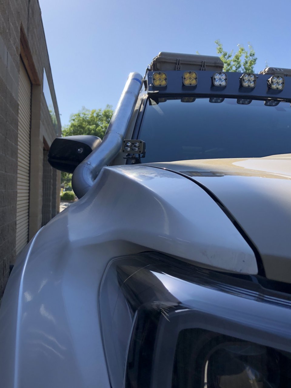

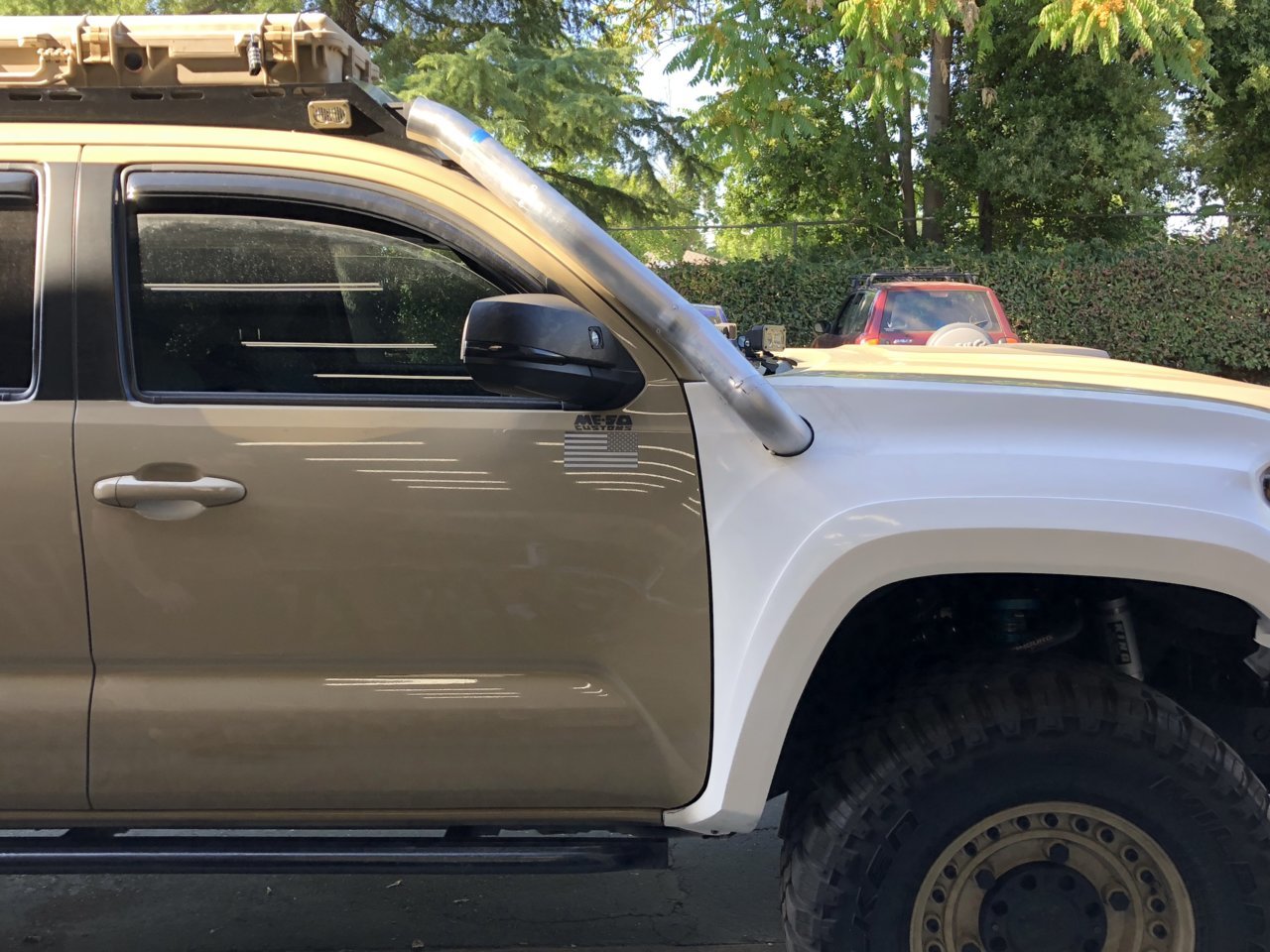

    Would you not be able to have something like this with the mcneil fenders? Why make the tube curve when you could just have it straight like this?
  16. Jun 28, 2019 at 6:05 PM
    #336
    MESO
    MESO [OP] Major Modder Vendor
    Feb 16, 2015
    #148809
    16,292
    State of Jefferson
    2016 DCLB TRD HELLCAT SWAP
    That one sits out from the A pillar a bit. Which is why he was able to come straight down. I wanted to hug the pillar as close as I could get it. Also, his fenders look like have more rise..which will help hide the pipe entrance.
    I have already changed my design to make it bend “less”
