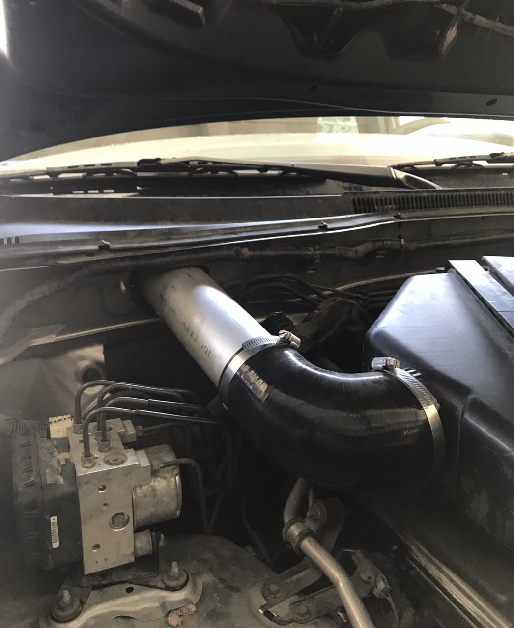

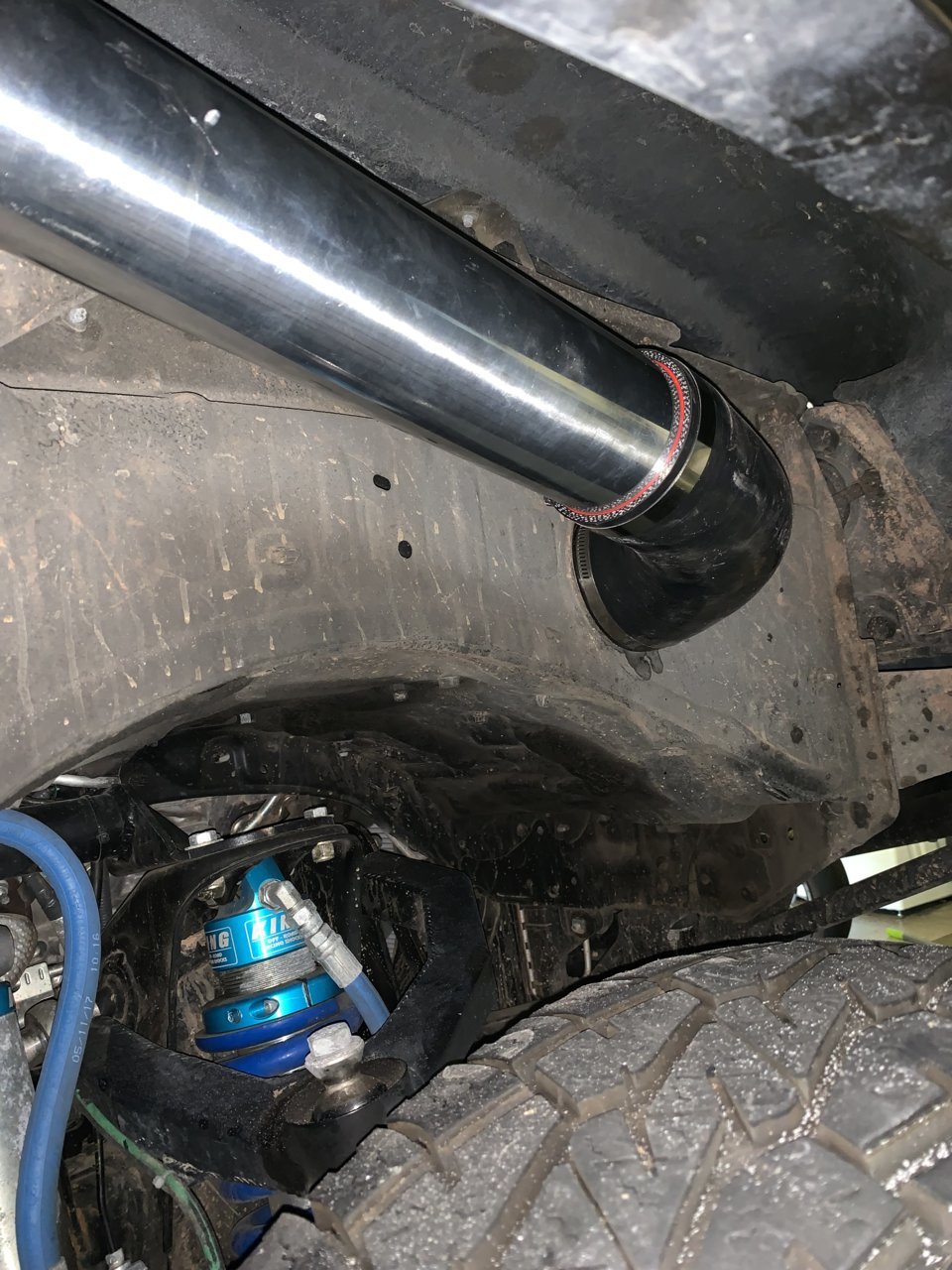

    Here’s mine done. Good enough for now. Might look into different snorkel heads/intakes later.

    How'd you plum the inside?

    Super simple. One 90* that one end is 4” and the other is 3”. The 4” comes off the stock air box then a 3” aluminum tube to another one of those 90* silicone coupler as above. The 4” end slides over the snorkel head.

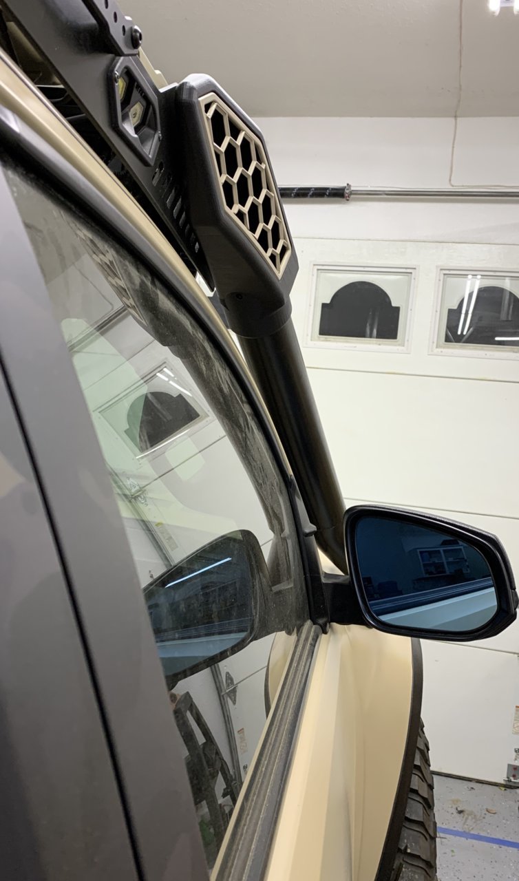

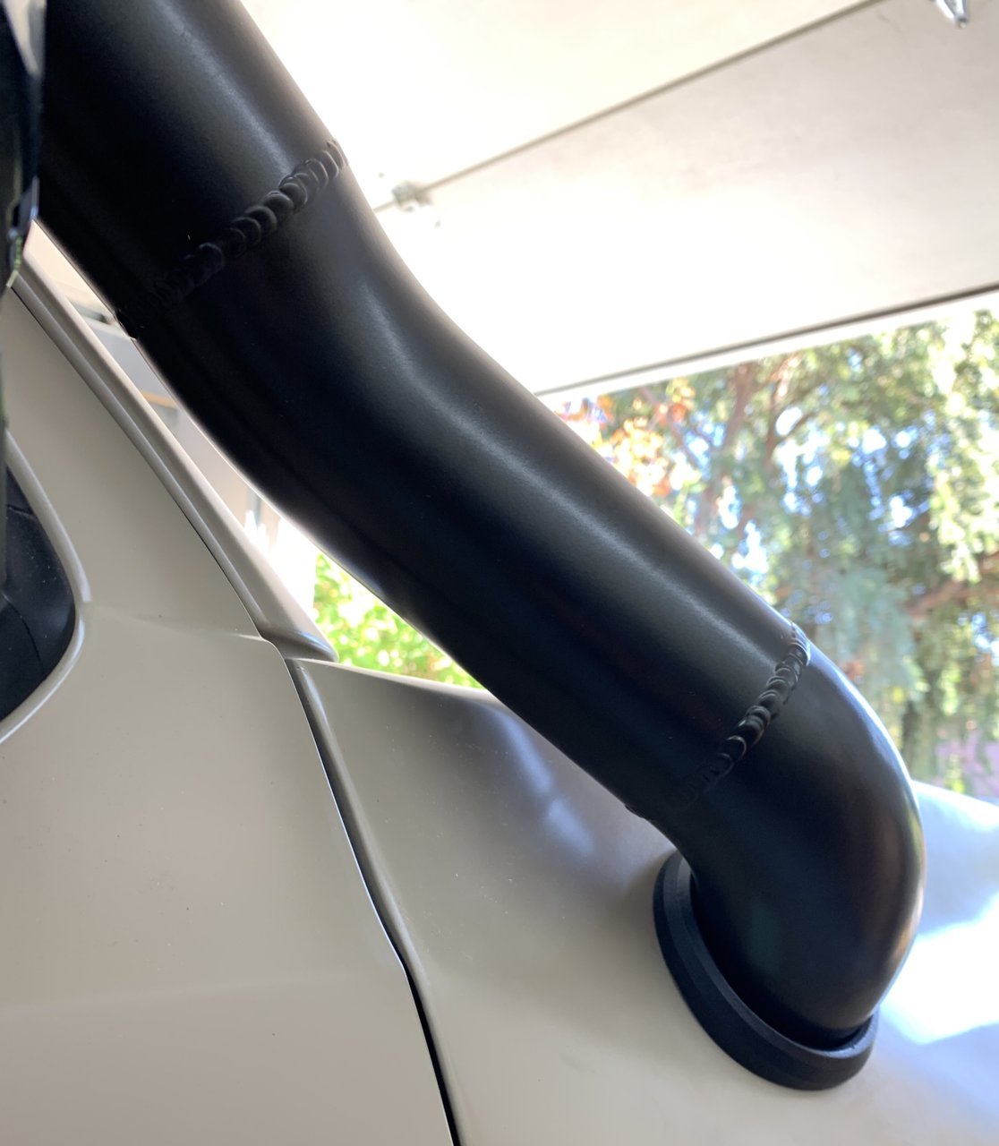

    My newest creation.

    @MESO more photos please particularly looking back at the truck from a few feet away. Are you going to be selling these?

    Holy crap that's nice

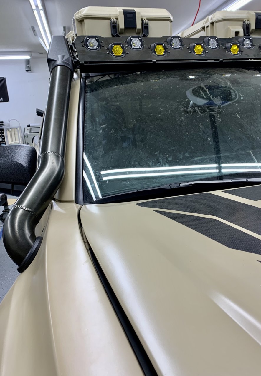

    Front and back
    not sure if I’ll sell them.

    I have no need for a snorkel.
    *looks at the @MESO snorkel*
    ...I need that snorkel.

    Love snorkel coming out of the top of the fender instead of the side. Very nice.

    Looks good! Hidden in plain sight almost.
    How high is the botton edge of the intake off the fender? I'd be curious in a good rain storm if it'd be able to suck water off the body work and have an issue since I don't think the ram intake design would function at intake vacuum speeds.

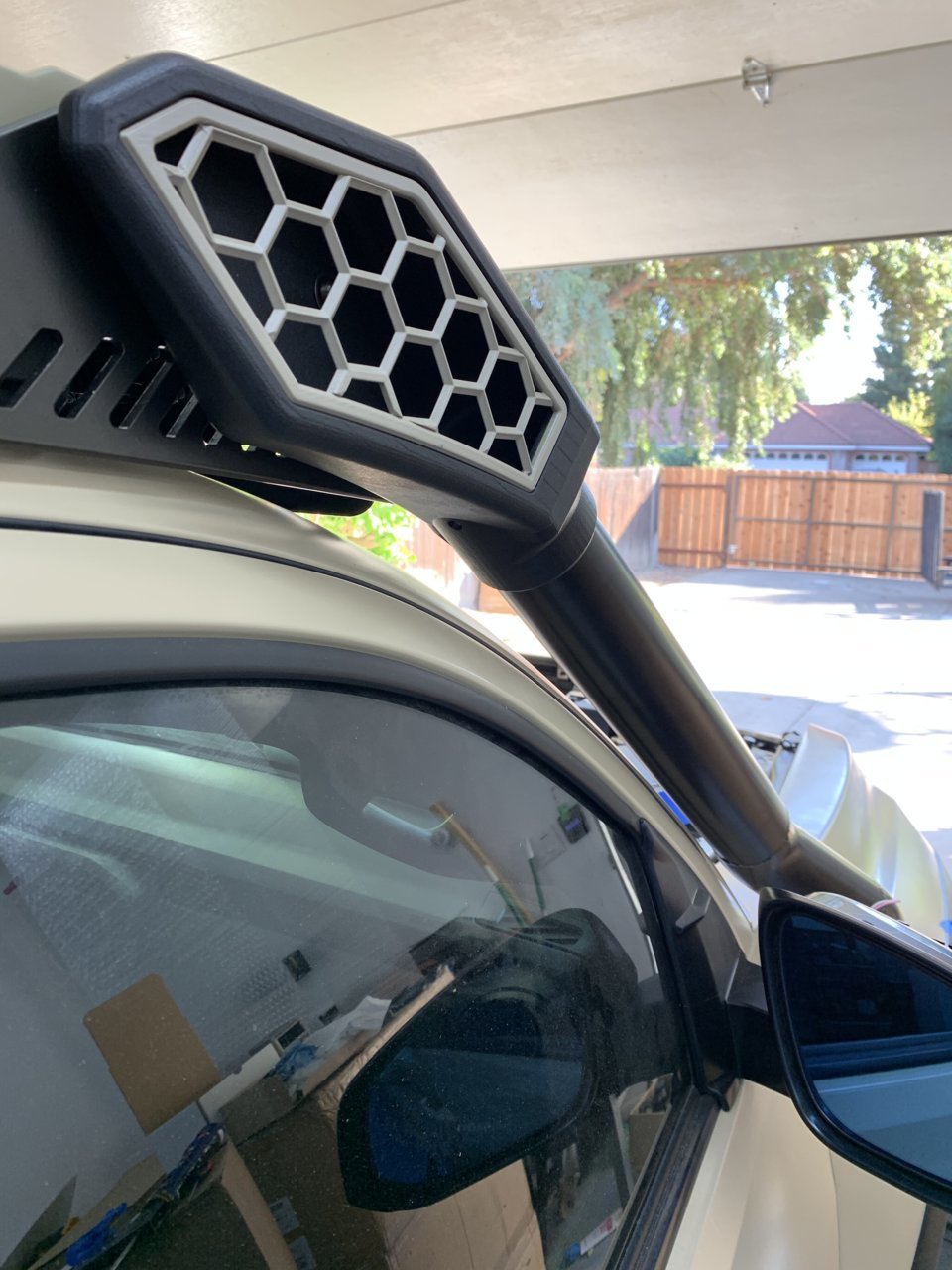

    I'd say we can be dangerous enough to bend our own tubing but you gotta replicate that honeycomb head. Does the mesh/comb you created separate from the actual head for easy painting?

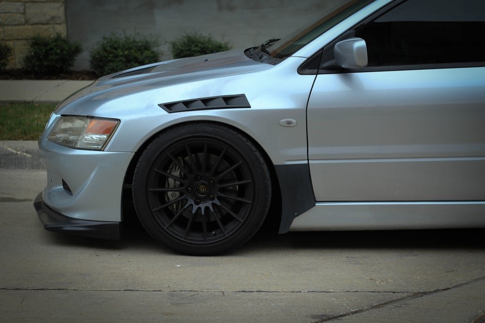

    I am not sure if this was mentioned here, maybe I missed. What about fender vents?! Run intake into the fender and have it grab air through those vents. My main issue is my intake exposed and my 35s push all mud and salt in the air box :annoyed:

    Divers side snorkel in the works....
