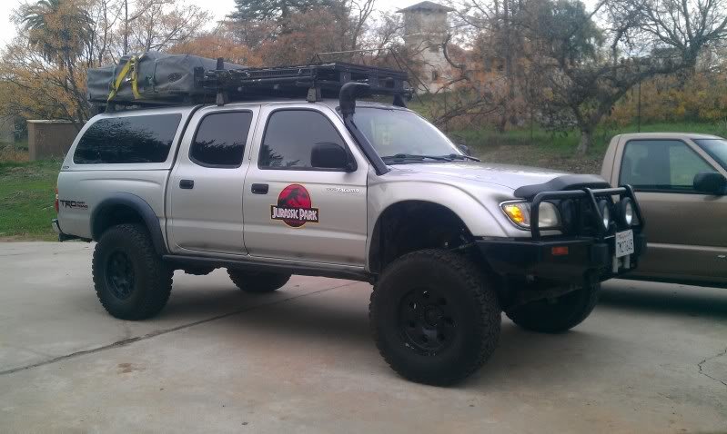

    What about re-working the fiberglass to make it flow a little more naturally/intentionally where the snorkel mounts? Similar to the process used for some satoshi grills?

    Is this the same guy earlier in the tread where the fenders were red??

    Based on those photos I think it actually fits surprisingly well on the glass fenders. It changes the angle a bit where it mounts to the windshield but it would be a piece of cake to make a new bracket there.
    I don't think it's the same guy with the red fenders. Those red fenders are Hannemans. These green ones are definitely Glassworks.

    Nice, When they get here looks like I'll cut them up! The pictue is pretty clean. Didn't like the one where dude cut a big ass hole then put some plastic over it to cover. The way in the picture looks pretty simple to fit.

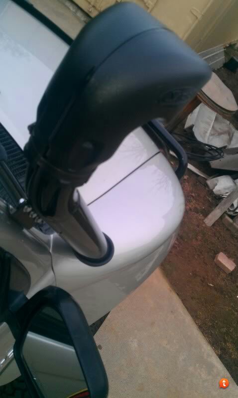

    Have a tube bent is a nice clean option. Zam15 did that on his snorkel. Cut a hole in his glass fenders and had the tube powder coated. It's a really clean look and probably what I will do if I can't get the Safari Snorkel body to mount up cleanly to glass fenders.

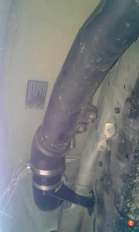

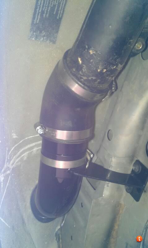

    Wanted to post some pix Derek (zam) posted.
    I asked him for details on his snorkel set up 3" exhaust pipe bent and powder coated
    Pretty clean if you ask me. He has 6" glass though. I'm going with 4.5 glassworks.
    Green truck is what I'm going to attempt. .

    In my opinion his looks the nicest/cleanest of all the options I have seen here in the thread. If it were me I would probably do it that way. However, I think that with Adam's design/fab skills a completely custom snorkel using the methods this guy used could be really cool and really unique.

    I actually had this in mind when i opened the thread.. if you're set on the glass fenders this looks the best IMO. Personally i don't like the look of those style fenders but its your truck haha.. your truck is my favorite first gen though so I'm sure it'll look great no matter what especially if you choose the route above.
