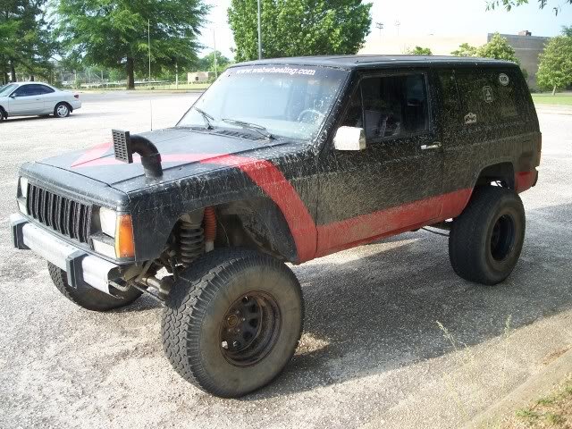

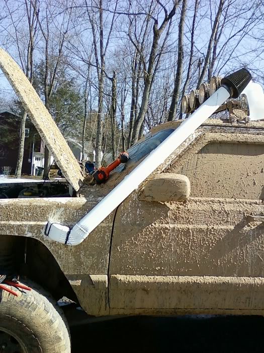

    this one is pretty sweet.:facepalm:
  5. Jun 16, 2014 at 10:39 AM
    #85
    Box Rocket
    Box Rocket [OP] Well-Known Member
    Mar 1, 2010
    #32389
    7,184
    Adam
    Syracuse, Utah
    1995 FZJ80 Land Cruiser
    3xLocked, lifted, well used
    jeep guys.:smack:

    Love the CAI filter at the end of the second one.

    The first one seems like it would get a lot of dust and even water splash being so far up on the truck.

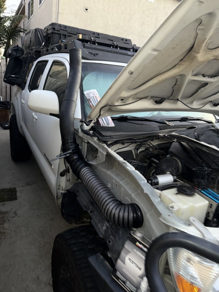

    I’m doing a similar build with 3.5” aluminum and some used McNeil bulged fenders.
    I am learning as I go with this project and it seems the Safari snorkel ram air heads are engineered to dissipate rain water through channels and out of the bottom of the head.
    Asking for opinions from the group on whether or not this design feature will work without the full Safari system. It seems like it should function the same way, but figured I’d ask before drop $116 on ORW.
    https://www.offroadwarehouse.com/product/safari-snorkel-air-ram-grill-000135600/Default.aspx?gfid=p209888&source=googleshopping&creative=721555664845&keyword=&matchtype=&network=g&device=m&gad_source=1&gclid=Cj0KCQiAouG5BhDBARIsAOc08RQ7hfKVNcnauvId3PsrqnKq15RpLArAafp3oOt2SVz_JkOneoUAsXkaAvupEALw_wcB
    Attached a picture of the current status of this project. I used the aircraft ducting from Aircraft Spruce.

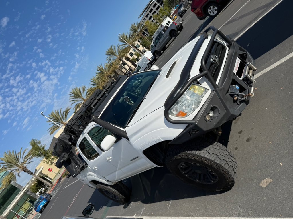

    Here’s the finished project. Not a showroom finish with the fiberglass, but I learned a lot restoring these fenders.
