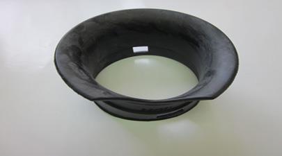

    Best $29.00 or less you can spend.
    TRD Intake Flow Accelerator. Air Intake System.
    Part Number: PTR0335090AC
    Supersession(s): PTR03-35090-AC

    Eibach pro truck 2.0/2R lift kit 1.5" AAL OME/ARB UCA BFG KO2, 285/70-17 SCS Blaze 10, 17-8.5, -10 offset ECGS bushing needle bearing replacement Clutch accumulator disk delete Poor mans TRD intake, K&N 57 series intake tube, K&N high flow filter, TRD flow accelerator
    since the tacoma is already essentially a cold air intake i got the kn series 57 which is a straight intake tube that replaces the stock one with the baffles, and a high flow k n filter. also added the trd flow accelerator. definitely a difference in sound, tiny bit better mpg, and a tiny bit more hp on the butt dyno
