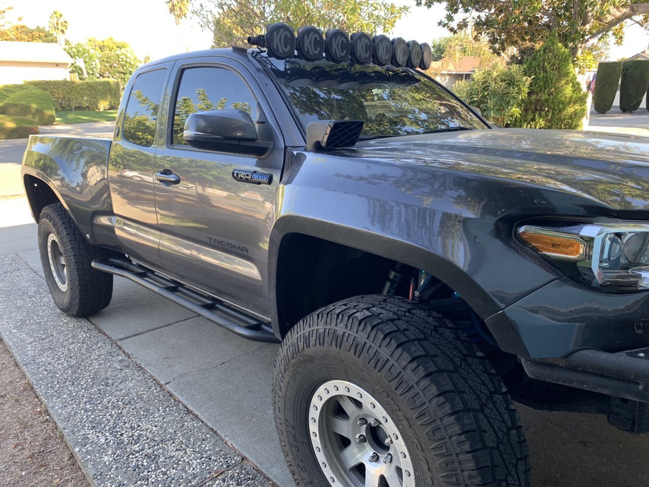

    No that snorkels are even more popular than ever with new brands left and right I’m hoping someone has made a better looking “collector”.
    Here’s is what I am working with. Personally I think I the snorkel top I am using is pretty dumb.
    Are there any better looking options that might look better?

    I’m not really sure why you only raised your intake by 6”. I have only seen this style and the dome ones similar to the HMMVV.

    This is basically cowl intake which a lot of folks on here are doing. I would absolutely go for this.
    Edit: getting the intake out of the wheel well is a big plus in my book even if it’s not much higher. What brand is that?

    ^OP's truck appears to be built for desert running. Snorkel there is to get the intake out of the wheelwell (since he has no fender liners).

    I don’t have wheel liners so I wanted it up out of the way. Also helps with some water crossings. Not snorkel level obviously.

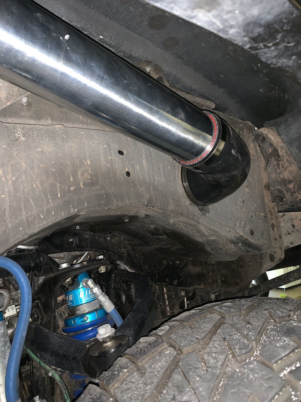

    Yep. I don’t have wheel well liners so I made this. It’s just a generic snorkel top I got from either Amazon or summit. Then a piece of aluminum pipe and a couple silicone elbows.

    Ding ding! Exactly. I was left with a big open hole in my wheel well. This was the best solution I could come up with.

    So there are a ton of these on Amazon, but here’s one example. They are all the same, just “different” vendors.
    https://www.amazon.com/dp/B08QDJXZ5B
    Here’s a crappy pic I have of the inside. I can get a better one tomorrow. It’s basically: intake hole > silicone 90* elbow > aluminum tube > silicone 90* elbow > snorkel head.

    I have some stupid looking 6” fiberglass fenders that I could probably park a bus under. So I ran the intake out there. :)
