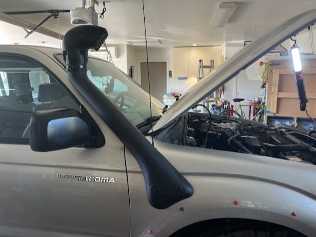

  10. Nov 20, 2022 at 2:26 PM
    koenbro
    koenbro [OP] Well-Known Member
    Feb 7, 2017
    #209951
    285
    Phoenix, AZ
    2001 Tacoma SR5 Xtended cab 3.4L 5Spd
    Have installed the thing, photos will follow soon.
    Question: Should I point the snorkel intake forward, or back? I have seen (on Youtube and in person) people in Africa point it back, and was wondering if there is some reason for the orientation.
    Area51Runner likes this.
  11. Nov 20, 2022 at 2:29 PM
    Area51Runner
    Area51Runner Well-Known Member
    Jun 26, 2014
    #132748
    11,969
    Northern California, Bay Area
    02 3.4 DC TRD PreRunner 4WD SWAP
    Forward. Even in the heaviest rain we've had in NorCal since I installed it (how many years now?), nothing bad has happened.
    you could always swap in this if still concerned
    https://smile.amazon.com/OCPTY-Snorkel-Cleaner-Pre-Cleaner-Accessories/dp/B08GQRZ5GY
    koenbro[QUOTED][OP] likes this.

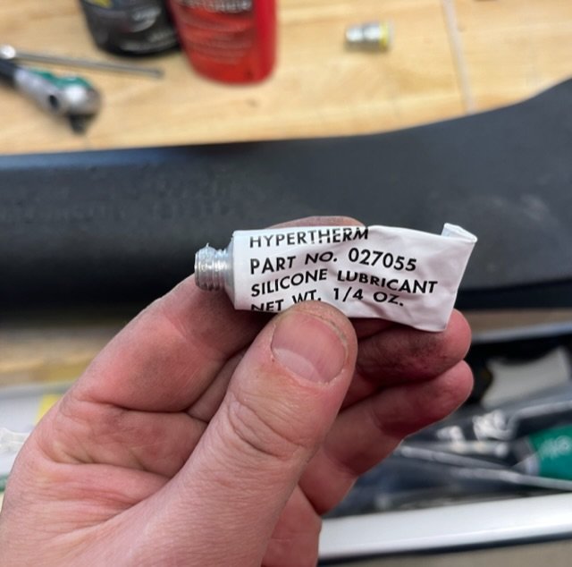

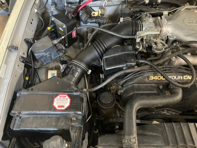

  13. Nov 20, 2022 at 3:02 PM
    koenbro
    Feb 7, 2017
    #209951
    285
    Phoenix, AZ
    Had an extra tube of silicon grease so used it up for the connections.
    Still need to reattach the liner and the trim piece.
    Airbox is back.

  15. Nov 20, 2022 at 6:38 PM
    koenbro
    Feb 7, 2017
    #209951
    285
    Phoenix, AZ
    Thank you for the comment -- your point is worth repeating, that the snorkel is not (as much) for water as it is for cleaner, cooler air from a higher level.
    Area51Runner[QUOTED] likes this.
