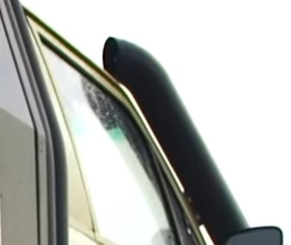

    Put a stainless pipe pointing backwards like the Aussies do.

    The manufacturer (Safari) seems to suggest forward facing:
    Safari Snorkels
    Hercanstein and eon_blue like this.

    How dose the fusion tape work?
    I'm definitely sucking in a ton of dirty air from that spot. ie. We're the box meets the tube. I thought about trying to see if I could fit a silicone connector over it to help with sealing. I know some people use rtv to help too.
    Also OP. the hat faces forward. Therea a older video on YouTube were they tested out the different positions and the consensus was forward was the most beneficial.
    Also if you want to be busie you can go with snorkelupgrade.
