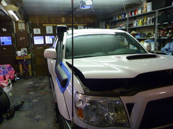

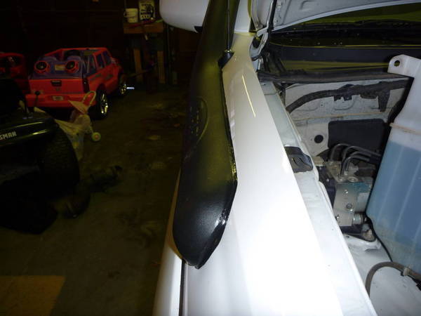

  2. Jun 1, 2011 at 6:47 PM
    #322
    maxpower29
    maxpower29 Well-Known Member
