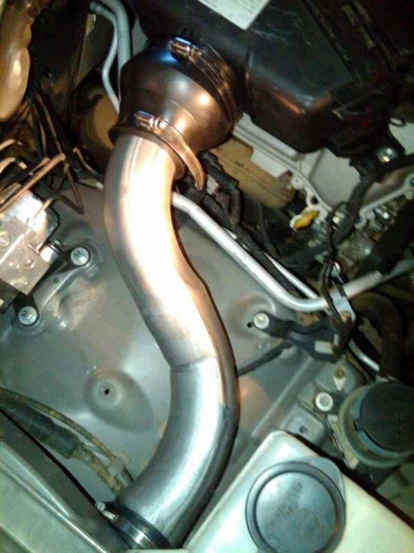

    I'm heading to Moab next week and I really don't know what the best way for the connection is for my 2011 there is allot on this topic.
  6. Jun 15, 2011 at 4:48 PM
    #406
    misc
    misc [OP] Well-Known Member
    Aug 18, 2011
    #61915
    492
    Clean flowing air with the least amount of bends is the best.
    Others I like
    The guys who did the install this way seem to have the best gain in mpg efficiency from what I have read.

    PM homertaco he put his in and connected to some CAI not sure what one

    Would be the same as a 2.7 I would think. I researched this for a while and it seems like it would be easy. A couple guys did it to theirs on here and said it was a cake. If you find an easy adapter I imagine it will look sweet too. Fresh and factory!

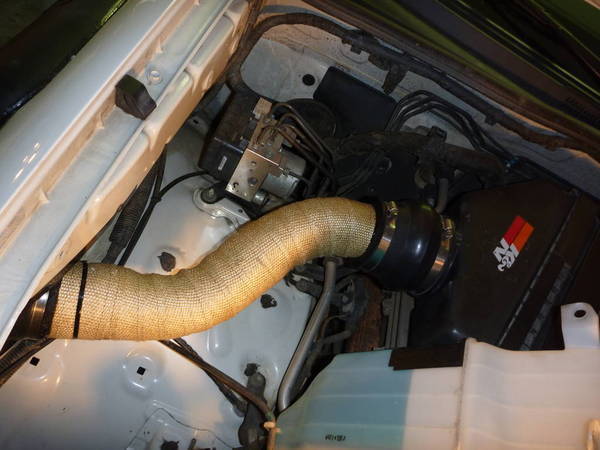

    Oswego do you have a a scangauge or anything like that? I was curious if you knew the intake temp you were getting versus the outside air since you wrapped yours in the exhaust wrap.
    With my EcoRoute HD tied to my Garmin I have a set of gauges that monitor various things and one of them is intake air temp. When the engine is cold the temp are usually the same but at running temp they get to 12 degrees apart. Typically the air in the intake is 12 degrees cooler than outside. But it is crazy to see sometimes just how hot the intake air is when the truck sits somewhere after running and it is hot outside.

    Nope. I don't imagine the wrap is doing much, but I have no way to check. I needed the wrap for my DT Y pipe and knew I wouldn't use it all so I figured WTF might as well get the coolest air possible in the engine. I think next winter I am going to turn the snorkel around. I have read that the 4.o V6 struggles to keep warm in very cold temps so the CAI with ram air might not be the best idea when it's 0* out.
