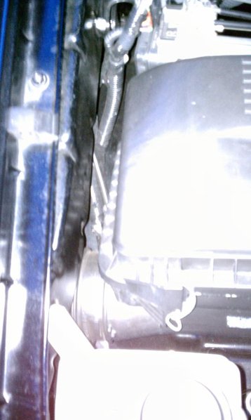

    here are some pictures of what i'm talking about. the air cleaner is smushed right on top of the fender. doesn't seem to me like there is going to be a lot of room to make the connection between the snorkel and the air cleaner.

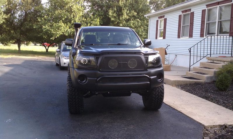

    thanks boyd it looks great and didn't throw any codes on the way home. i'm going to try losing the washer tomorrow and see what happens lol. i'm also gonna check with ok auto and see if they can tune it when i go in on the 15th.

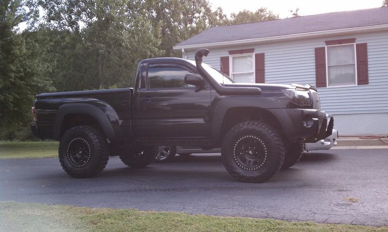

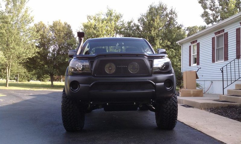

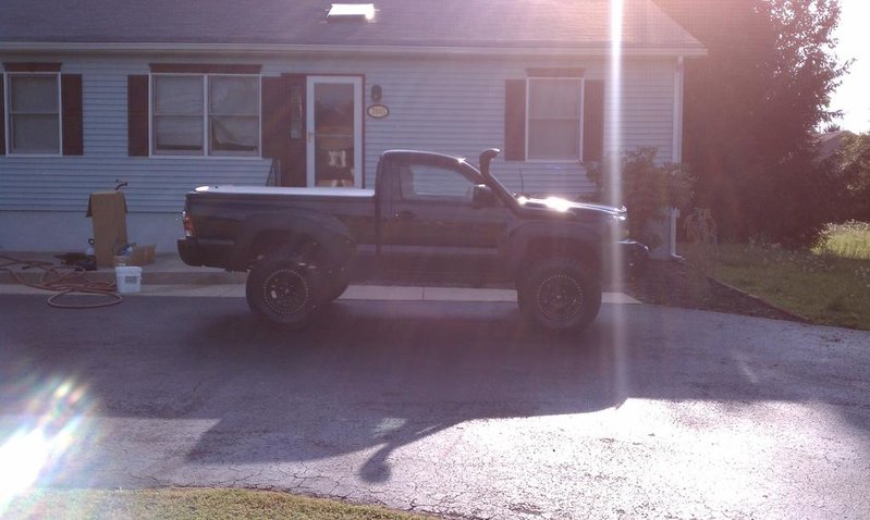

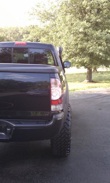

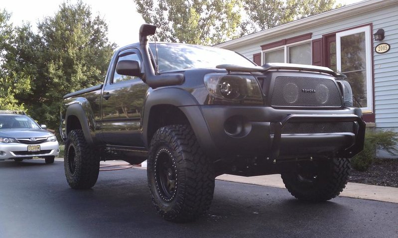

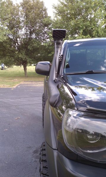

    add another one to the list:cool: thanks to boyd i didn't kill my fender needlessly and the snorkel got mounted up and it looks and functions absolutely perfect, but enough from hans lets get to the pics...:D

    do they make a afe pro dry for the 4 bangers? if so i'm picking up one of those as well for the air box. this thing is awesome on the truck! the throttle response seems a tad better as well.
    when i go back to have my lift looked over i'm going to see if they can reflash the computer to make sure i'm not running to rich or lean.

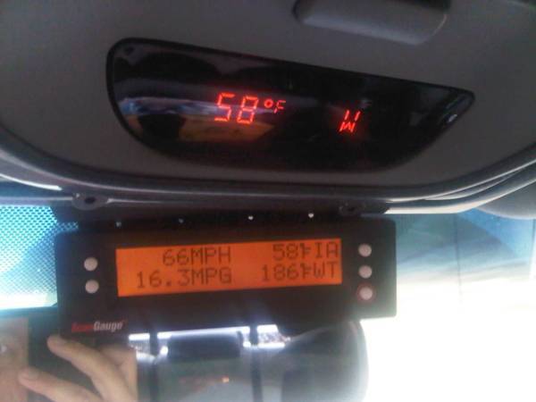

    where is the sensor getting the temp >?

    The Scanguage hooks into the OBDII plug & gives all kinds of neat info.

    ECU is reading the temp at the MAF sensor. When you have a device like a scangauge plugged in to the OBDII that can translate the data you get some cool readings.

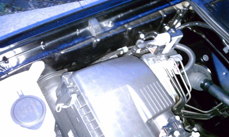

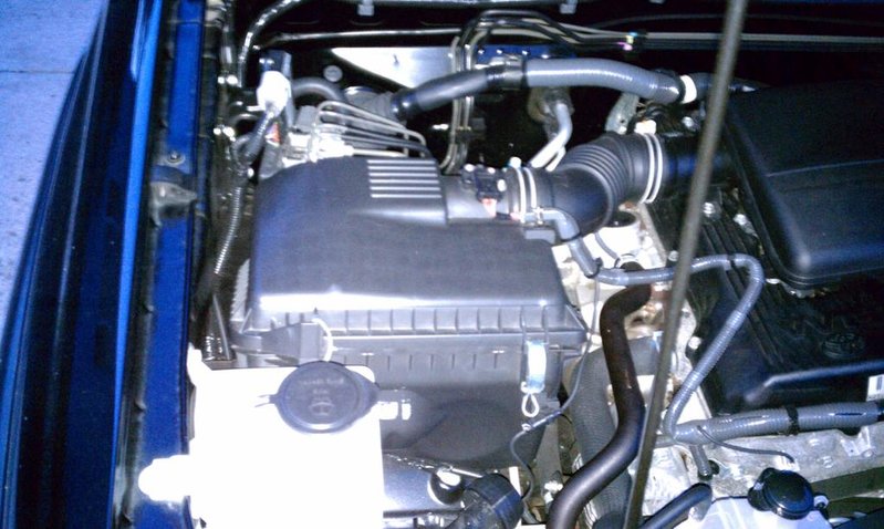

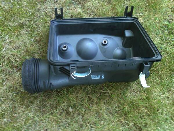

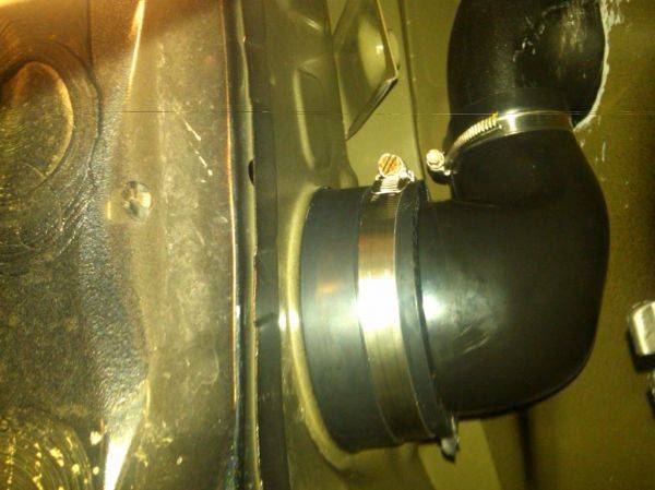

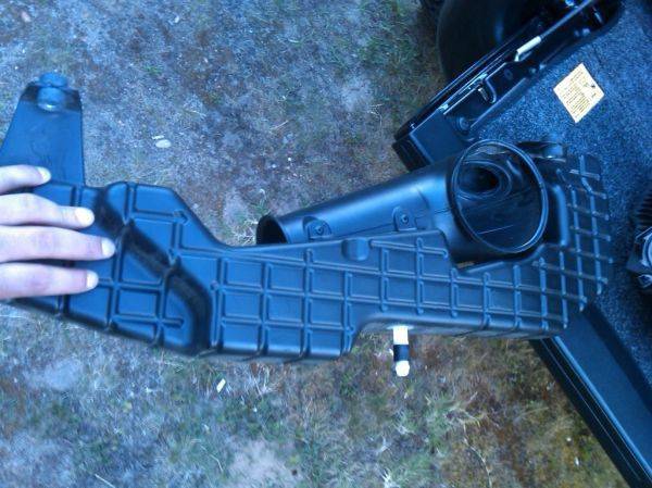

    Parts you need to buy (different from v6 install)
    (1) 3" x 3" (see pic below)
    Start by removing the intake (1 wire harness and 3-4 bolts). When you have the lower portion of intake removed take off the foam & rubber gasket that was slightly inserted into the fender.

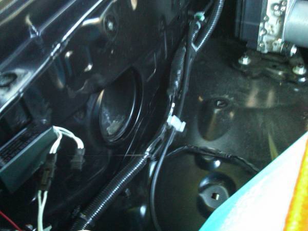

    This would also be a good time to remove the washer fluid res (2 bolts and 1 wire harness). We did not drain the res so we did not disconnect the lower fluid carrying tube. This tube does not need to be disconnected as the tube is long enough to relocate the res without removal.
    And this is what it should look like after these steps

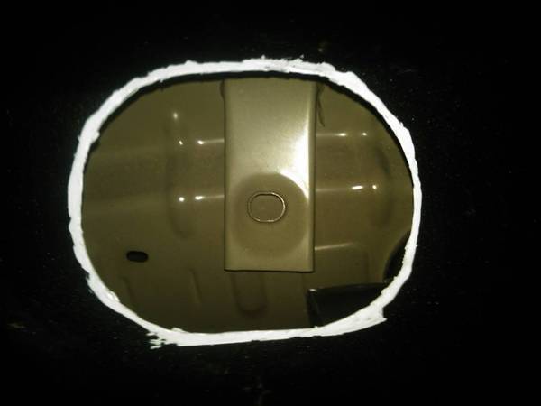

    Now it's time to remove the fender splash guard body clips. Good luck :devil: This is by far the hardest most time consuming part. We only removed enough clips so the splash guard could be folded over the tire so it's out of the way. If you want more room remove your passenger tire before
    removing the splash guard.
    Note: You can NOT remove all the splash guard clips due to the fender baffle shown below. They will have to be cut and replaced later or ripped out by force since the top is not accessible.
    Once the splash guard is removed its time to remove the fender baffle (2 bolts)
    If anyone has any idea WTF the above baffle does or is - let me know and Ill edit this to reflect it's correct name and use.
    The brace shown in the middle of the hole is one of the baffle supports. Bend it out of the way by hand.

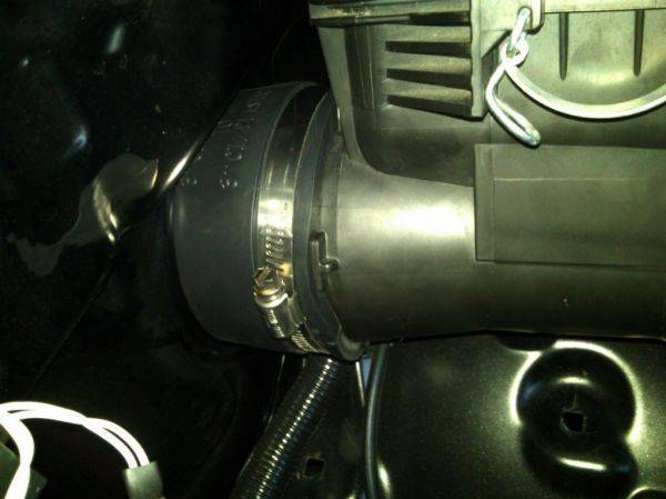

    Insert the 3" x 3" fitting into the fender (pic of inside of fender)
    Insert the intake

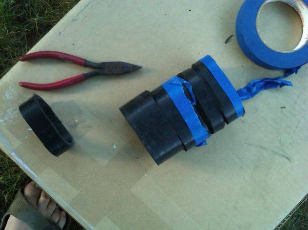

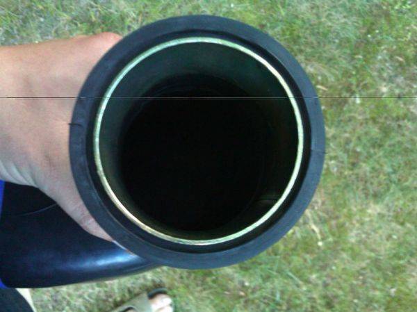

    Insert a hard tube into the round rubber section of the snorkel. This will allow the 3" x 3" fitting to be tightened down to something so it is able to seal correctly.

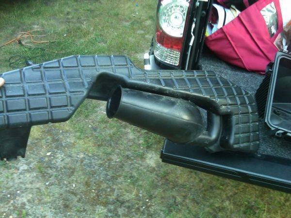

    Now it's time to trim and test fit the snorkel just like you would a V6 so refer to the OP.
    Here are some additional misc. pics
    What we trimmed - the stuff to the right is rubber and the piece to the left is the actual hard plastic snorkel
    When we were done Han's truck the check engine light and the traction control "idiot lights" came one at the end. This could be due to us running the truck without the intake on or other factors. We disconnected the battery for 5 minutes and he hasn't thrown a warning light since. A re-flash might be in order due to a change in air flow :notsure:
    This information is not from a professional and any shit that happens to your truck by following it is on you. If you can't handle the install take it to a pro.
