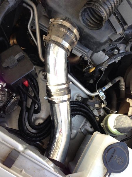

    Installed them today, and worked GREAT!!!!!

    Saw that in the live thread, a little bling under the hood looks great! A lot less restriction than all the 90*s in mine...SWEET!:p

    Eh, thinking about color matching it...that is how it came...

    wow thats good flow. Let us know if your mpg improves

    Would it cause major airflow issues to reduce the size of the pipe in the middle between the snorkel and the air intake to back between a battery and the washer fluid tank. I only have about 1"-2" between them, i could however make the pipe more of an oval as I have room to grow the pipe vertically.

    2" thick oval may be enough if it's tall enough. To be sure just copy the oval of the end of the snorkel where it meets the rubber hosing. It's the smallest section. I would not go smaller then the ID of that tube with the ID of your new tube
    also you can get some extra room out of the washer resi by clocking it slightly.
    I got a longer screw from HD and added some 1" round rubber I had laying around as a vib free washer
