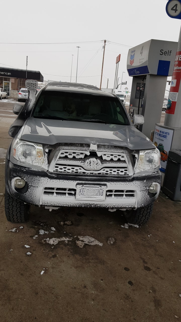

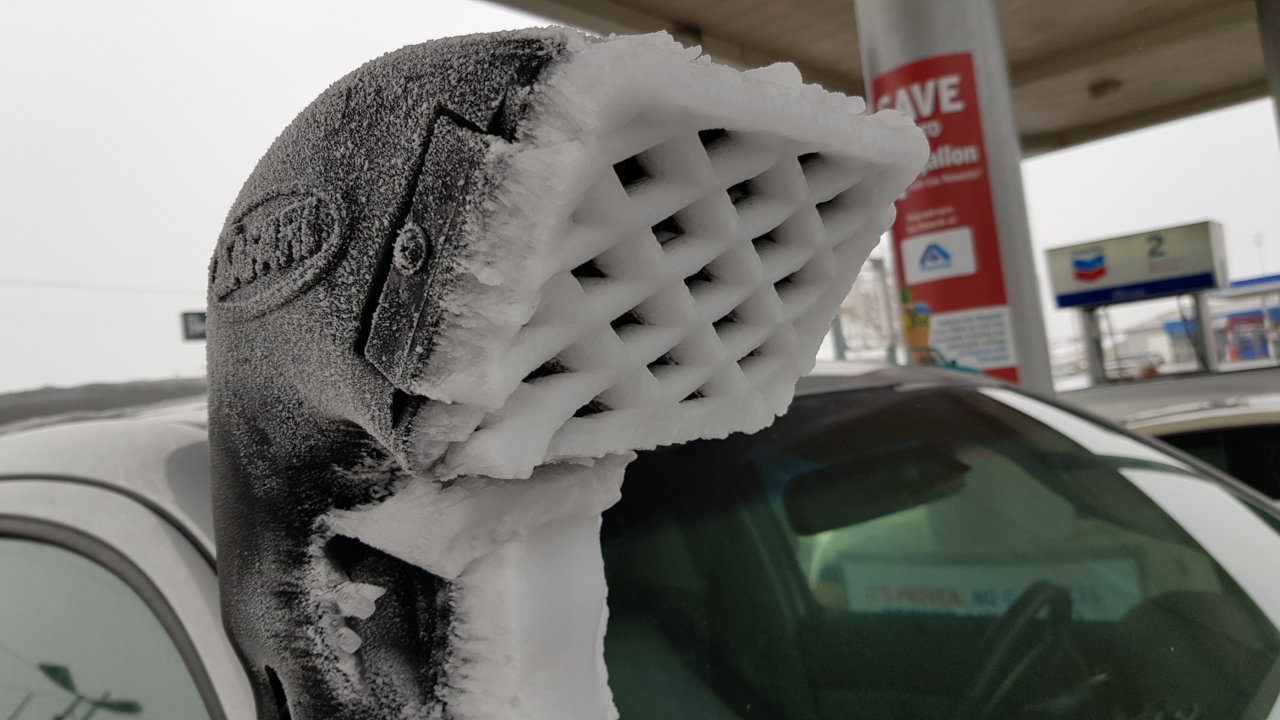

    :rofl::rofl:restricted air flow, power loss, mpg loss :rofl::rofl:restricted air flow due to the smaller diameter of the tubing :rofl::rofl:
    You are increasing it.
    20190112_085341.jpg 20190112_085314.jpg 46521513_2278914618849892_2526166619521024_o.jpg

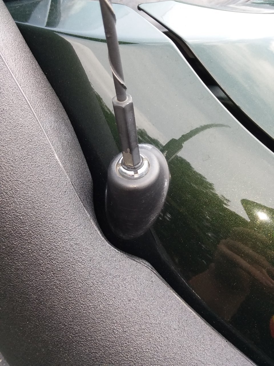

    Has anyone with the 2012-2015 model trucks had trouble getting the Hilux snorkel to sit flush around the antenna? The fender seems to be in the way. thanks20190605_162945.jpg

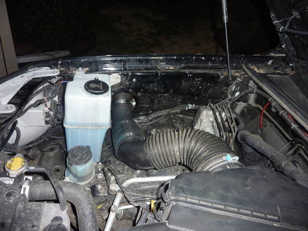

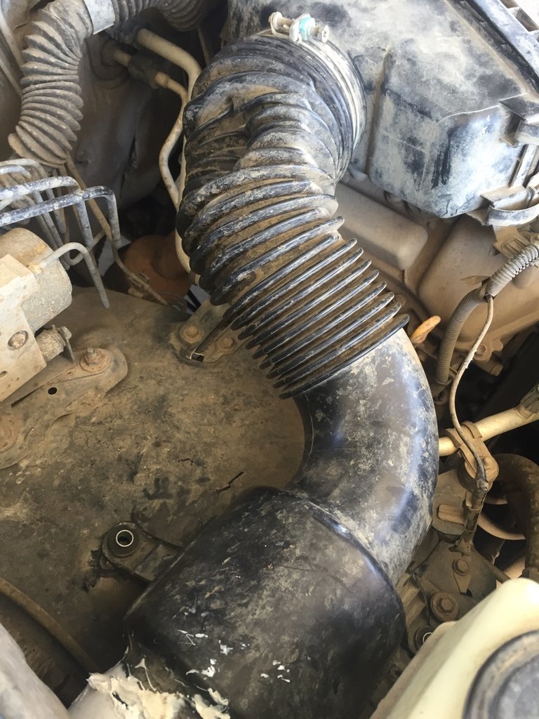

    Received the kit and this 3in exhaust tube came with. This wasn’t listed as a part and it’s not in the install instructions. Any ideas?
  13. Apr 11, 2021 at 7:43 AM
    #813
    JLink
    JLink Well-Known Member
    May 9, 2010
    #36795
    12,582
    Josh
    Ocean, NJ
    Lifted, Locked, Armored. Ready To Wheel.

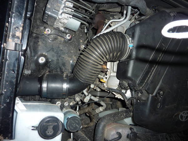

    Should be able to use that to join the snorkel rubber hose to the air box inlet tube. I’ll see if I can dig up an old picture.
    edit: found some pics of how I did mine-
    I painted the exhaust pipe black, and used a fernco fitting from Home Depot to connect it to the oem air box tube. Just had to cut the end off it.
    This was back in 2011 and the pipe wasn’t included, so I went to an exhaust shop and had them bend a slight angle and I cut it to length.
