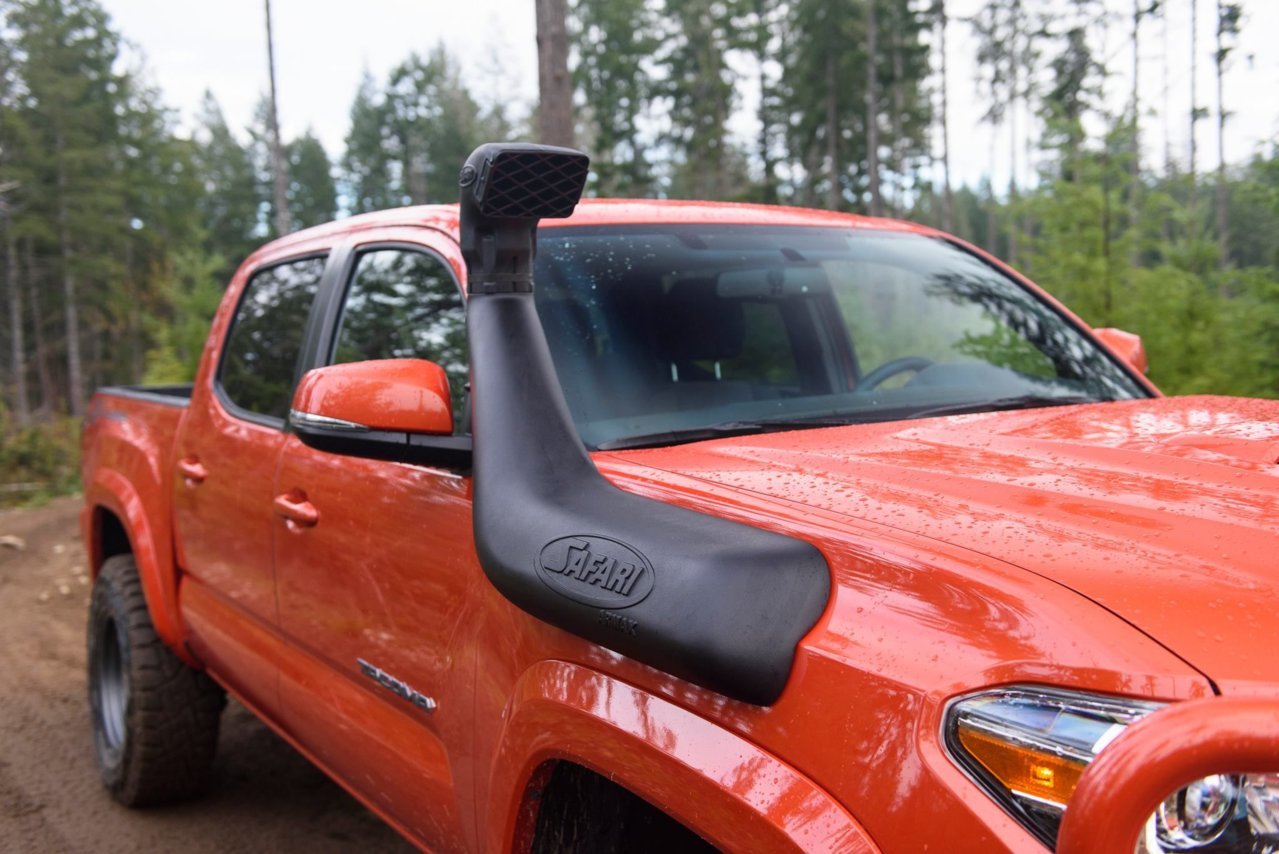

    Installed a safari snorkel on a friends truck last weekend, extremely well made and installs easy but my god its big.
    Dobinsons has a shit template so your going to end up misdrilling holes in your truck...no bueno

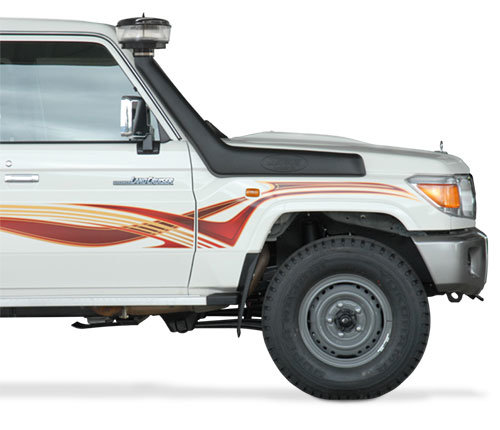

    TRD is the sleekest of the bunch but is not available for sale at the moment and is far too tall.

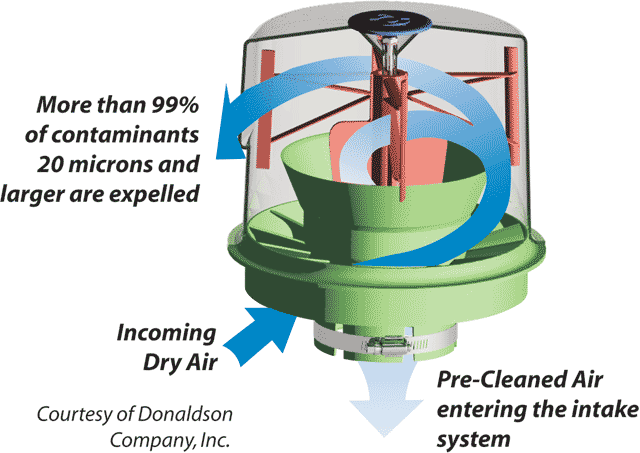

    Snorkels are good on 3rd gens if you do a lot of water crossings or go 35s and need to cut up your fender wells. They are NOT a dust shield.
    The TRD "snorkels" arent dust intakes or anything and theyre not snorkels. They are a waste and dont waste your money on it.
    They do have Snorkel hats that are for dust. If you ever see a round one on top, it has a centrifuge like effect and filters large dust particles out before the air goes into your intake. This is the ugliest one you can get, but the most useful.
