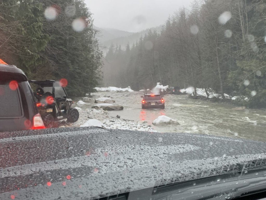

    I mean snorkel or not, i wouldnt recommend going deeper then bottom of your doors. Most guys are not even comfortable going past the hubs.
    Just look how low the alternator sits and think about all the electronics in your truck. its not like its a 80 series diesel landcruiser.
    I did this water crossing and it was very scary. I made it but never again will i go so deep again. I did not extend my diff breathers, had no issues.
    I do some minor water crossings here and there but the water is never higher then the bottom of my doors.

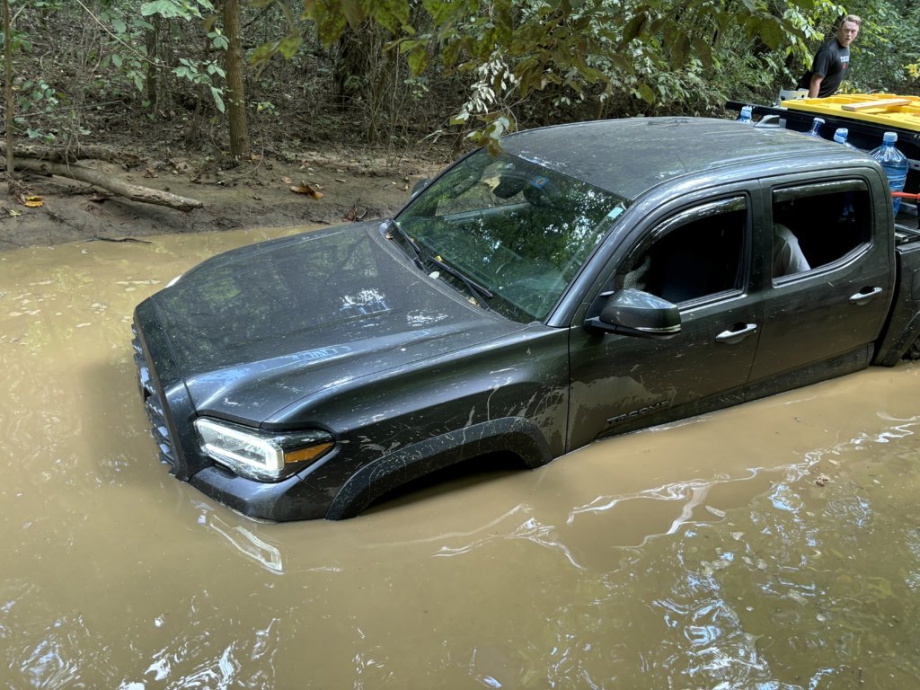

    Last August I missed the ruts in a long muddy hole. water just over top of tires. bottomed out due to the ruts. Wasn’t prepared. Had to wait for help and left truck running as exhaust was under water also. Replaced alternator on the trail, starter and fan clutch after returned home. Spent 3 more days wheeling after incident. Spent 2 weeks removing seats, carpet, and pad to get all cleaned. I now have winch and full set of recovery gear. Holes are now more thoroughly checked. Just looking for extra insurance if I do something dumb again.

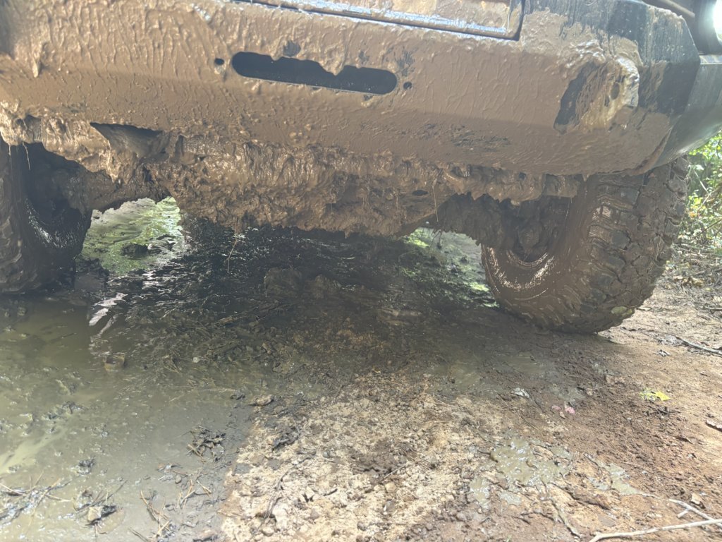

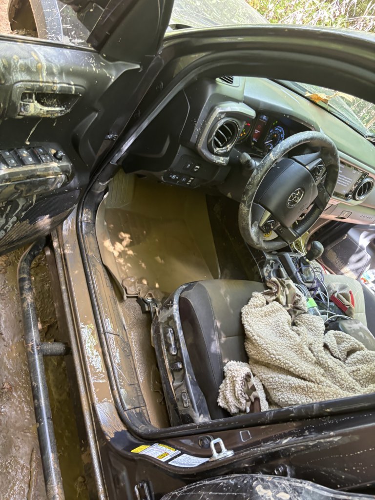

    IMG_4280.jpg IMG_4013.jpg IMG_4018.jpg IMG_4021.jpg 33” pizza cutters are what I have. lol.
    The “dry” picture is 2 months later and 1000 miles away. Winch installed so it doesn’t sit there running 45 minutes waiting on help.
    Been 7,000 miles since. All systems work properly
