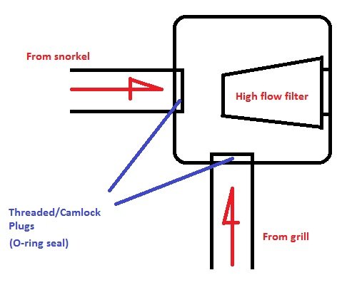

    A supercharger is the first big mod I'm planning on doing for my truck, but I know I will need a snorkel eventually for any major offroading here. I live in an area where the mountains stick straight up out of the swamps, so all the run off is in the trails.
    Has anyone tried routing two pipes from the airbox? Let the snorkel in from the side and the regular intake from either in front of the radiator or from the wheel well? You could just get a waterproof cap or something to plug off one intake or the other for performance or snorkel and both would be run outside to cool air.

    I am building truck for racing right now. It will have new Hilux body (European) but the frame and engine with TRD supercharger is from Tacoma.
    Racing conditions in my coutry force me to use snorkel - so I plan to put snorkel like those that are used in Dakar Hiluxes:
    like this:
    http://www.forumsamochodowe.pl/gale...13-zespol-malysz-marton-11-p13231.htm#zdjecie
    those Dakar Trucks uses 4.6 V8 - 340HP engines, so I hope that the air flow will be also sufficient for 4.0 V6 with sc.

    Alright, well it is on and it does not work. LOL that is just to confuse the people that only read one sentence and think they found the gospel online. So it does not work BECAUSE I have a pinched snorkel tube......but I know I have a great sealed system, because just revving it up the AFE airbox collapses in on itself. So I took the lid off and holy shit does it run! Love the power. Put the lid back on and pulled the red plug at the bottom of AFE airbox I had sealed in place and it runs great. So I need to take the snorkel off and do some more modding to the connection of the snorkel to the air box.......or just go back to the factory intake and run with that. But there is no reason to have a snorkel and a closed box intake to have great cold air and then just drive around with the lid off so it gets nothing but hot air from the engine bay. But yes, the supercharger makes a huge difference in power! Can't decide if I even want to go to 4.56's or not now.

    did you use the dual intake airbox design that was posted previously?

    No, mine was the safari snorkel mated directly to AFE stage 2 intake box and sealed up completely. It was completely sealed.
