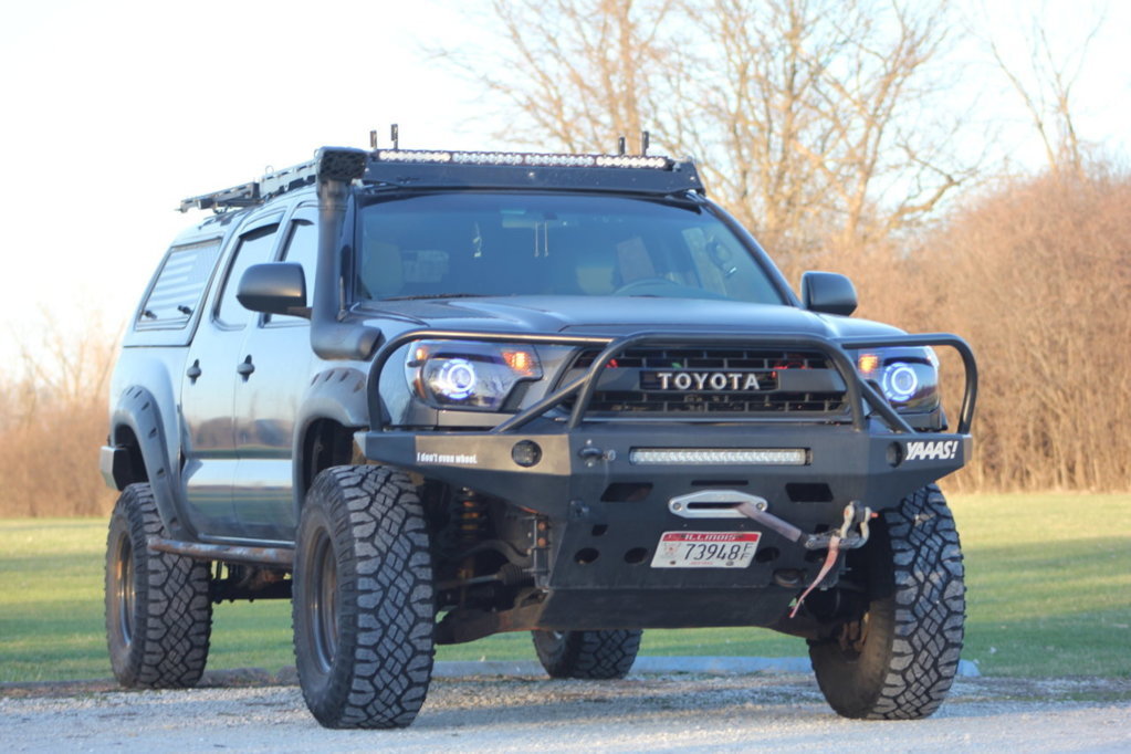

    Pelfreybilt front/rear, RCI underneath, Morimoto Headlights, Prinsu racks, SCS Brushed Copper Ray 10's, EO Sliders, Baja Designs and Rigid lights, Inca 4x4 Camper
    I have Airflow. It's the lowest profile of the bunch.
    I've had it for maybe 4 years I absolutely love it.

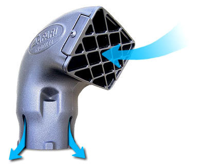

    The head uses the venturi affect to direct water out of the inlet. Works similar to an air ejector. If a little makes it through, the filter may get damp but after a while, enough air passing through should dry it out. Driving in the snow is really what kills them since it will clog the intake, then eventually melt and makes its way down there. I usually reverse the head when it's supposed to snow.
