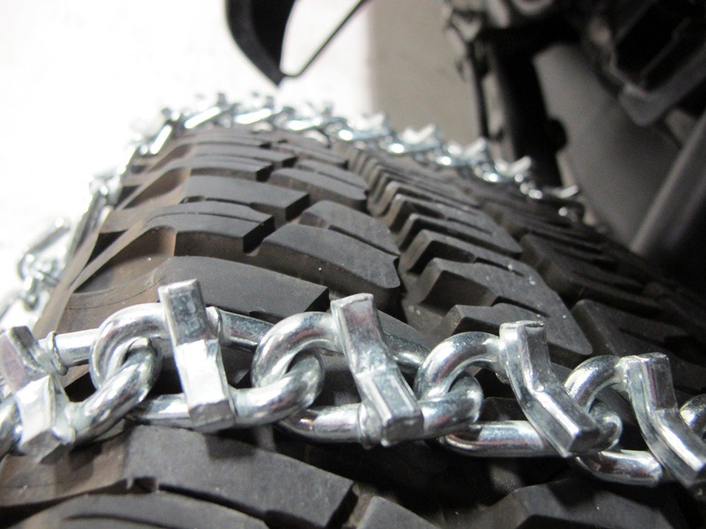

    If you are looking for off-highway chains, I reccomend something with a v bar. I use mine for getting to ice climbing and skiing spots in deep snow, and they work great. Probably a bit much if you want them on road. This isn’t my picture, but that is the idea.

    V bar and other such heavy duty chains are great at very slow speeds on frozen/ sloppy surfaces. They suck at higher speeds on hard (on road) surfaces. If you want highway chains for driving on the road in snow and ice, go with cable chains. I have a lot of experience with both.

    I have 4x4 and have never needed chains in all my snow skiing adventures.... that stated i ALWAYS carry some GNARLY vbar chains like above just in case shit really hits the fan, definitely would not want to use them full time on a 2wd vehicle that is just on icy roads though.
    My vote is for cable "chains" and stick to the icy / light snow pavement if 2wd.

    On roads in light to moderate snow stay with cables. They are cheaper, easier to use and work fine. Chains work better in off road situations or really deep snow and mud. Also keep in mind, most modern vehicles don't have enough clearance to run chains without them hitting sheet metal or suspension components. Cables will usually work. If you're going to run aggressive chains you may need to go to a skinny tire, or add wheel spacers.
    On fairly level terrain with good tires, especially with front wheel drive there is probably no need for chains or cables. And all snow isn't the same. If you're in an area where it truly gets cold and the snow stays frozen it is relatively easy. Here in GA we don't get a lot of snow, but they don't clear it off most of the roads either. Only enough equipment to clear interstates and main highways. Where I live we are on our own and there are a lot of steep hills and mountains so chains or cables are a good idea. Or just stay at home. It usually melts within 24-48 hours. Also since it normally warms up above freezing during most days, and drops below freezing at night the snow goes through melt/refreeze cycles and ends up being more ice than snow.

    Could not agree more. The snow out here on the west coast doesn’t even come close to the wet snow on the east. And nobody should be on a hwy with bar chains. Your just asking for trouble.
