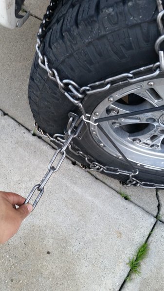

    I'm test fitting my chains and there is some extra chain dangling after I tighten everything down. What should I do with that slack so it does not damage anything? I was thinking about zip tying it down?

    C link or whatever they are called. They look like a c that has a long nut that completes the link.

    I'd cut the excess slack... But that's just me...

    Chains come long so the fit a wider range of tires. Like the tag that says these chains fit these 10 different tire sizes on the front of the box. You should get some bolt cutters and cut off the extra bit of chain. It's good that you test fit them before you were in the snow on the side of the road trying to figure out what to do. Just cut the end to the length needed. You DO NOT want to drive with it still on there unless you really don't like your fenders. Do not leave excess chain on there.

    You see the guys at the chain up areas that install chains carrying around bolt cutters just for that reason.

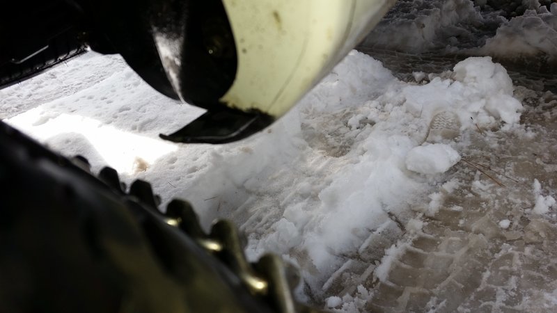

    I wasn't sure when to stop and check the chains for tightness. Luckily my fender flares were nice enough to let me know lol

    Yup that Wackety Wack sounds says it all.

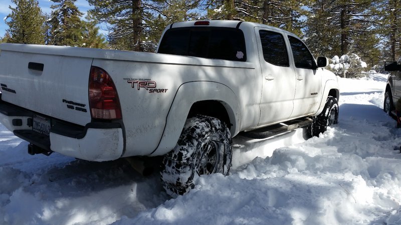

    The chains did great! I was even able to come to a complete stop half way up an icy hill. I was able to keep going no problem. Thank you to everyone for the info.

    I use wire to secure the extra chain.
    You might be able to secure it with the hook on the chain tightener.
