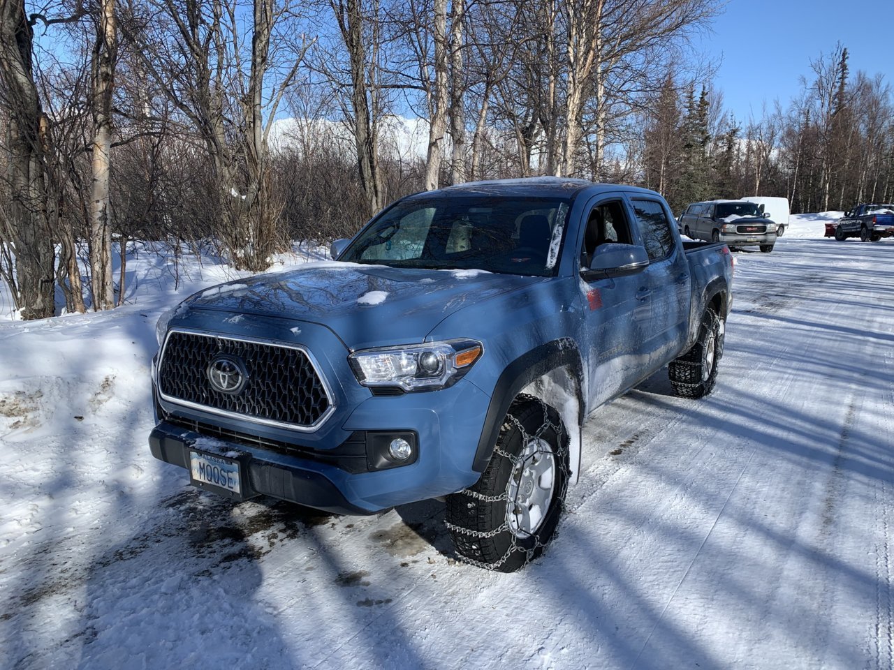

    I run chains off road only getting out to my buddy's cabin. I've run them on stock 2nd gen rims with P245/75/16 Blizzak tires with no issues. This year I intend to run them on GY Wrangler Duratracs size LT235/85/16. Comparing the P245/75/16 to LT235/85/16, conceptually I believe it will work. Clearance with the front suspension towers is close, but they do clear. I would NOT run this set up high speed. I'm generally running less than 10 mph. Chains definitely make a huge difference. That's all I can tell you from my experience. Check my "Shack" thread (link in sig) for pics of my truck with chains mounted. I'll post pics of the new tires with chains and performance report after the snow flies later this year, albeit all too soon.

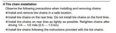

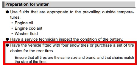

    My manual says you SHOULD add chains on the rear. I'm in a '17 OR, is that somehow different than the others whose manual says not to use chains?

    I think they clarified that you're not supposed to run chains on the front tires due to potential clearance issues with the UCAs and wheel wells. If you're lifted, have spacers, larger tires, or otherwise modded the front tire and suspension setup, then you need to check the clearance yourself to verify they don't rub anything.
    my understanding was that chains on the rear are pretty fine no matter what, since there's much more space back there, plus you're supposed to put chains on the drive axle. I've seen plenty of Tacos in the winter using chains.

    Here's one at trailhead Mar 2021. That's on Blizzaks P245/75/R16. I have the Duratracs LT235/85/R16 bought and in my shed; I plan to have them mounted in Sep and adjust my chains to fit.

    Testfitted the front driver's side. I need to remove one link, that's the "clink" you hear. Clearance is close, proceed at your own risk. I only do this at extremely slow speed off road. You will hear an occassional clink in motion off road which is the chain barely contacting the UCA. It's never been a repetitive "clink-clink-clink". I'll report back when their use becomes necessary.

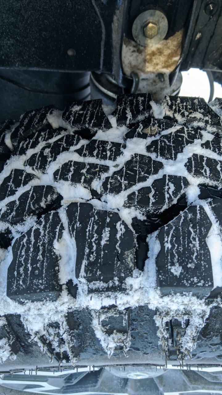

    Do you have any pictures of the siping you mention? Is it extra siping beyond what comes on them already?
  15. Nov 10, 2022 at 3:23 PM
    #35
    DuffyBank
    DuffyBank Well-Known Member
    Sep 24, 2021
    #377978
    1,492
    I have the tire shop do it when I buy them. Lots of extra grooves cut in.

    I watched that video. I remain skeptical that aftermarket siping has advantages over an OEM tire. Tire manufacturers have much bigger budgets and smarter engineers. The only doubt I have in my head is why there isn’t an obvious off-road snow tire on the market. Dedicated snow ties seem designed for the road and mud terrains seem designed for summer. There may be too little market for a off-road snow tire. In my area, winter is snowmobile season.
