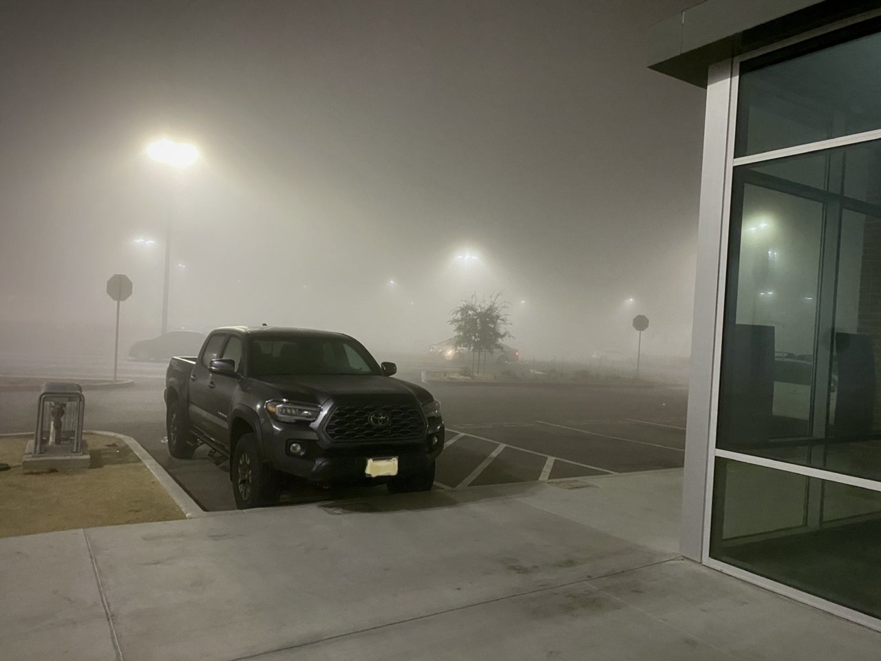

    E8CBF981-078D-4718-B01E-2ADD3C61455D.jpg I have a 2021 TRD 4X4 Off Road Tacoma.
    I want to go to the snow but I’m not sure if I need snow chains .
    Big Bear requires all vehicles to carry snow chains during the winter months.
    my truck is stock. What kind of chains would I need and what size ?
    This is a dumb question but I’m new to owning a 4X4. Someone told me I should drive my truck in 4X4 mode once a month for 10 miles in 4 high . Do I do this . Also how fast can I go? And do I only go straight with out turning?
    Thanks in Advance
