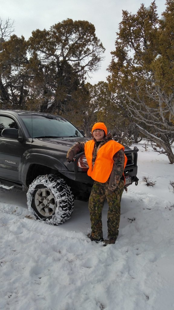

    I've had 4 2nd gen tacomas since late 2004 and still have a 2015 today. I've ran "off road" snow chains on all 4 tires for mostly hunting seasons in mountains and if we get a 2+ footer in town. The off road jeep roads are iffy when wet, muddy, and/or snow of several inches and that's when the off road chains are a lifesaver. Sometimes skinny mountains dirt roads off the path of the main dirt roads are hellish scary with just good off road tires on a skinny hillside jeep road. It's even scarier if the snow, mud is mushy. I've driven around stuck people in trucks off road stuck with my chains while they grabbed their shovels and I know the thick heavy duty off road mud/snow chains have gotten me in/out of some snotty, snowy areas during hunting seasons or maybe woulda slide off the hills (one side is up the mountain and the other side is down a long way). Now for on hwy use, you could get away with some cables or smaller chain designs and those are great, but for off road, they need to be bigger chain links and sit on top of the tire treads (if half the links go down into/tween treads, loses effectiveness). For hwy you could go with 3 tires that have stud options, one is a tough heavy tire cooper st maxx with studs if allowed in your state. Another is the good year duratrac with studs, another is general grabber atx with studs. These 3 are all all terrain tires that are good for minor snow and ice, but with studs on these in packed down hwy snow and icy roads, they work great. Issues are 1)can you run them year round in your state 2)studded tires are a little less in stopping and hard cornering on dry or wet hwy conditions. I've run the cooper and now the general studded here in CO and the general atx was $400 cheaper. I think the cooper st maxx with studs is a tougher off road tire than the general. Cooper maxx rides a little rougher but after 50k on them, they are decent and tougher. The general atx studded I've only had this past winter and they seem a little softer but ride ok. I've had bfg k02's and they are ok and ride good, but wanted a studded all terrain tire and the 3 studded tires I'd rather have than a non studded or having to swap/spend for winter tires. My studded tires easily can go 10-15 mph on packed snowy hwy roads that when I just ran non studded all terrains and the stopping and going and turns is better confidence. Off road over the past 20 years, my big chains keep me going, then can stop, then keep going. Thats the diff if you stop on a downhill or uphill thats frozen or muddy, snowy or all these, the off road or studded tires help a lot. I'd never trust my studded tires to replace my chains off road when the roads might be really bad tho. Yes chains suck butt to put on and you need a tarp and lay the chains out right by the tire, put some 2x4 blocks in tween the chains and then drive up on 2x4 blocks so can install them tight during install and use tensioners. I like to fit my chains on new tires, then cut off all the extra links (they just swing around and tear fenders/suspension stuff up). I prefer the cam type but that's me. All 2nd gen taco's and assume 3rd/4th gen, you need rims on front that give 1 inch tween sidewall of top tire and steering stuff (usually UCA). If you reach behind the front top of tire and run your hand back and forth, you likely can't fit a finger thickness tween uca and sidwall on back side of tire at top. Thats why I don't like keeping an extra 3-6 links to bang into stuff.328128806_501051715527496_10296338283303_92a00e61d5953b6b98847a2024a8a2c235facb51.jpg409837115_7128540707203989_8170327548617_9143c04e0f7fadc573e556cdf4998b8d59604dcd.jpg
