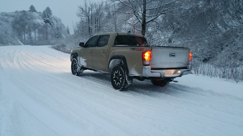

    TacoFister
    TacoFister Well-Known Member
    Mar 6, 2016
    #180420
    974
    Josh
    2016 QS TRD 4x4 Off Road
    TOMRR, CedarPark, FFBlack and 2 others like this.
  13. Dec 14, 2016 at 9:41 PM
    #33
    OZ-T
    OZ-T I hate my neighbour
    Dec 15, 2009
    #27584
    50,587
    Peter North
    British Columbia
    Are you on ice in that first video ?
    Hairy Taco likes this.
  14. Dec 14, 2016 at 9:45 PM
    #34
    TacoFister
    Mar 6, 2016
    #180420
    974
    Josh
    No. Just freezing rain on the snow. I was sliding around using the pedal. Crawl helps to quickly fixes slipping of the rear. Just testing it out
