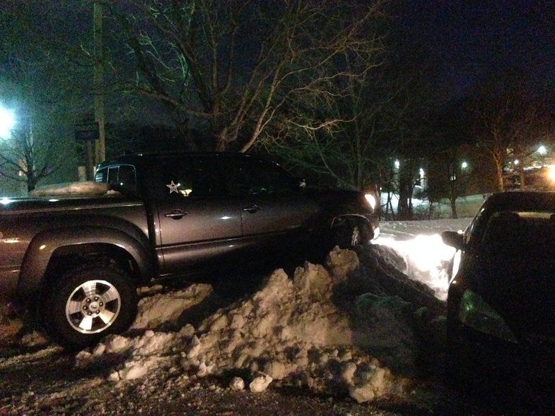

    This blizzard has been my first opportunity to get my 2007 TRD Off Road Taco in the snow. I must say this first, I feel like my 2008 Frontier did better in big snow, when I had it. I don't know how that's even possible. My Tacoma is supposed to be a more capable vehicle. I didn't have the locker in my Frontier either, but I do in the Tacoma. Long story short: I had to pay a backhoe to pull me out of my own driveway. We broke several straps as my friend tried to pull me out in a 2004 Silverado, before the backhoe drove by and let me hire him. At one point, with the locker on, the truck just sat and rumbled. All the while, the left front wheel sat limp as the right front smoked itself against the blacktop driveway I had cleared. Is there something wrong with this truck? I'm gonna jack it up and check the A.D.D. system when some of the snow is gone. Has anyone else gotten stuck and this happened? That left front is ticking me off, because I don't feel like the truck was in such a bad spot, that the 4wd couldn't have got me out.

    Tires make all the difference. Pull of the old ones and sell them on craigslist to subsidize the new ones. Doesn't matter how good your 4wd is if tires cannot get the traction to the ground.

    Nothing is wrong with your truck. Your tires suck.
    Swap them out and sell them to someone who wants them while they're still 'meaty'. It'll help offset some of the cost of your new tires. I'm sure you could sell them on here to someone who does just highway stuff, or on your local Craig's List.
    A good set of tires is the difference b/w your truck sucking and it doing stellar.

    ummmm.... if you were breaking straps trying to get it out of there maybe you were high centred and frozen in place? Pictures next time.
    Tires make all the difference in the world but if you were breaking recovery straps (though maybe the straps were shit) I'm not sure tires would have done the job.
    As for the front wheel spinning freely while the other one didnt budge, thats just because you don't have a front locker. Neither did your Frontier. 99% of people don't have front lockers.

    You know how an open diff works? If one tire is spinning freely under power the other one doesn't.
