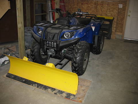

    At my last house, we used the setup below on our Yamaha 450. It was a moose brand quick connect & used the winch & if I remember correctly the blade itself had some adjustments. Our driveway was pretty long/wide but you definately had to prepare for where to put the snow. We did not run chains either for the area was mostly flat & didn't want to tear up the ground. It worked really well for the price. Yamaha was offering them free with the purchase at the time.
