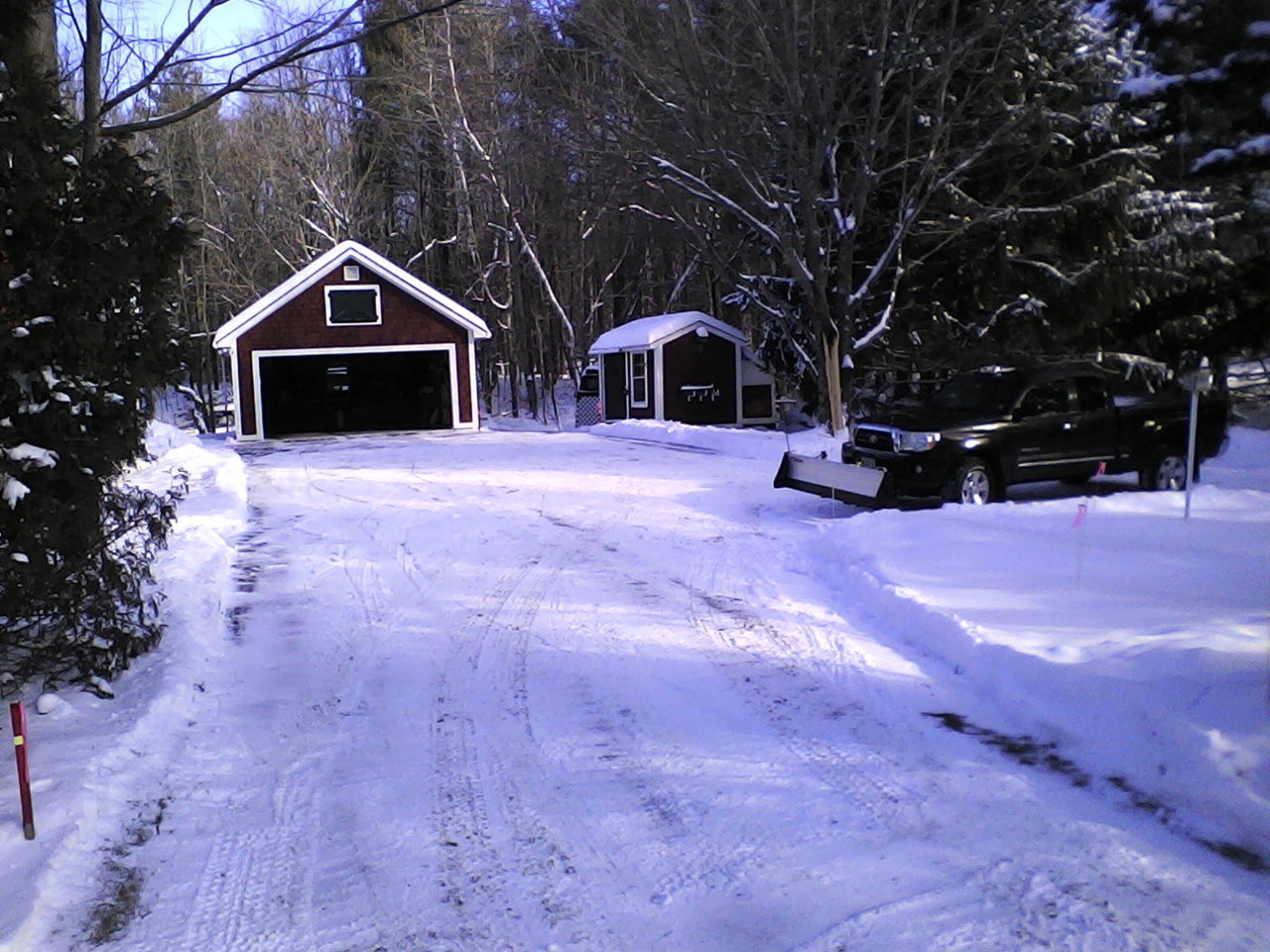

    For those experienced with plowing with older 2.7L Tacomas (mine is a 2008 5-speed) I would be interested in knowing what if any special precautions/recommendations you may suggest for plowing with trucks like this that don't have dashboard traction control features (Auto LSD, VSC, Stability Control, etc.) like the newer trucks. Mine has nothing but the H2/H4/H4L 4WD control on the dash, which I assume means it has mechanical LSD (it does get less power in 4WD or when making sharp turns so I suspect there is brake-assist occurring via the LSD). It'll be lightly used with a 200# plow (blade, mounting plate, hitch mount...Snowsport HD) and only at home, so I don't anticipate any major effects on the truck. But, I also suspect there may be some plowing tricks (technique, adjustments, do's-don'ts) that could make plowing easier. Any tips are appreciated.

    IMG_20201218_103031_1.jpg Plow and truck work pretty good...

    Thanks Clearwater I appreciate the feedback. I realized the thread was older but for those considering buying a plow for their Tacomas I thought threads like this one would be a good reference source...some folks will look for even older threads if it might have info they can use (I know I did before buying mine). The Snowsport website needs to have available more user vids from actual owners of their plows...the vids they have on the site are good for installation purposes but pretty weak from a 'user/buyer interest' standpoint. They'd sell more plows with a little more marketing effort in the way of more video footage from actual users. Anyway, overall I'm pretty satisfied with my truck/plow combo for what I plan to do with it. It's not for heavy wet snow moving or commercial applications but for normal powder snow on small to medium lots it'll do fine.
    And no, you don't need to put a winch on it to get good performance. It works just fine the way it is and there's no worries about messing up your truck's electrical system or maintaining any complicated hydraulics.
