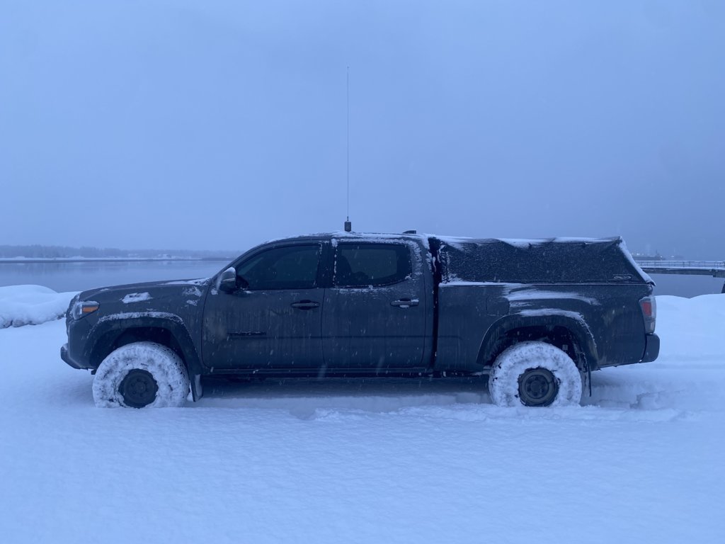

    Duratrac 265/75/16 studded & sipped. & yes today.. ha

    Prob the best snow tire setup
