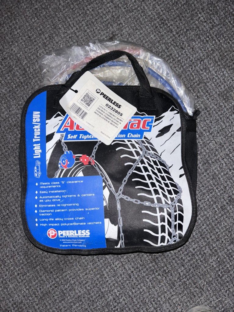

    Chains won’t really help with deep snow, but with ice, I’ve used peerless auto chains.
    They are pretty easy to put on, and work great.
    I actually have a set I can’t use anymore, and would sell them. I am on the west coast though.
    Peerless 0232805
    They basically fit any 32-33” tire.
