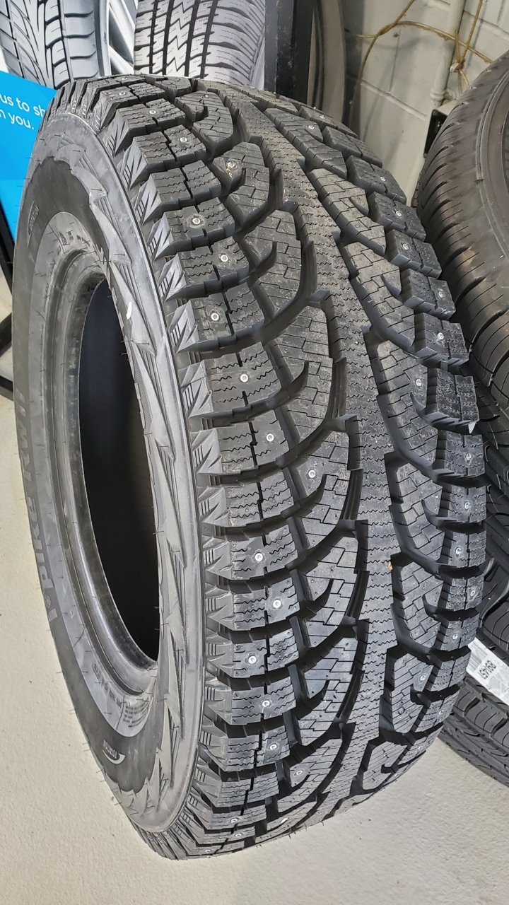

    I ran artic grabbers last year and wasn't impressed . I sold them in the summer and just picked up a set of ipikes studded .. I didn't have the grabbers studded which I regerted. I use ko2 during the off season .

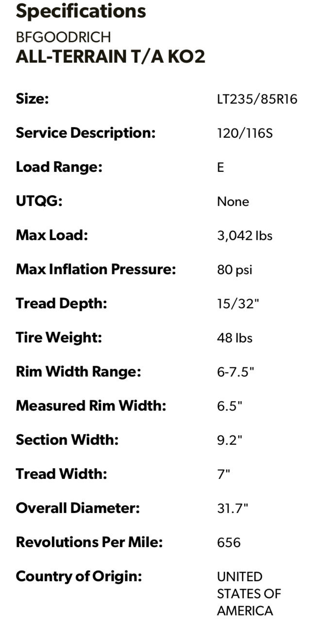

    I agree with you, but I don’t think you can get tall skinny K02, but I could be wrong. Pretty sure 265’s are the narrowest version, which are the ones I have.

    Here you go....

    There is a balance in width that needs to be had to make an effective tire on slick surfaces. Too narrow and you don’t have enough surface area to actually gain traction(think ice skates). Too wide and you don’t have enough ground pressure to gain traction.
    I think tread pattern would come into play long before width. Winter tires work by collecting snow in the tread and it then sticks to the slick surface. Not arguing your logic or experience but just pointing out that we can’t really use generalities when talking winter driving because there are so many variations of tires.
