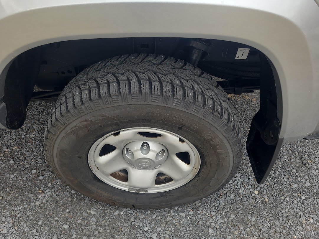

    For what it's worth the speedo reads high with the factory size tires and going to a slightly larger diameter tire will actually improve its accuracy. My SR5 had 245/75R16's from the factory and the speedo was off 2 or 3 mph at 75 mph. Threw a set of 265/75R16's on when I got them on a set of factory steel wheels and my speedo was spot on then. When I put my 265/70R17's on the speedo reads a little low but more accurate than stock. I'm running studded 265/70R16 Toyo G3's on stock steelies but we've literally gotten no snow here yet. IMG_20230114_122216.jpg
