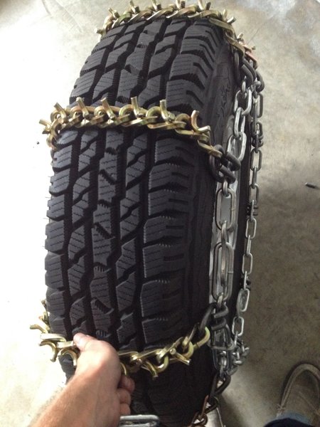

  5. Oct 21, 2015 at 1:31 PM
    #25
    Nickel
    Nickel Well-Known Member
    Nov 22, 2012
    #91659
    1,345
    Diego
    Rio Rancho New Mexico
    2013 T/X TRD
    does turning tires to black wall out count? How bout added snug top rebel.
    image.jpg The product you linked in first post would probably work for short distances, but I would not drive on them for any length of time. I can't imagine that plastic being stronger than metal chains, and I've stretched and or broken dozens of sets of chains.
    You posted this in the third GEN section, so I'm not sure if you have a third GEN or not, but on my second GEN I would only be able to run chains in the rear because the chain would interfere in the front with the upper control arm. I'm not sure what the third Gen looks like.
    These are hands down the best and easiest chains to install for any extended length of running time, I have thousands of miles on these style chain, they've never let me down.http://www.pewagchain.com/Products/Snow-chains/4x4-und-SUV/pewag-mud-service.aspx
    If you notice there are multiple cams to get the correct tension on the chain, also they say mud chains because you can use them in mud also.

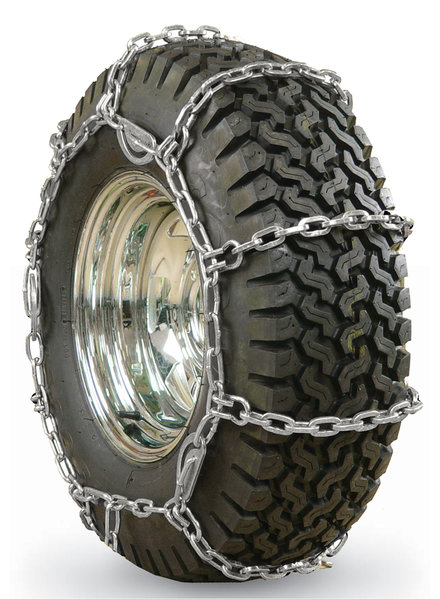

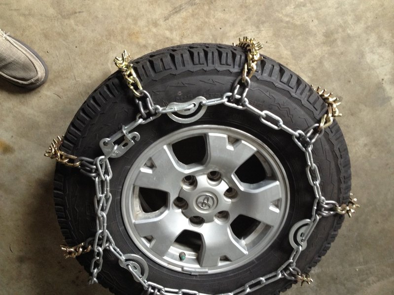

  7. Oct 21, 2015 at 4:46 PM
    #27
    neverstuck
    neverstuck Well-Known Member
    Sep 7, 2009
    #22406
    2,605
    Guido
    Lebanon
    13 DCLB sport
    slide-in camper, OME Nitros w 884's and Dakars, Michelin A/T2, Pro EFX heated towing mirrors, Timbren HD bumpstops, KB VooDoo bed rails and tailgate cap, ImMrYo rvm bracket, G-Tek Fab door sill protectors, Ultragauge, window visors, hood deflector, Wet Okole seatcovers, in-vehicle safe.
    If you're going to do it, do it right.

    Thanks for the link to a good set of chains--I've been warned about cheap ones breaking. If I decide to get chains these are probably what I'll get. One note: the product I provided the link to is made of urethane rubber, not plastic. I do have a 3rd generation, and I measure only an inch clearance at best for the front tires, so I doubt these chains, or any chains, would work on the front.
  10. Oct 21, 2015 at 9:17 PM
    #30
    Aspie83
    Aspie83 [OP] Well-Known Member
    Aug 28, 2015
    #162899
    208
    2016 OR AC MGM
    Holy shit, are these legal?
  11. Oct 21, 2015 at 10:33 PM
    #31
    BlueT
    BlueT Well-Known Member
    Mar 30, 2009
    #15341
    5,615
    NorthEast
    07 Dbl Cab LB with LSD
    I moded 1999 Taco so much it had turned to Land Cruiser
    Are those rear tires or front?
  12. Oct 22, 2015 at 2:05 AM
    #32
    neverstuck
    Sep 7, 2009
    #22406
    2,605
    Guido
    Lebanon
    13 DCLB sport
    Definitely rear tire chains. I'd rip the shit out of my wheel wells in the front. With the 235's though and some 1.25" spacers I have clearance for regular chains up front.
  13. Oct 22, 2015 at 2:08 AM
    #33
    neverstuck
    Sep 7, 2009
    #22406
    2,605
    Guido
    Lebanon
    13 DCLB sport
    haha. They're intended for off-road use and would definitely be overkill on any road I've ever driven on plowed or otherwise. You're definitely not going to break one of these 5/16" links spinning on a rock.
