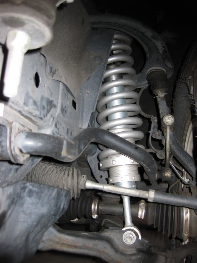

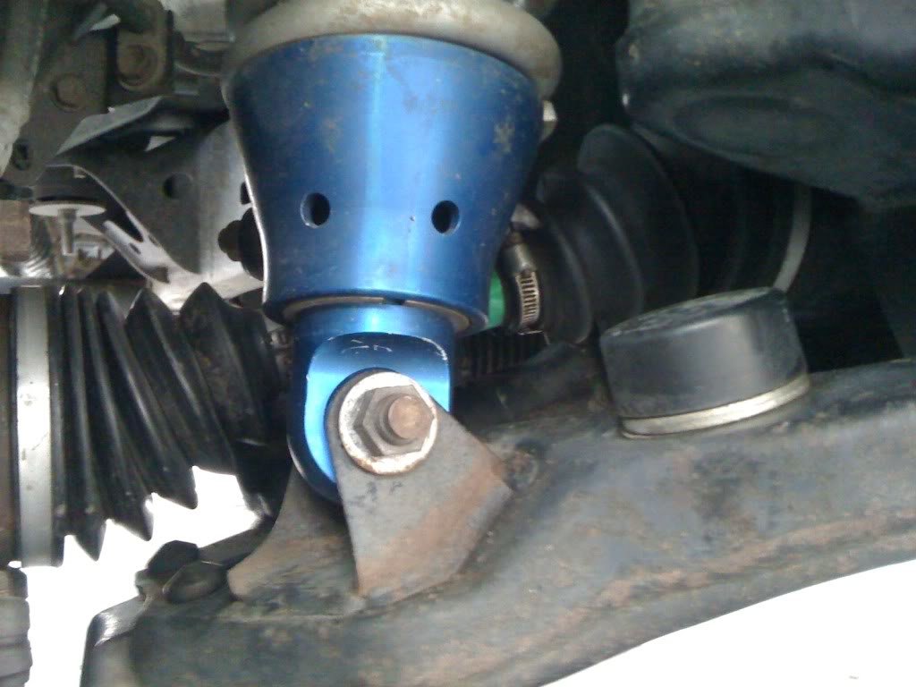

    Hey Steven, you set your fronts to 2.5 correct? What are your front measurements now (from ground up to the bottom of the fender over the hub...ground to fender is what I'm looking for since the height of our tires is essentially the same anyway). I have the measurements for stock, .85, and 1.75, but no idea what they are for the 2.5 setting.
    I put my diff drop back in last week and my vibe decreased (barely noticeable now). So I'm guessing when I go to 1.75 and add the toytec spacer I just got for the taco lean (mine's down almost a whole inch on the driver's side and it's quite visible) that my cv axle in the needle bearing is going to scream at me (and I hope it's not the needle bearing again). I'm hesitant on raising it up but I guess I should do that first and then deal with replacing the axle afterwards. I'd like to raise it up before June 4, and I'm wondering what the height is at 2.5 before I commit to 1.75. I want to keep some rake because of my tonneau and the sandbags I carry back there all winter...then there's the firewood I haul throughout the summer. I'm pretty sure I'm sticking with 1.75, but curious on the 2.5 height.

    Hey Jim, two things.
    First, you should measure from the center hub to bottom of fender. Regardless of tire size, that will always be consistent and the best way to measure ride height.
    Second, I think you've overthinking the whole CV issue. My CV's hate me. I don't mean you're average hatred. No sir. I mean like elephant dick, pound in the ass, no reach-around, jungle fucking hatred. I've got cv boot fins quite litterally wearing a circular hole out in the boots.
    1st gen's are way worse on CV angles and I have my front coils set pretty high (~3 inches). It gives me a very slight reverse rake (AKA bro lean) with my long travel out back.
    On the other hand, this is my wife's 4th gen 4runner (which in terms of geometry is nearly identical to the second gen). It's also set at 3" and I installed the diff drop. Looking at just the CV angles, you can't even tell the damn thing is lifted.
    I did a 3" spacer lift on my friends 2nd gen with a AAL in the rear and he has a slight normal rake. At 2.5 up front, you're going to be damn near level. If you want to add a bit more rake to it, you can throw in a wheelers AAL for less than $80.
    When's the last time you had your tires balanced?

    No, this stems from a problem I had when I first added the 5100s last year (I added a Wheeler's AAL at that time too). It's not the tires nor is it any other vibe. The 2nd gens have problems with the driver's side needle roller bearing inside the front diff. It's similar to the TSB for the Tundras for this same problem, but Toyota hasn't issued a TSB for the Taco (I see nothing...I see nothing!). There are close to 2 or 3 dozen people on the forums that have had their front diff's replaced...sometimes more than once. If the vibe/grinding goes away flipping the 4wd switch, then it's this bearing (driver's side...I can explain how we know it's that side from the test if you want). Even on the Tundra's, they're failing over and over (one moderator on TN finally dumped his Tundra because he had 3 front diffs go bad within 17 months). So when I lifted mine, I discovered that my bearing was bad. Not only was it sending me the cyclical vibe indicative of this needle bearing, but it was a loud audible grinding that could be heard even if I drove by you on the road (and was louder than the radio at a moderate level). Toyota replaced my front diff in June 2010 and I've been going along just fine at .85 with a diff drop. Took the diff drop out in Jan because I figured I shouldn't need it at .85 and felt the vibe a little bit. It was getting worse over the last couple months, so last week I put it back in and the vibe is barely noticeable. The learning process on the various front diff threads is that when the needle bearing goes bad, it frequently screws up the surface of the CV Axle where it rests in the bearing. So everyone with this problem now knows that the vibe may still be there until you replace the CV Axle too. My concern is on raising it back up and putting pressure on the bearing again if it's the CV Axle being rough (or even having pits in it as some have discovered). I don't want it to destroy that needle bearing because that's a PITA to replace. A few have been able to replace the needle bearing without removing the front diff from the truck and using a puller with a fitting that they fabricated. That's way beyond me at this point (unless I learn to remove the CV Axle then maybe I'll be in a position to tackle it in the future if it becomes a problem again).
    Anyway, I need to replace the CV Axle as a precaution to avoid destroying the bearing (unless it's really the bearing going bad again but I won't know until I at least replace the CV Axle). So it's not an issue with the angles so much as causing internal damage to the bearing. This shit stresses me out!
    I think I may be raising it up this week (if I have time before company arrives next week), so I'll know then how bad it is.

    I havent measured it yet but I will...my truck just started the vibrating yesterday :eek: so im going to install diff drop this weekend hopefully that will solve it. my truck sits just about level with the fronts at 2.5 and a 1.5 aal slight rake in the back.........................I say lift it jim:D

    How bad is the vibe? Mild and only slightly noticeable when on smooth pavement? Or can you feel it even on rough pavement? If it requires smooth pavement to feel it, the diff drop should "almost" eliminate it. Good luck on the warranty aspect. Some dealerships are not caring if there's a lift because they realize it was bad before the lift occurred.

    We need to have a "fix Steven's truck" day.:D That way the rest of us can learn the process and what to do to replace that needle bearing (it's going to happen to everyone eventually anyway). And through that, I'd learn how to replace the cv axle. The bearing is less than $50, the cost is all the labor (dealerships only replace the whole front diff at a cost of $2,200). Any takers? (I know, it's asking a lot...)
    I had to take the day off today for other things, so I'm going to take the time and raise mine up to 1.75 and see how bad the grind is...
