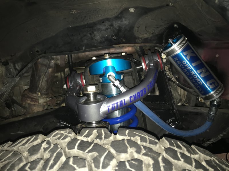

    Check Build thread
    (Most recent) E44AD5F3-A4DF-4F3B-94FA-F87F910BA0DA.jpg 99418153-4062-49D5-BE51-9037DE6EC349.jpg
    [​IMG]IMG_5353 by Austin Burton, on Flickr

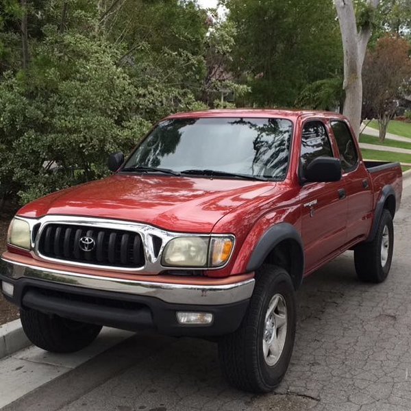

    The great adventure begun late into my junior year of high school. Saved up awhile and headed down to san diego area with @Andybear to pick her up. (3.4v6 4x4) The day I spent my hard earned savings an brought it back all stock and simple. The money pit has officially begun!:bananadance:

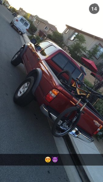

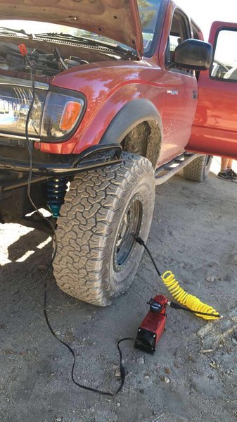

    Loaded the bike up for a quick ride:bikewhoops:

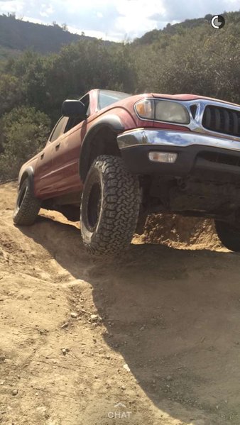

    The day the wheels/tires got thrown on.. 285/75r16 bf k02 & ultra wheels

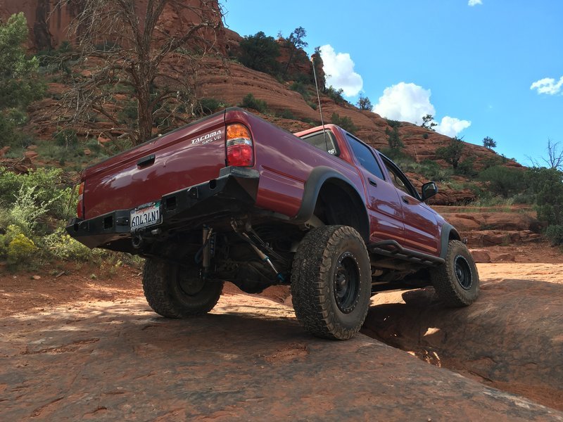

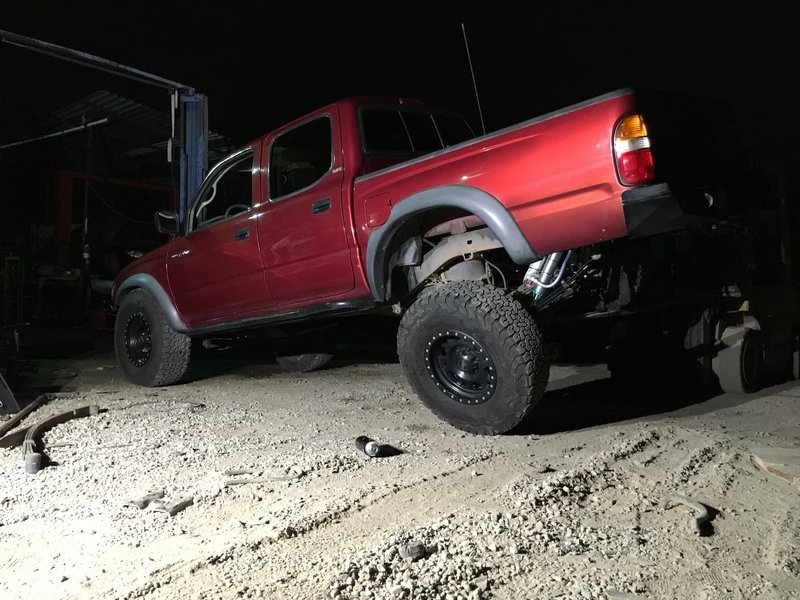

    Throwing the rear setup on.. didn't go as planned the first time an had to "re-do" it:annoyed:
    Super happy with the way it came out though!

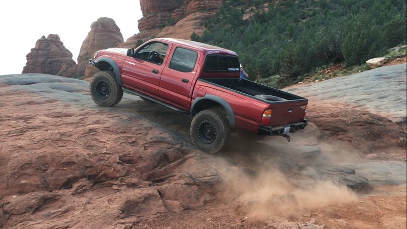

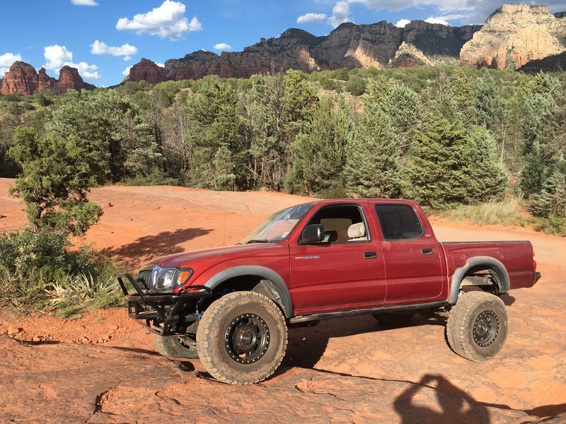

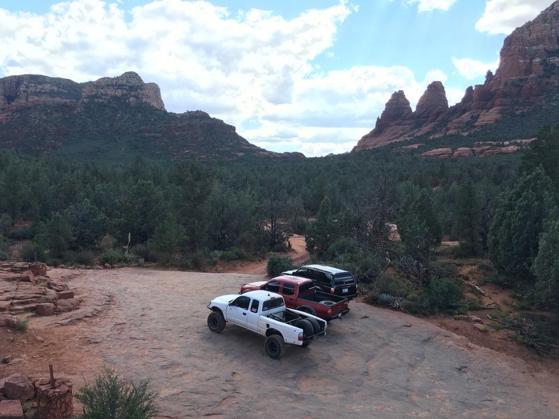

    Day trip to sedona, az. Got to test out the new rear setup and it rides NICE:bowdown::taco:

    Mods:
    Suspension etc:
    -(FRONT)
    -Total chaos uca
    -king 2.5 extended travel oem w/ resi's
    -Total chaos coil bucket gussets
    -Total chaos spindle gussets
    -Pro flow brake lines
    -1.25” spidertrax spacers
    -231” Tunda calipers & drilled/slotted rotors
    -(REAR)
    -Deaver j59 pack
    -Bamf shock relocation
    -king 2.5 10" smoothies w/ resis & clickers (for the mall of course:D:rofl:)
    -wheelers superbumps
    -u bolt flip

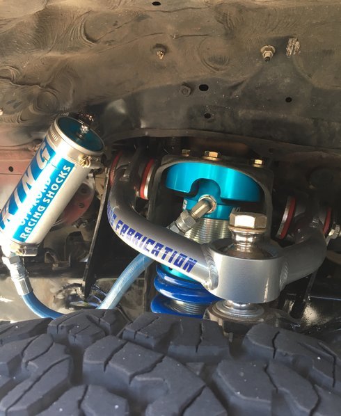

    How'd you score the King coilovers with resis? I can't find that as an option for 1st gens anywhere!

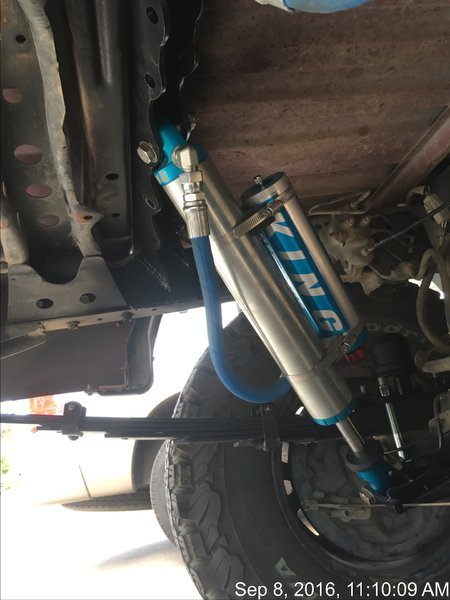

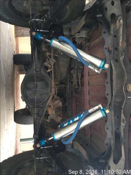

    Yea they don't offer it on their "oem" line. I went through DSM and told micah I wanted resi's on them with a 45 degree fitting from the hose to the resi, and angled the attachment on the shock body itself at a 45 degree angle so I could bend them up and keep them out of the way.. (also a mall crawler factor:rofl:). If mounted horizontal I believe at full bump/turn I would hit the rest with my tire and knock it off
    Hopefully that made sense, a picture would describe everything better :annoyed::anonymous:
    eccracer104[QUOTED] likes this.
    This should explain better:thumbsup:

    Nope, it all made perfect sense. I'm just :jellydance:haha. I actually asked King directly but they told me it would be way to expensive to have a set made with resi so I dropped the idea for Madison's truck. DSM sounds like a great option though. Always hear great things about them for suspension, and they hooked us up with a rebuild kit when we were in a pinch.

    Yea it really wasn't too much more.. after doing some research on shock fade I definitely wanted to opt for something I would be happy with for the long run and not encounter any shock fade
