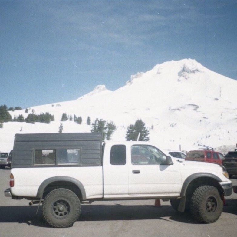

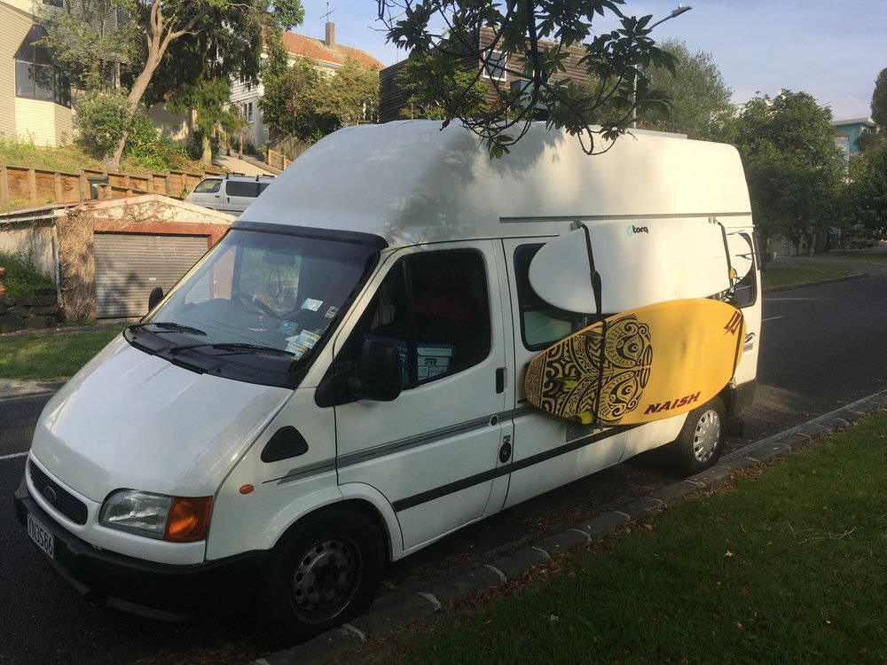

    I'm trying to figure out a good way to haul my surfboard and snowboards on my tall aluminum cap so that I can keep them on the outside when they're wet since I sleep on the inside. I'm worried the aluminum cap won't be able to handle a lot of weight or force from the boards when I'm driving at any sort of higher speeds. But more importantly I'm not sure the best way to mount them since the top of the shell is real high with the lift I have, and it would be hard to get them up and down when I'm alone. I've been thinking it would be nice to mount them on the side horizontally in front of one of the windows somehow, similar to how some people mount surfboards on the sides of sprinter vans (ie. last photo). I was thinking I could screw in some square aluminum bars into the aluminum frame of the topper and then seal the holes, but then I'm not sure how I would actually attach the boards to that, not to mention whether or not those would be strong enough. I was also thinking it might work to attach two short yakima round bars to the topper since I have some yakima button down racks already. Any ideas?

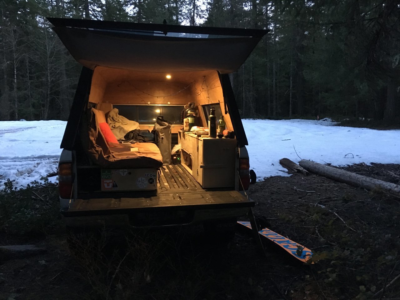

    I have a sleeping platform built now, see picture, but I'm going to be living out of my truck for most of the summer and I have a longboard that doesn't fit inside, so the surfboards at least would be nice to be on the outside.

    Simple, put some waterproof rivnuts/nutserts into the frame of the shell then you can mount a set of Surf Hooks or other brand surfboard van rack or make your own. You could mount some sections of Core-Trax for example. I'd put the Yakima bars on top and use them for the snowboards.
