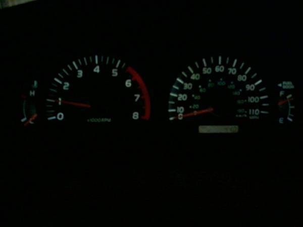

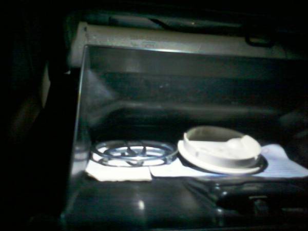

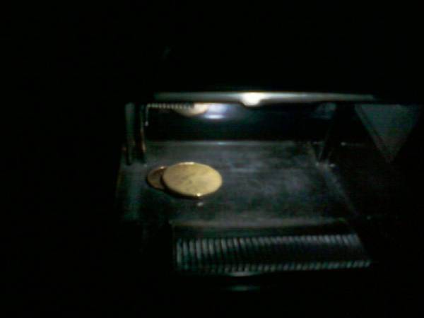

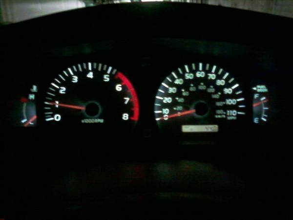

    I also did a white LED mod to my cluster using the cheapest eBay LEDs I could find. I think they turned out great! I normally run them dimmed, but I took pics of both to show the difference.
    Dim:
    Bright:
    Shifter (Dim):
    Shifter (Bright):
    Glove Box:
    Ash Tray:
    CowboyCaddy likes this.

    Looks good! What LED's did you use behind the cluster? Just a standard 194 bulb?
  15. Apr 13, 2011 at 10:00 PM
    Snowman
    Snowman [OP] I have a problem for your solution…
    Sep 8, 2010
    #42917
    3,249
    Craig
    Somewhere in Canada
    Check out my build

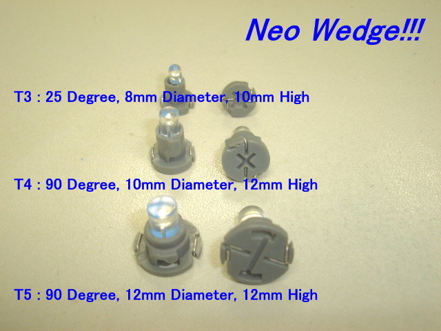

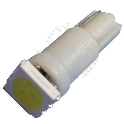

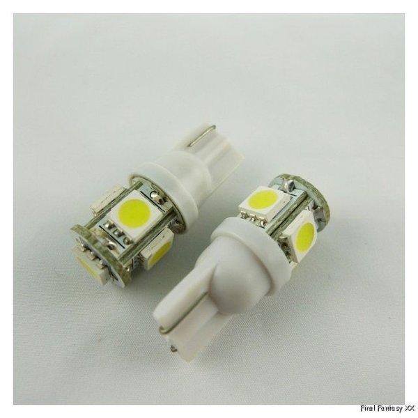

    Found the cheapest ones on eBay. Total cost was probably $10 shipped.
    194 LEDs behind the gauges:
    T4 Neo Wedge behind the temp control. Which didnt really work because the faceplate is painted orange inside. (The middle 10mm ones)
    And 74 LEDs for the shifter, ashtray and glovebox.

    Nice, i just wasnt sure if it was basically a normal 194 bulb with LED's or a special 194, Thanks. The white didnt show through the temp control plate? I scraped a good bit of the orange off the back of mine so they look almost white now, so maybe it will be a little brighter.

    It shows through, just still orangey. The LEDs are far brighter than the oem bulbs.
