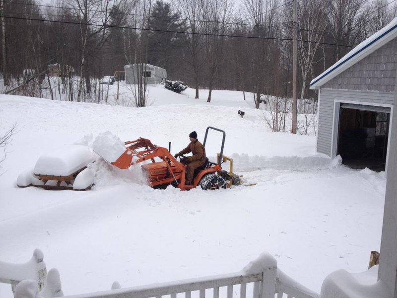

    Having cleared snow with a tractor, a truck does it much faster. Can't stack it as high, but it takes a lot less time.
    A big storm used to take me around 2-3 hours with the Kubota:
    Takes 30 minutes with the truck, and then I can always go through and stack it later with the tractor if I need to. :notsure:

    Agreed, unless you have a plow on the tractor! I liked the buckets for pushing back piles, but plows for the speed of clearing a driving path.

    Even a dedicated snow bucket makes a big difference. My dad plows with a '57 Ford tractor, but it has a 9 foot snow bucket that does a much faster job of it than the 48" bucket on my Kubota.

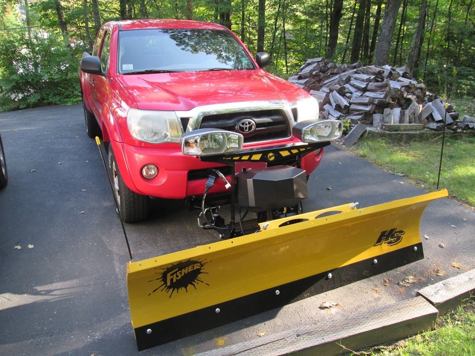

    My error in the last post, I have the Fisher HS, which is now all metal. Use to be plastic, which had me looking at the Myer's instead.
    However, when the dealer told me that they're now metal, I went with it.
    Here's the pic I posted earlier.
    21751527_2382422801983009_39541537419157_78b7a59a0a38a8024685c58cbceaa08ea7d38c09.jpg

    That looks much nicer than the Homesteader which I believe they still make or they just are still selling to get rid of them. Looks like they use the Homesteader style pushplates with the double pins to pull out for better ground clearance in summer.
    The rubberbands used as trip springs on the Homesteaders dry rotted and would leave you hanging if they broke... they were something like $100 each as well! There was a guy online that upgraded Homesteaders with trip springs and they were more consistent and stronger.... looks like Fisher heard the complaints and upgraded the HS to have springs as well. The specs look more like the older Fisher LD's with a 23" mold board vs the Homesteaders 21" mold board as well. It also looks like you can put an extension or a foil on top to extend your moldboard height. That can be REAL nice in light fluffy stuff that runs over the top!

    Rubber bands as trip springs ? Yeah I would've passed if they had that.
    The plow is all metal, including the springs. It also weighs about 50lbs more than the old HS. 297lb, where the old HS was 250lb.
