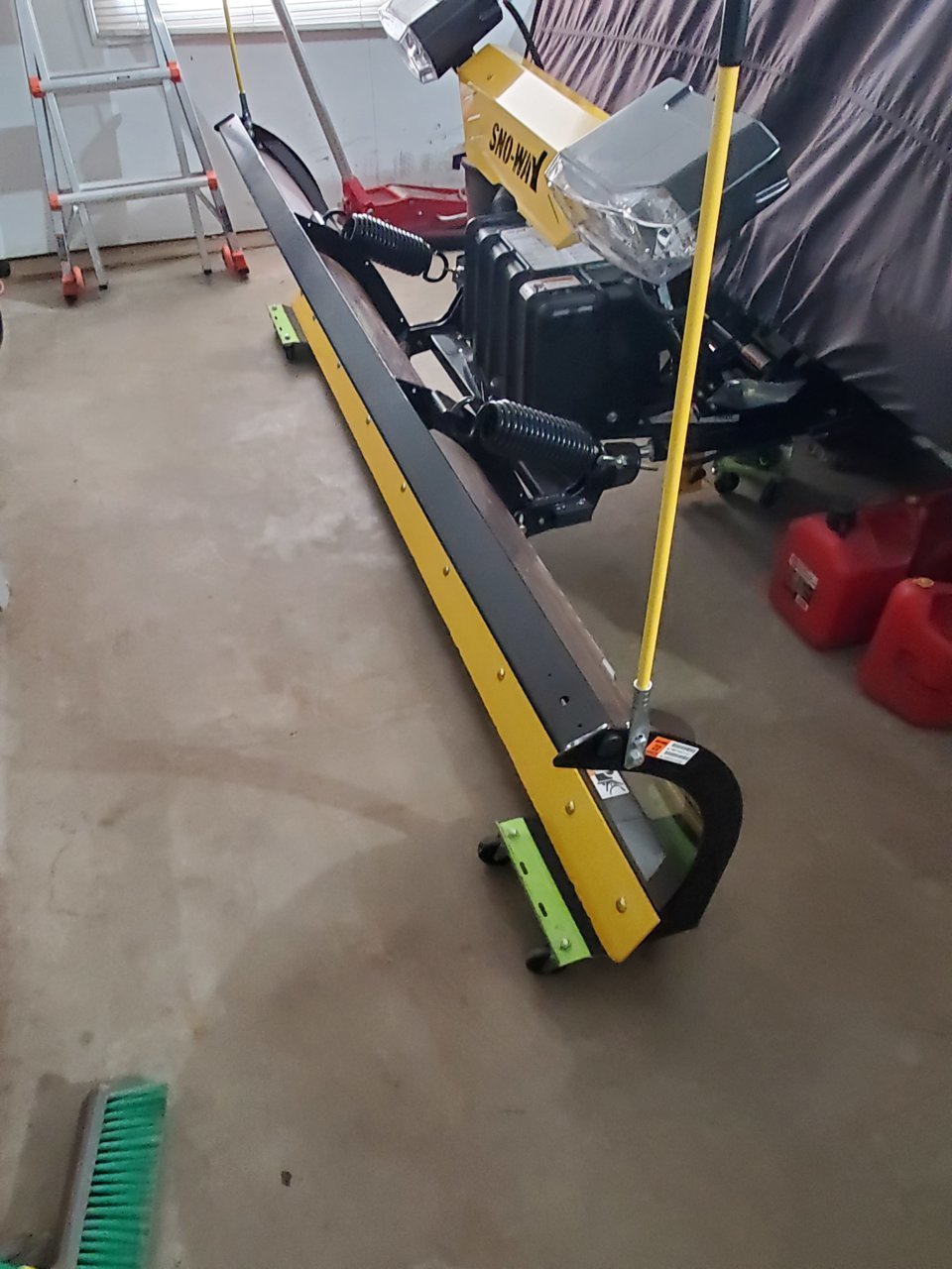

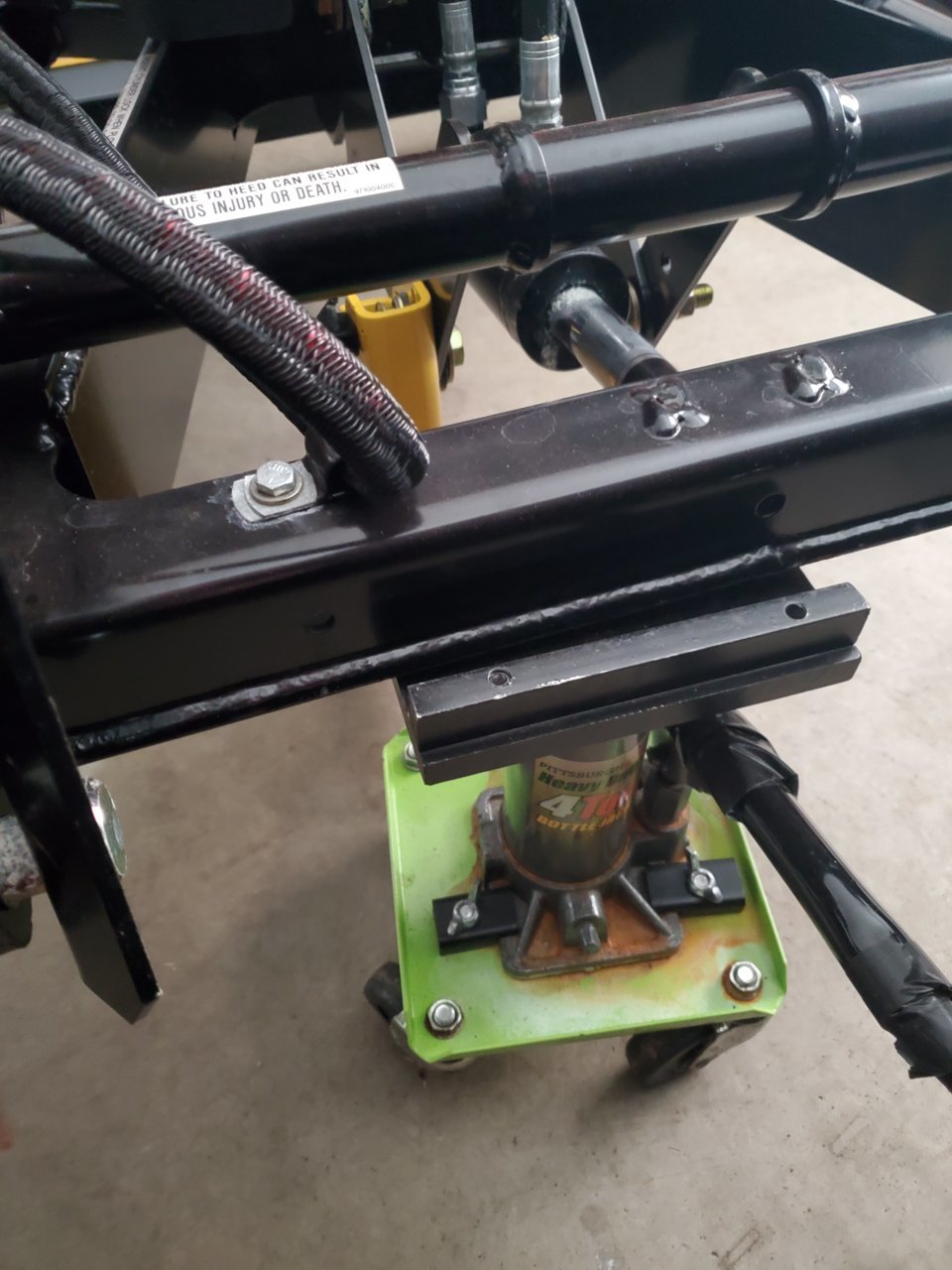

    I purchased snowmobile dollies for mine. The 2 ski dollies are v grooved for plow. The back flat I mounted the smallest Hf hyd jack. On the jack I created a square channel held on by screw on jack. This holds the back frame. Moves easy on and off.
    Hope it helps. Pics just ask
    Kastforce KF2014 from Amz

    Yeah I'd like to see how that works.
    Thanks in advance
    Jim

    Sure. It's a simple setup and keeps angle close to make on/off easier. -Matt

    Thanks !

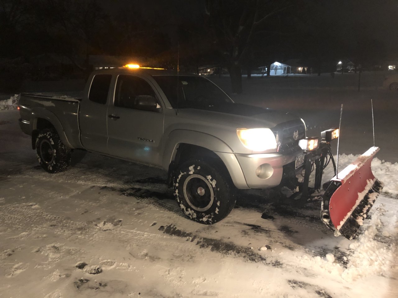

    I used to plow with a Jeep CJ5. If that can push snow I'm sure the Tacoma will. I put a 7'6 Boss on my 2021. Its a sweet set up.
