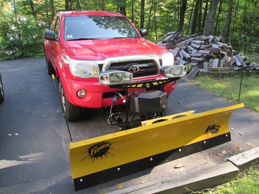

    21751527_2382422801983009_39541537419157_6ad3e074dc9eb9fb594a849127ba8453ac4d1920.jpg
    Well, less than I expected, $4225, installed and guaranteed.
    The Jon Deere Tractor I considered, $15,000.
    The only thing I backed off on, was trying to convince my wife to let me but a new truck with the plow already on it. :D
    Accidently deleted the pic at the url.
    Jim

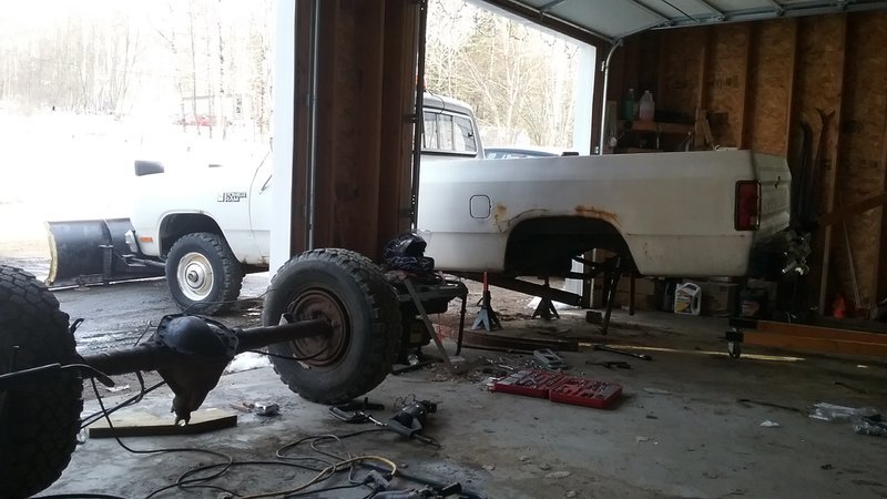

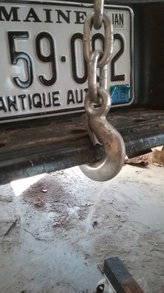

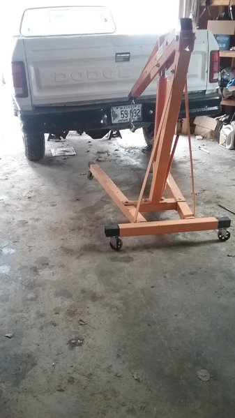

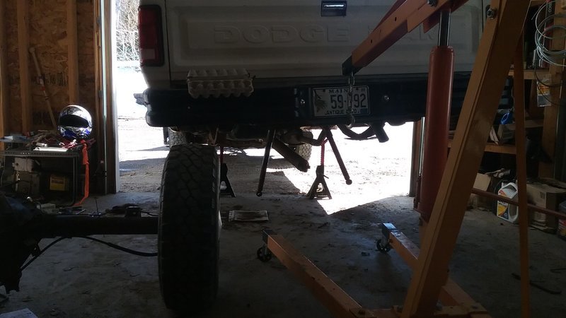

    So, I feel as though I should mention a caveat of owning an older plow truck instead of a more modern one...

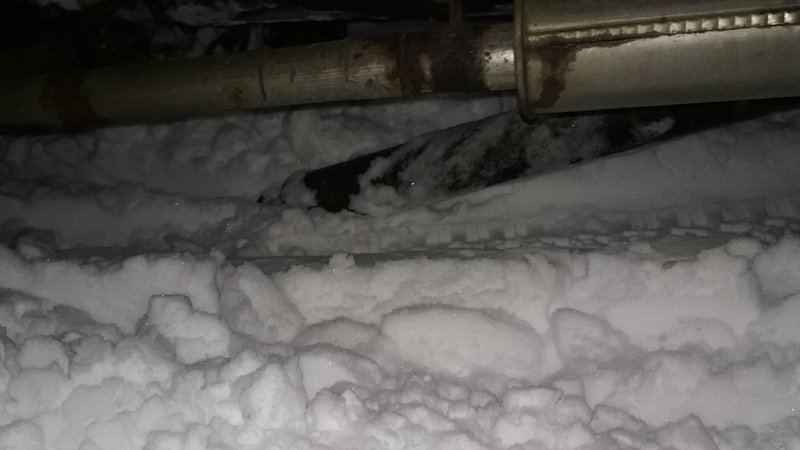

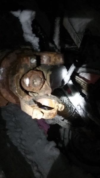

    This past spring I was pushing back snow banks after a fairly large storm that dropped 16-18 inches of wet, heavy snow and popped the straps on my rear universal joint. Turns out they popped because the spring perches had rusted badly enough that they collapsed under torque and the axle spun.
    BUT; even though this was a fairly in-depth repair, I was able to fix it completely for under $100 in parts and a weekend's worth of time (Saturday afternoon and Sunday morning).

    Stretched the U-bolts on the front side, and wrapped the axle about 20-25 degrees. :anonymous:
    Diff cover is supposed to be vertical.
    Thank god for real bumpers...
    So that's something to keep in mind with the older full-sized plow trucks; you can work them harder, but they're not invincible. The advantage is that they're less expensive to fix if you can do the work yourself.
