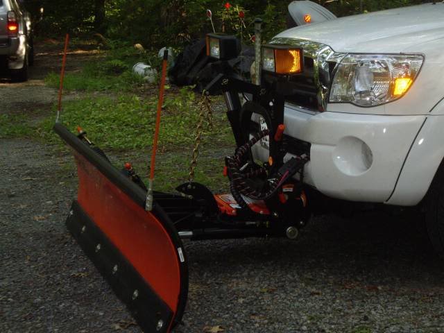

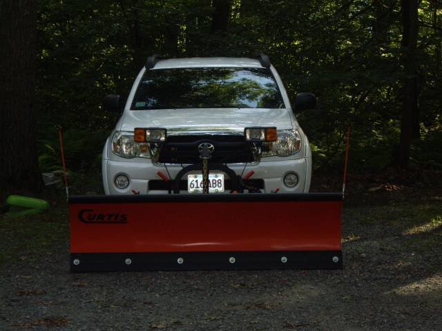

    I have a Curtis plow on my 2008
    Plow attached
    Side view
    That's everything right there!
    Pump etc all mounted in plow frame.

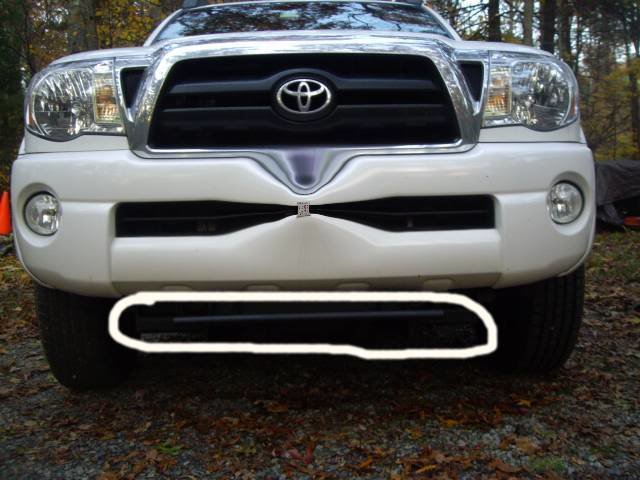

    Here is the frame with out the plow!
