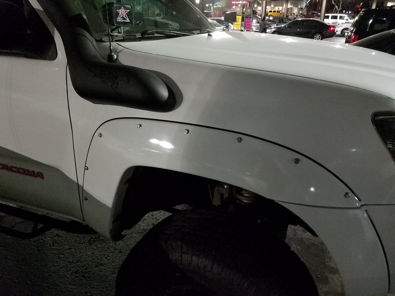

    I broke everyone of the damn little bastards...not alot you can do not to the way i see it. How did you go about bolting them on? I may go about this if it's not terrible hard and time consuming.

    Nope very simple. I used 1/4" x 1 1/2 " stainless hexadecimal bolts 2 stainless flat washers per bolt (1 on the outside and 1 on the inside of the fender) and 1/4 nylon insert lock nuts. Once the flare is removed you can see on the inside of the flare where the clips snap in. I drilled out those using a 1/4" drill bit in all the spot. Put the flare back on and bolt it down. Took all of about 35-45 min

    Here is a picture. Use stainless so it doesn't rust on you.
