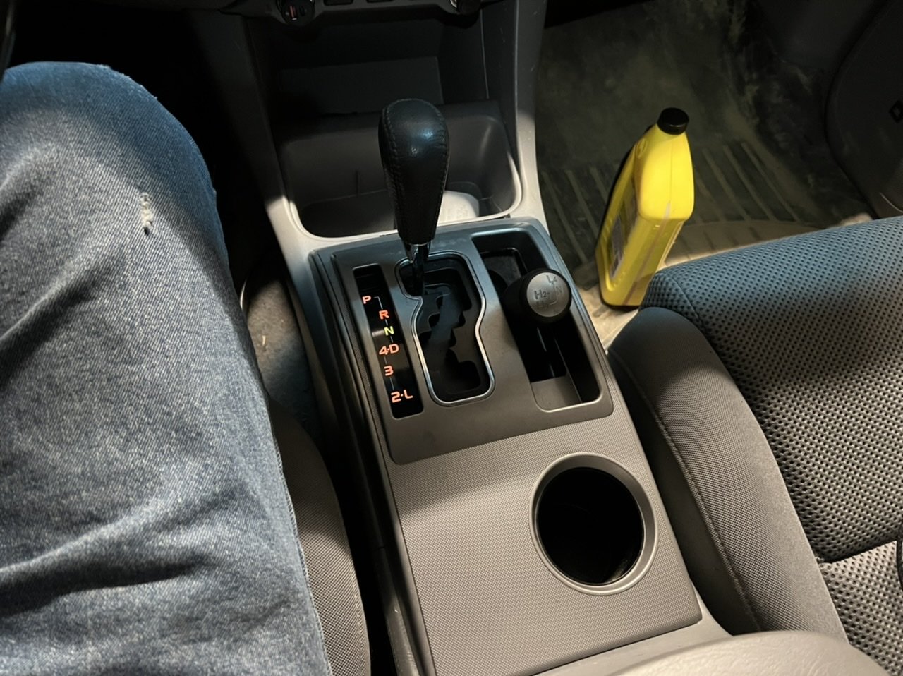

    First order of business was actually finishing the FJ case swap since it came with just the stick shifter and center console removed. Cut and rewelded the stock shifter to fit through the pen tray that I trimmed out. It’s located correctly but will need to be extended taller to shift nicer in the slot. The shift knob landing in the slot keeps it from shifting super easy. I had to cut the right front leg off the trans shifter base to get everything to play nicely too. Everything wanted to occupy the same space with the shift boot on.

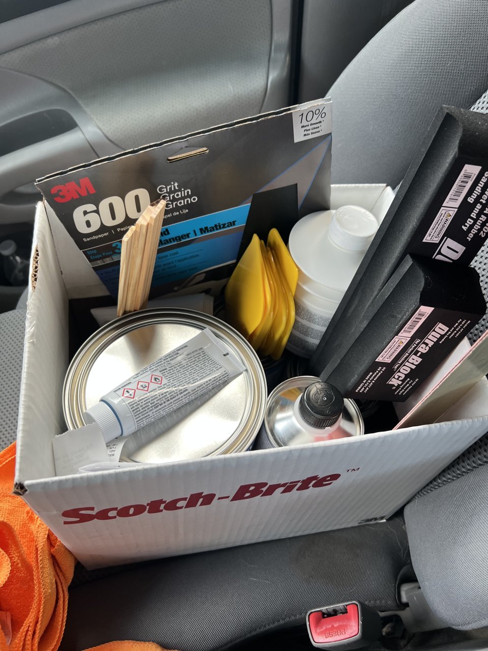

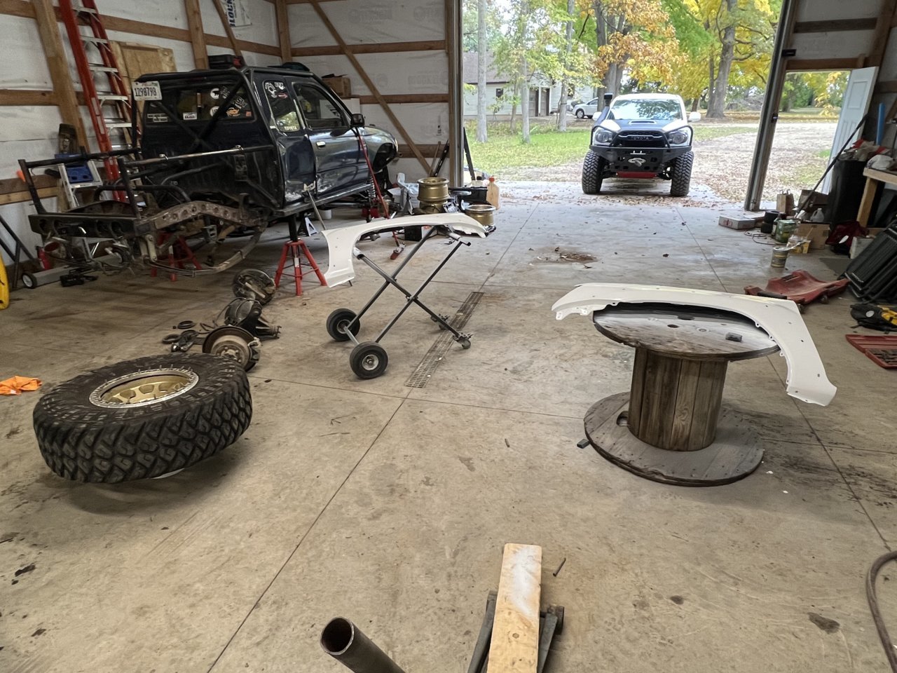

    Made a trip to my local auto body supply to pick up some fixins for this pig. One fender showed up today, passenger should be here tomorrow. Going to ditch the snorkel, get the new ones gunned and installed, then start to work on churching up the doors. $200 in paint and $200 in fenders should make a huge difference

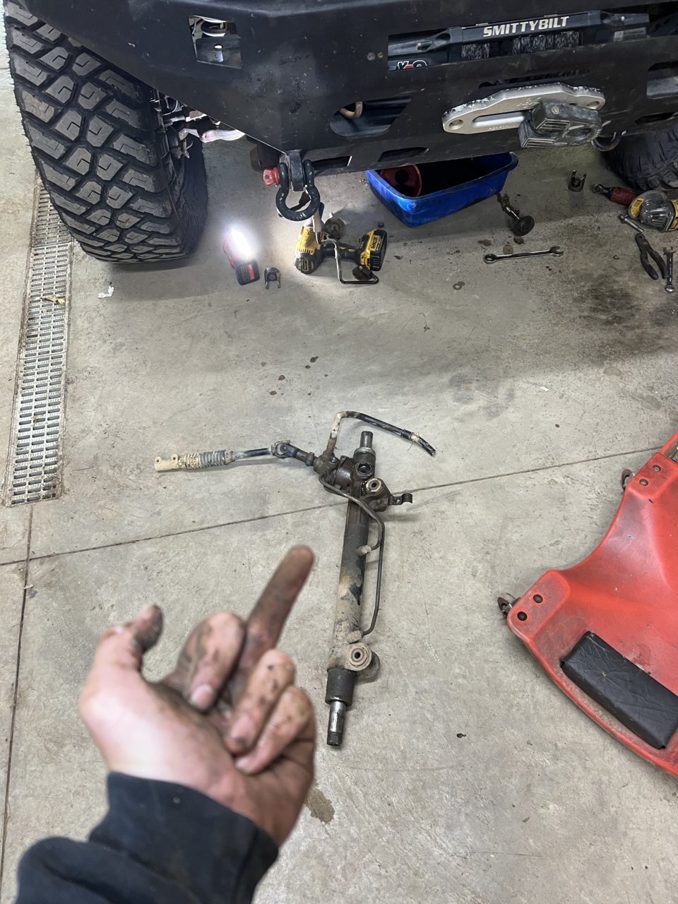

    Goddamn do I hate how little room there is under the front of an IFS truck. 20 minute full on WWE wrestling match to get this bitch out

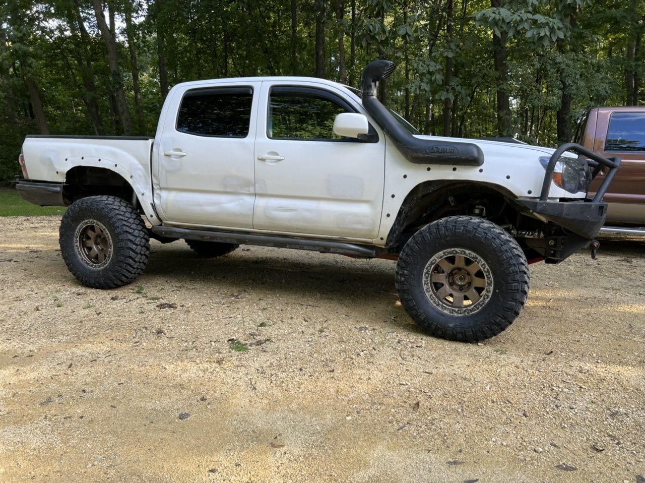

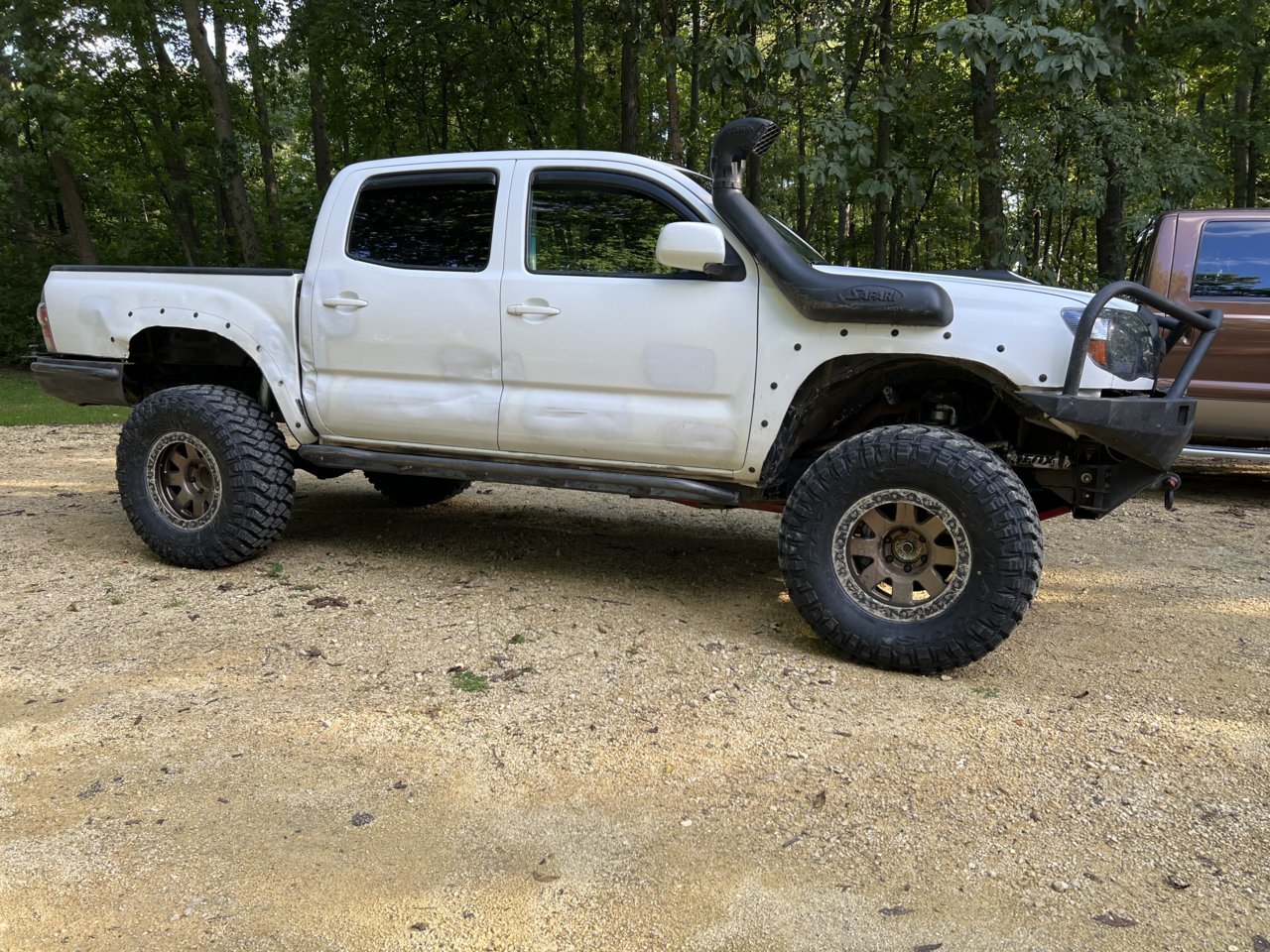

    The dorkel is gone forever and can’t hurt anyone else now

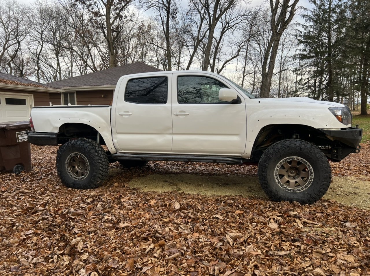

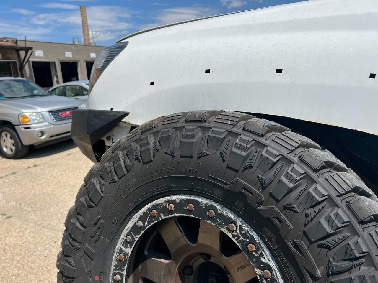

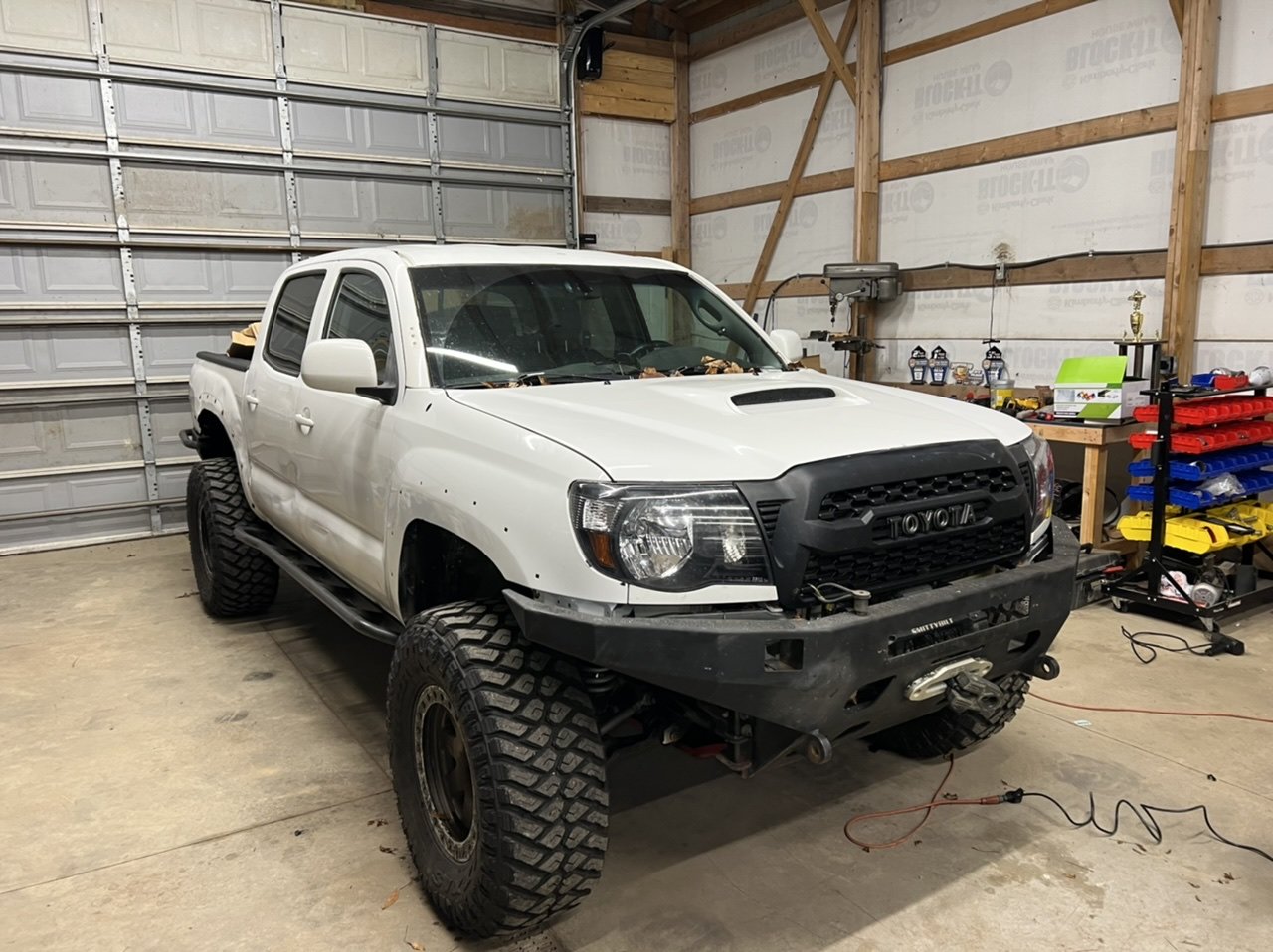

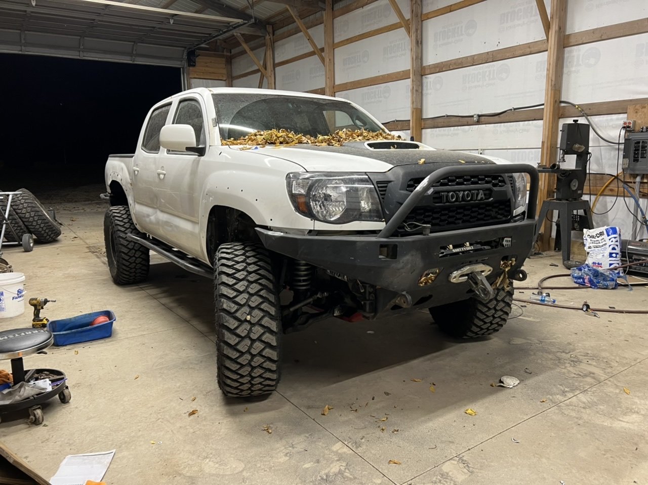

    Trimmed the fenders to fit 35’s and broke out the sawzall on the bumper.
    Got to here…still didn’t like it
    Ended here and really like it

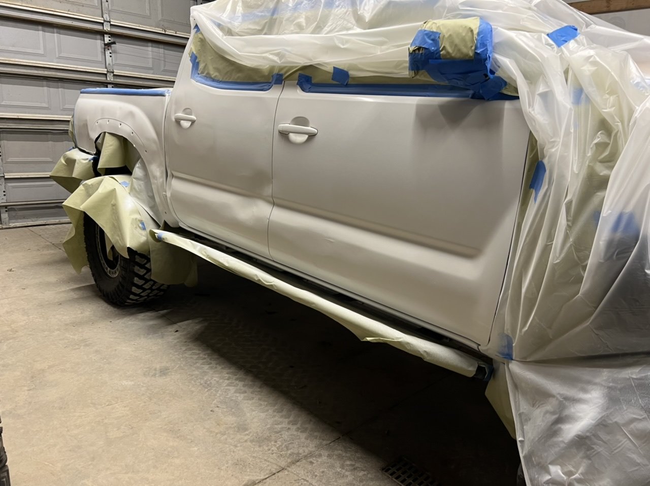

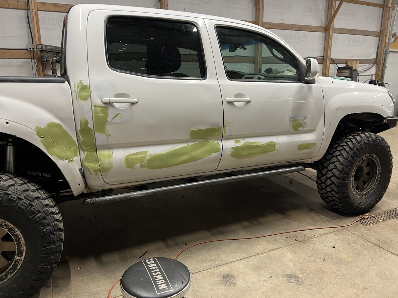

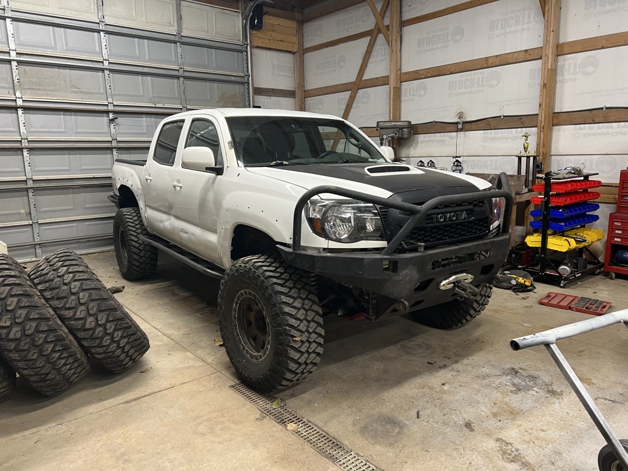

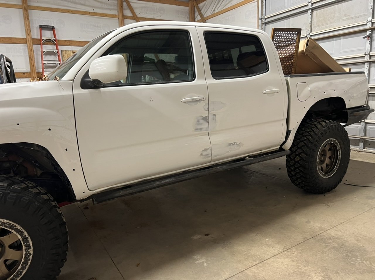

    Started in on paint/bodywork correction today.
    I thought I’d just start with a good cutting to see what was under a bunch of chalky finish on the existing paint. Got one side done and I was pleasantly surprised how much the paint came back around. I’ll still be respraying the spots in the doors but I’ve got a good idea on how I’ll blend it now.
    Then I started to poke at the hood when I remembered that the previous owner only wrapped the black section, not painted it. So I broke out the heat gun, pulled the wrap off and gave it a good cut. It came right around great and looks way better. Hopefully the glare isn’t as bad off the hood scoop as claimed

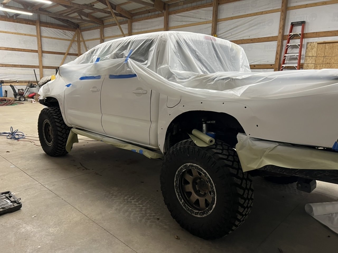

    No turning back now. Goal is to get the filler/prep work done tomorrow so I can lay paint Wednesday/Thursday while it’s still warm out. Not shooting for perfection but at least going to knock some edges off and get the whole truck one color

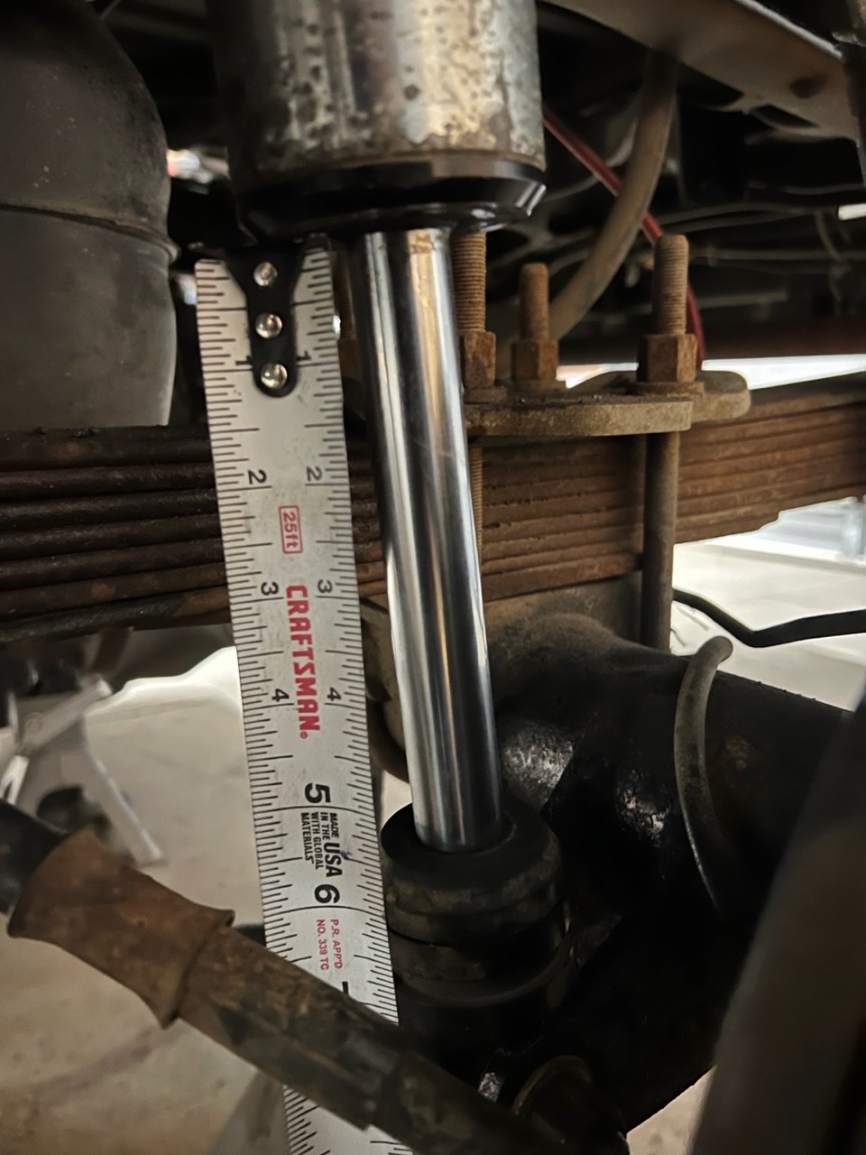

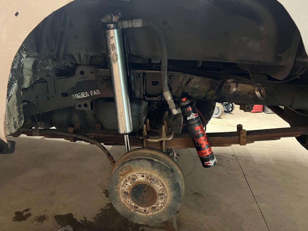

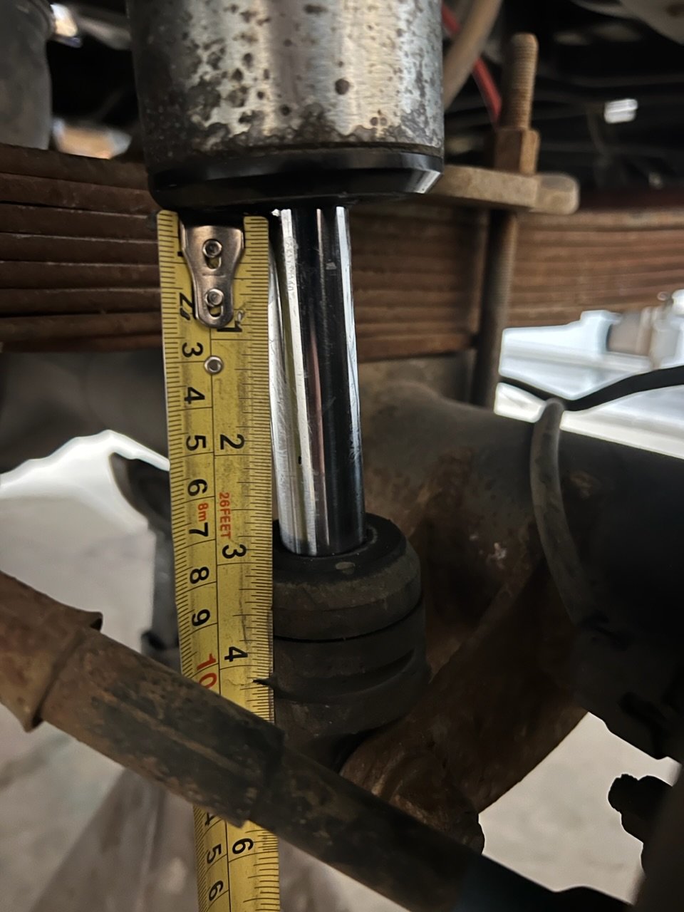

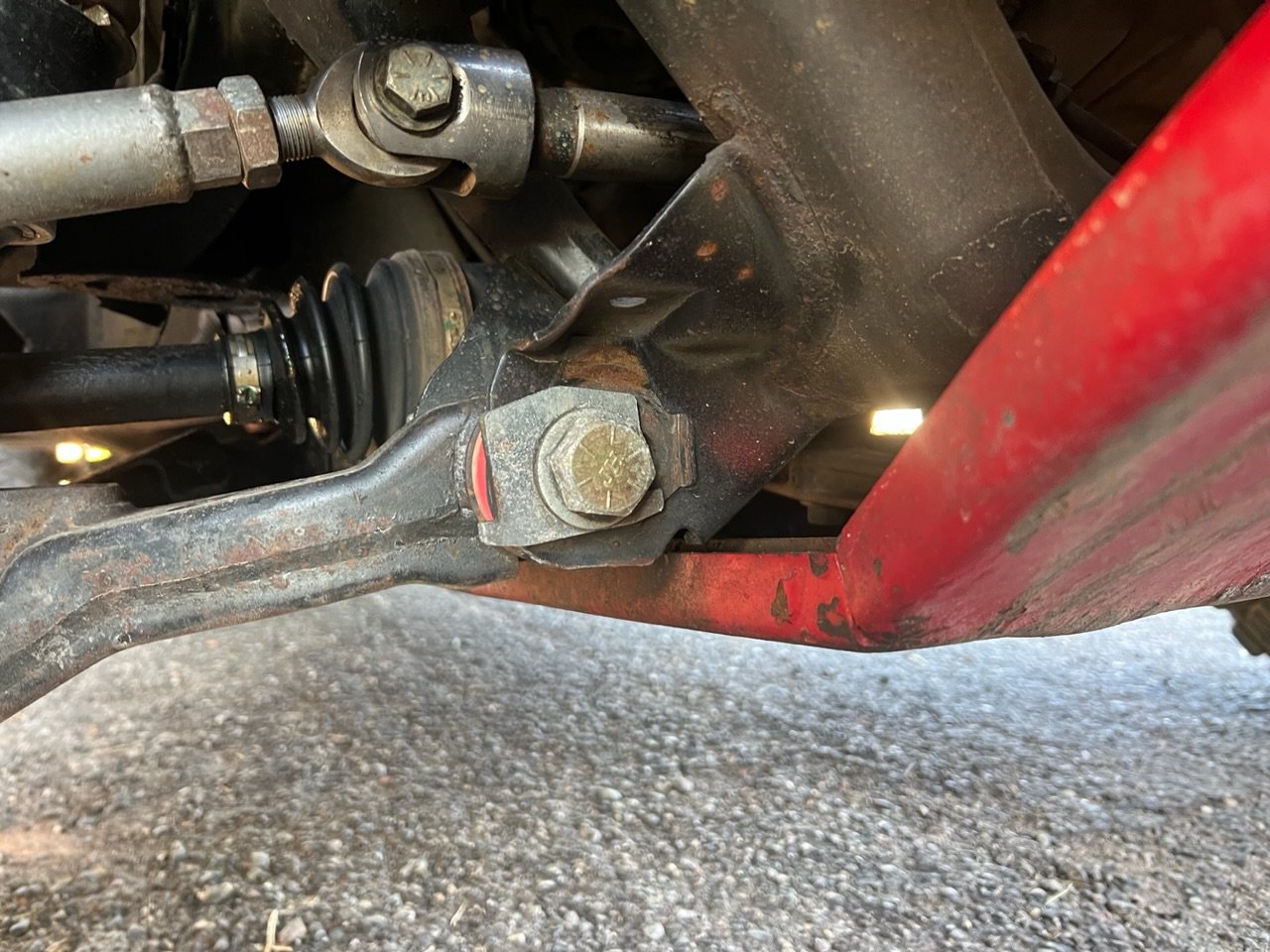

    Getting ready for Moab in a couple weeks so I hit the punch list
    -Took the body lift out. I hate body lifts
    -Corrected camber for the new ride height since I lowered it
    -Set toe
    -Rotated tires
    -Rebuilt the upper shock mounts on the rear. Went from 3.5” of bump travel to 5.5”. Will be so much better when I have a little gear with out west
    Still need to grease everything, install a GMRS radio, and steering wheel controls would be a nice bonus to get working on the head unit for the long trip. Then just start packing gear!

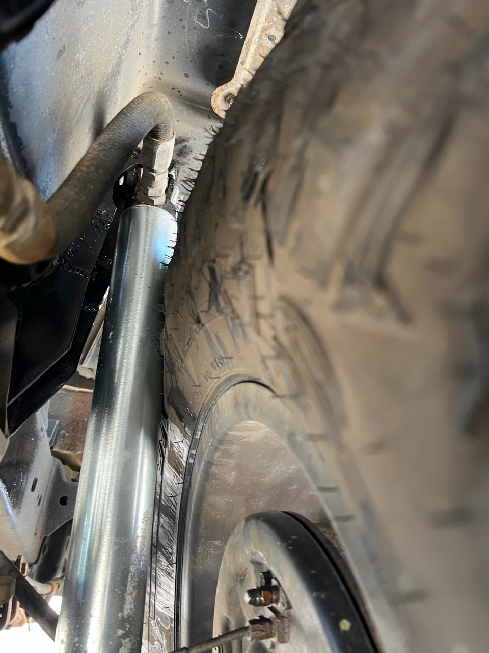

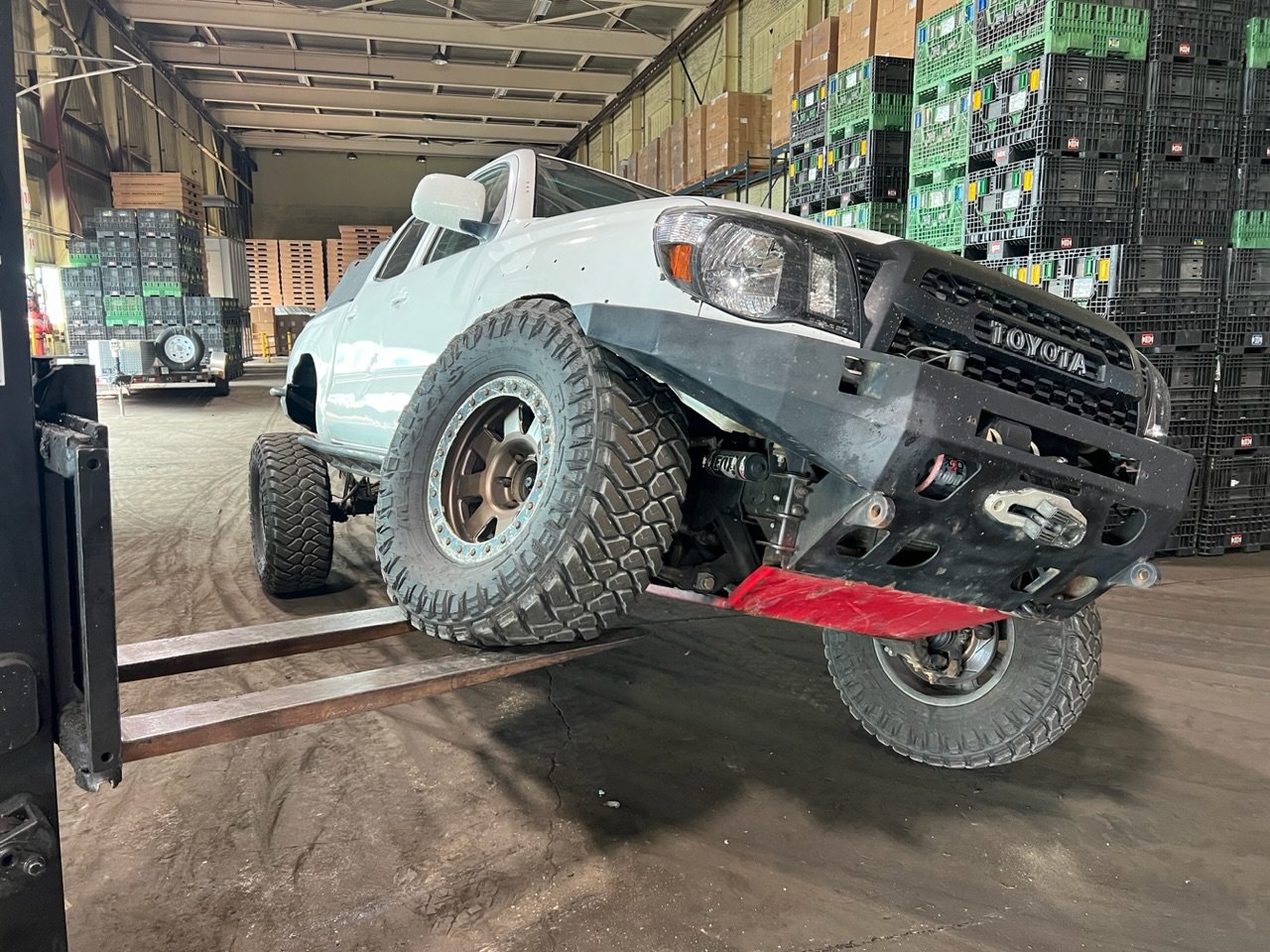

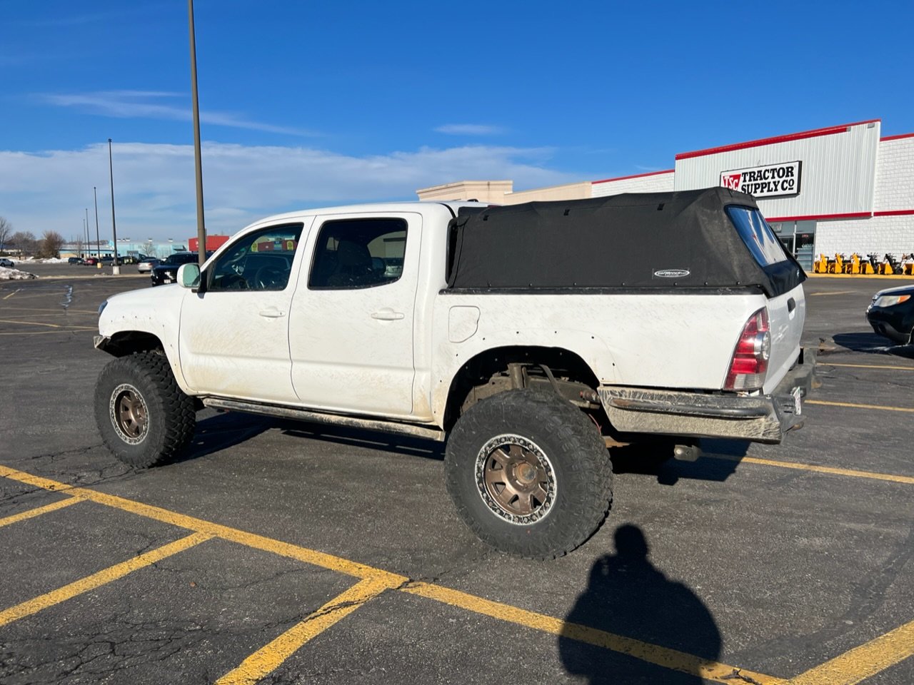

    Used the forklift at work to check clearance on 35’s. They really don’t fit but I kept cutting and added a spacer in back to clear the shocks. Of course I did this the day before we left on a week and a half trip out west
    Made a pit stop in Colorado and out in Moab for the week with friends. Hung out in Ouray and ran to Yankee Boy and Engineer/Cinnamon. Love the passes and exploring the towns

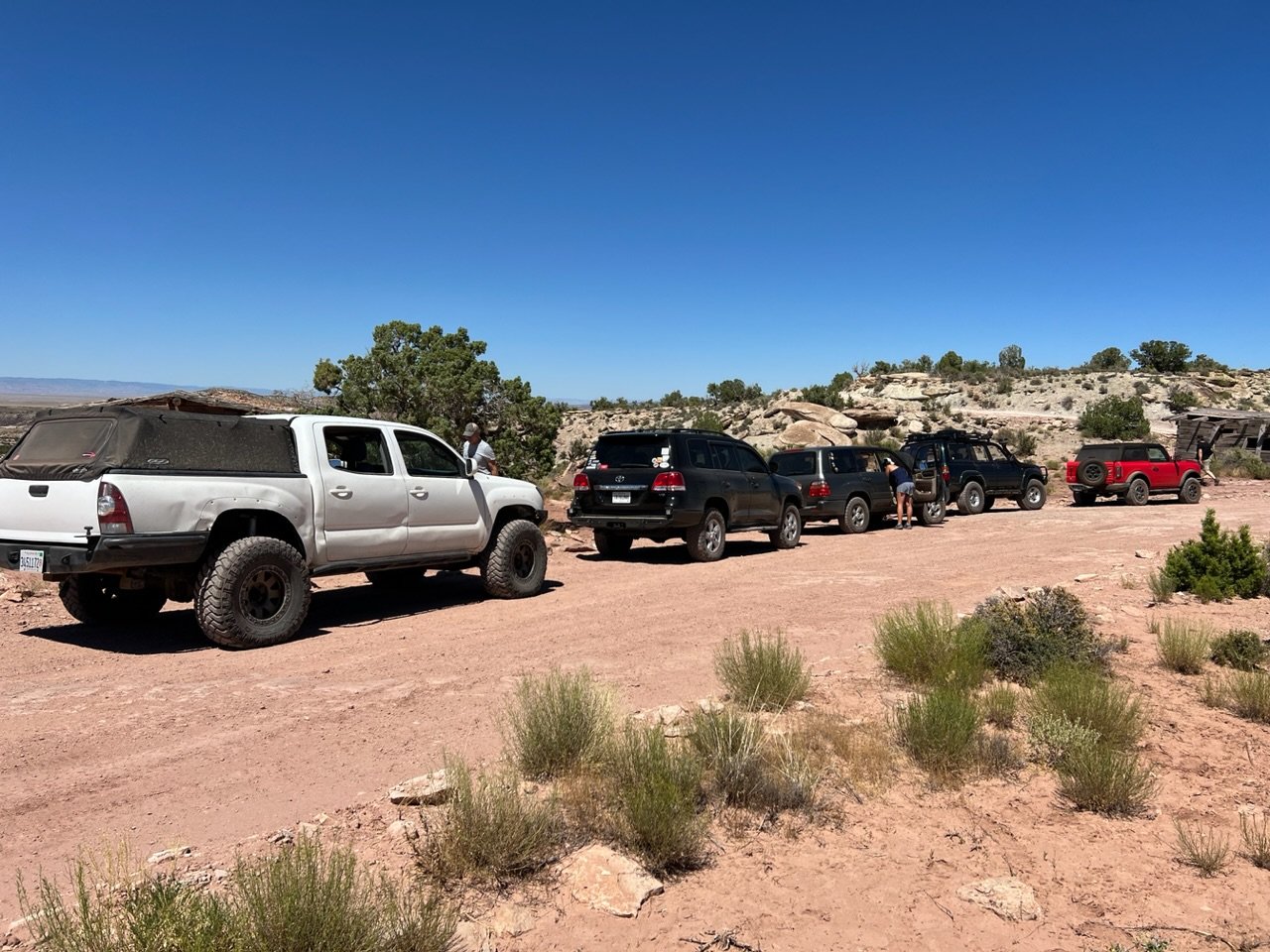

    We hopped over to Moab where we rented a house with 8 other friends for the week. Fun group and days of wheeling our daily drivers instead of hardcore crawlers like usual

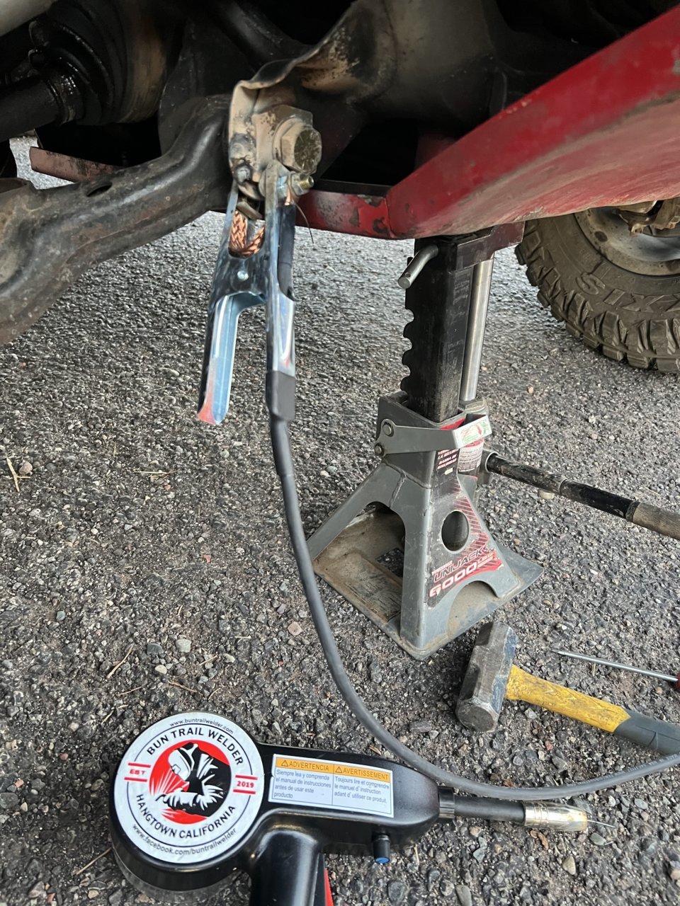

    Flattened a cam tab but the Bun welder saved the day with an easy fix at the house
    Found some cold water less than 19 minutes from our house too!
