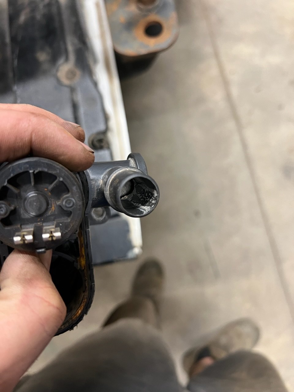

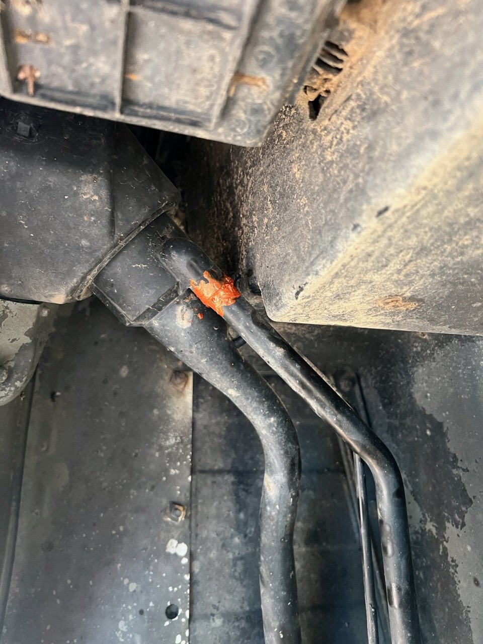

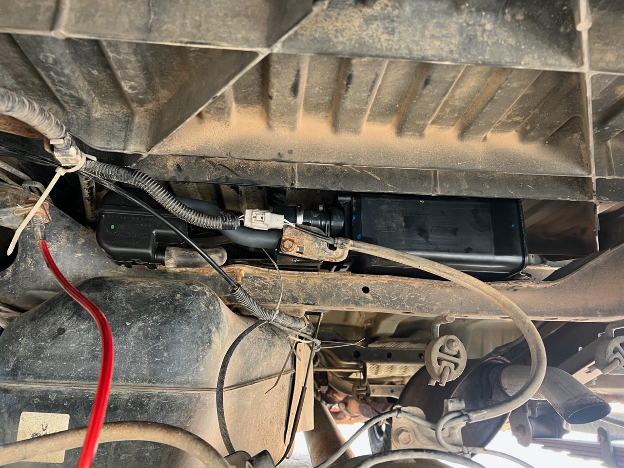

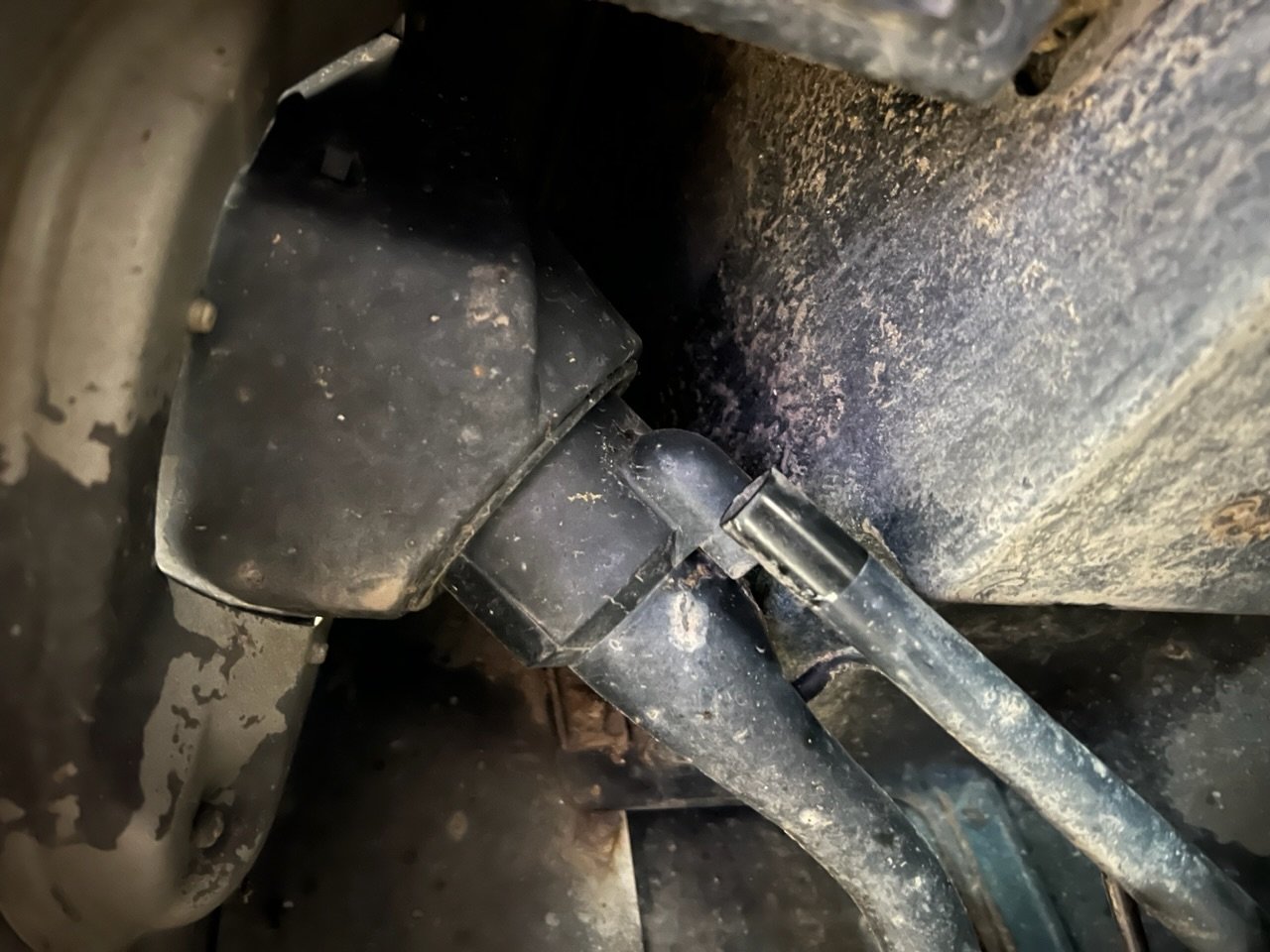

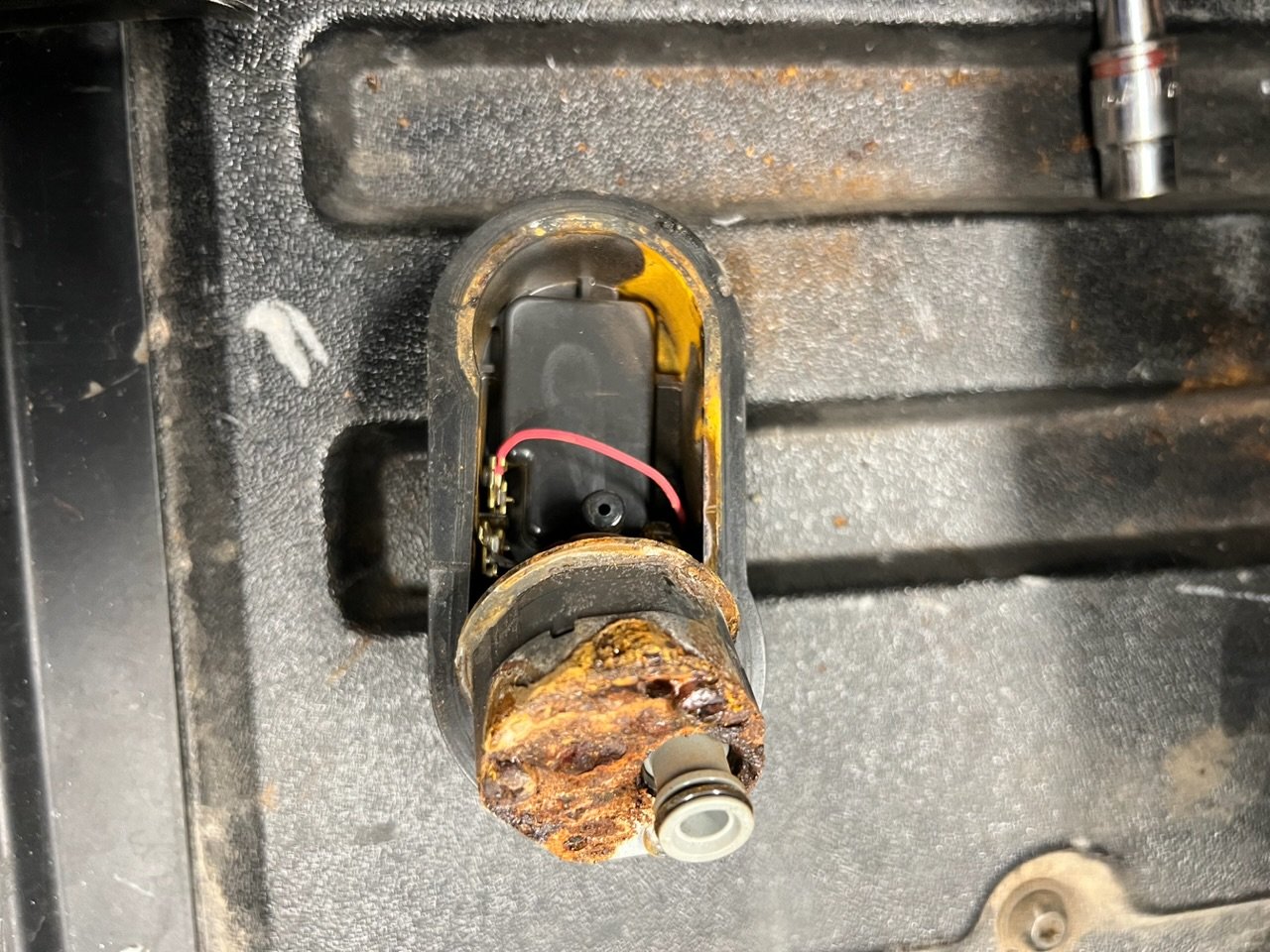

    CEL is on for evap canister codes again. Tore things apart and found evidence of salt water in the vacuum motor. Junk in 6 months. Obviously some sort of issue in the vent system allowing debris in. Blew on the vent and found the source of my issues I believe, loose pipe fitting at the fill neck getting blasted by water from the tire. I imagine it got jostled loose with the old body lift. PO had the issue for quite some time repeatedly too.
    Replaced the fuel cap, canister filter and canister itself. Sealed up the vent tube at the fill neck as well. Fingers crossed I’ve got this issue resolved. Parts are annoyingly expensive.

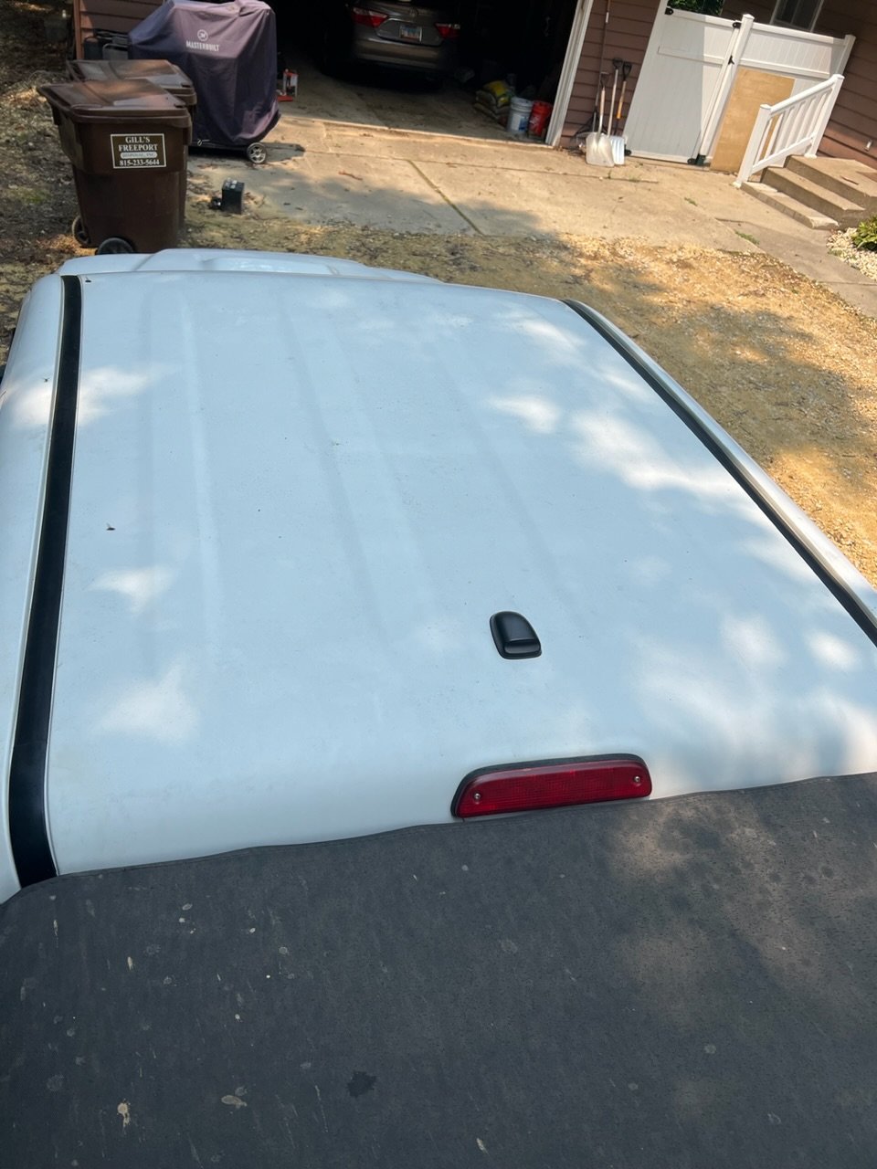

    Replaced the chopped up drip rail striping with fresh OEM stripping

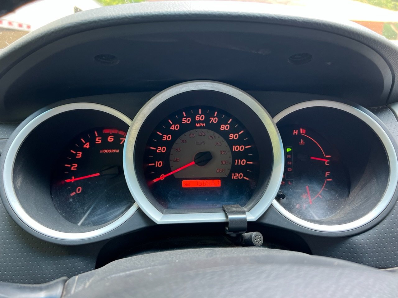

    Put out the TPMS light, finally. I attempted pulling the connector out of the TPMS module in the headliner but the light just flashed once and stayed on. So I jumped power to the TPMS light in the harness behind the glovebox and put the bastard out for good.
    Feels super nice to have zero lights on the dash for the first time as long as I’ve owned the truck. Hit 130k on the way back home so I’m right at 13k miles out on it in the first 10 months of ownership
